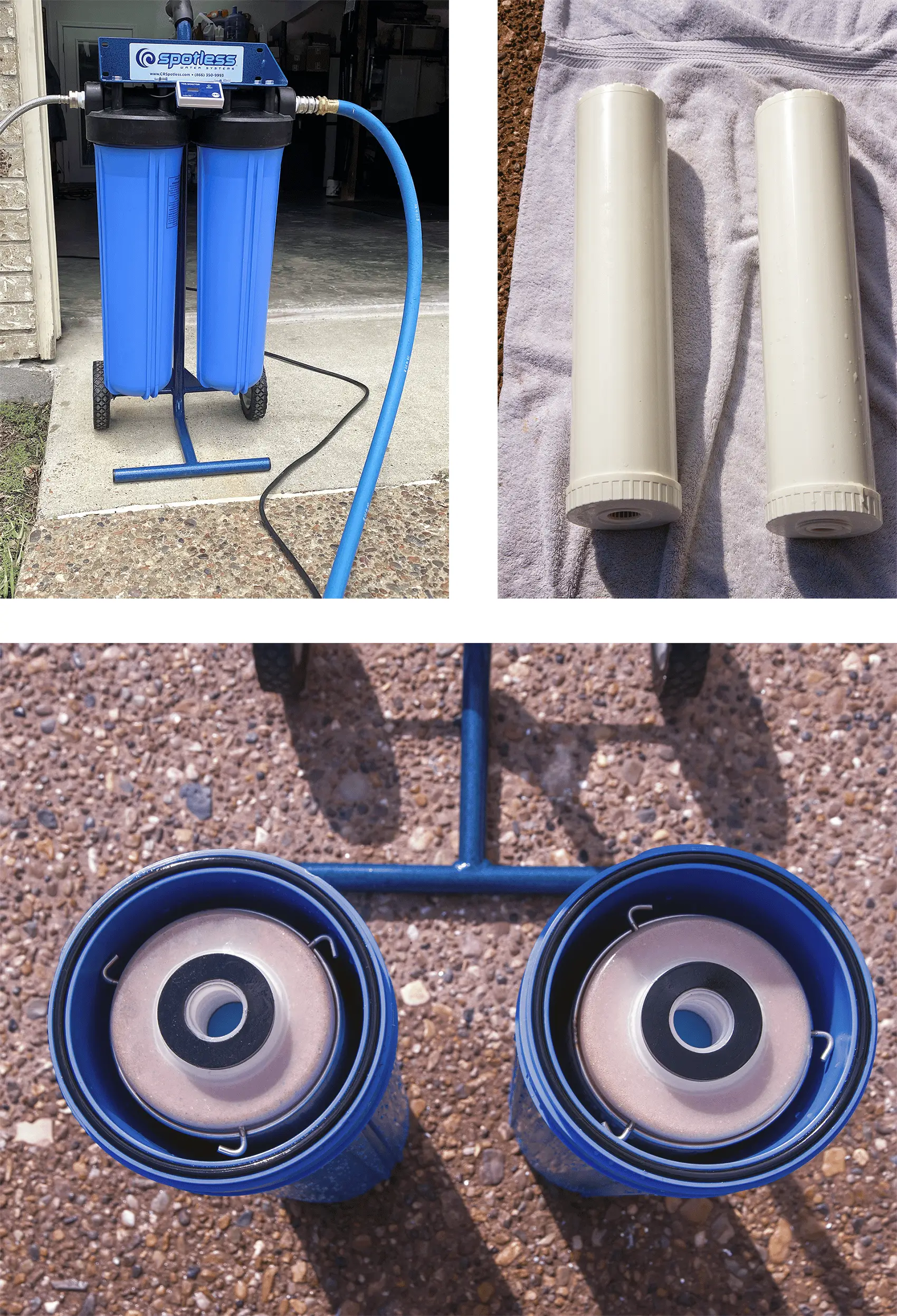

..and I say that without knowing how long it will last.
For your sake, I hope so, Tony but based on the softener tube you posted, don't be surprised if you get less time than you think.
Tony: Definitely get a water tester or at least test strips so you can determine just how much of the mineral content is removed when the cartridge is new. Test the unsoftened house water first, then test the output after the filter and compare. (The hardware testers are more accurate than strips.)
Once you know the the number for the output, you can compare the original number with what you get during the checks, (I would check it every six washes or so,) and after a couple of these tests, you'll have a good idea as to how long it will last before needing replaced.
FWIW, I get about a year from the CR-Spotless double Big Blue tubes and CR's cartridges (based on average two washes per month.) Here are a couple three shots of my rig so you can see the difference in size and hence capacity.
This system knocks my hardness down by, on average, about 200-300ppm softer than the softened house water.
Happy to hear you're tickled with the reduction in water spotting. Good luck AND, have fun!
