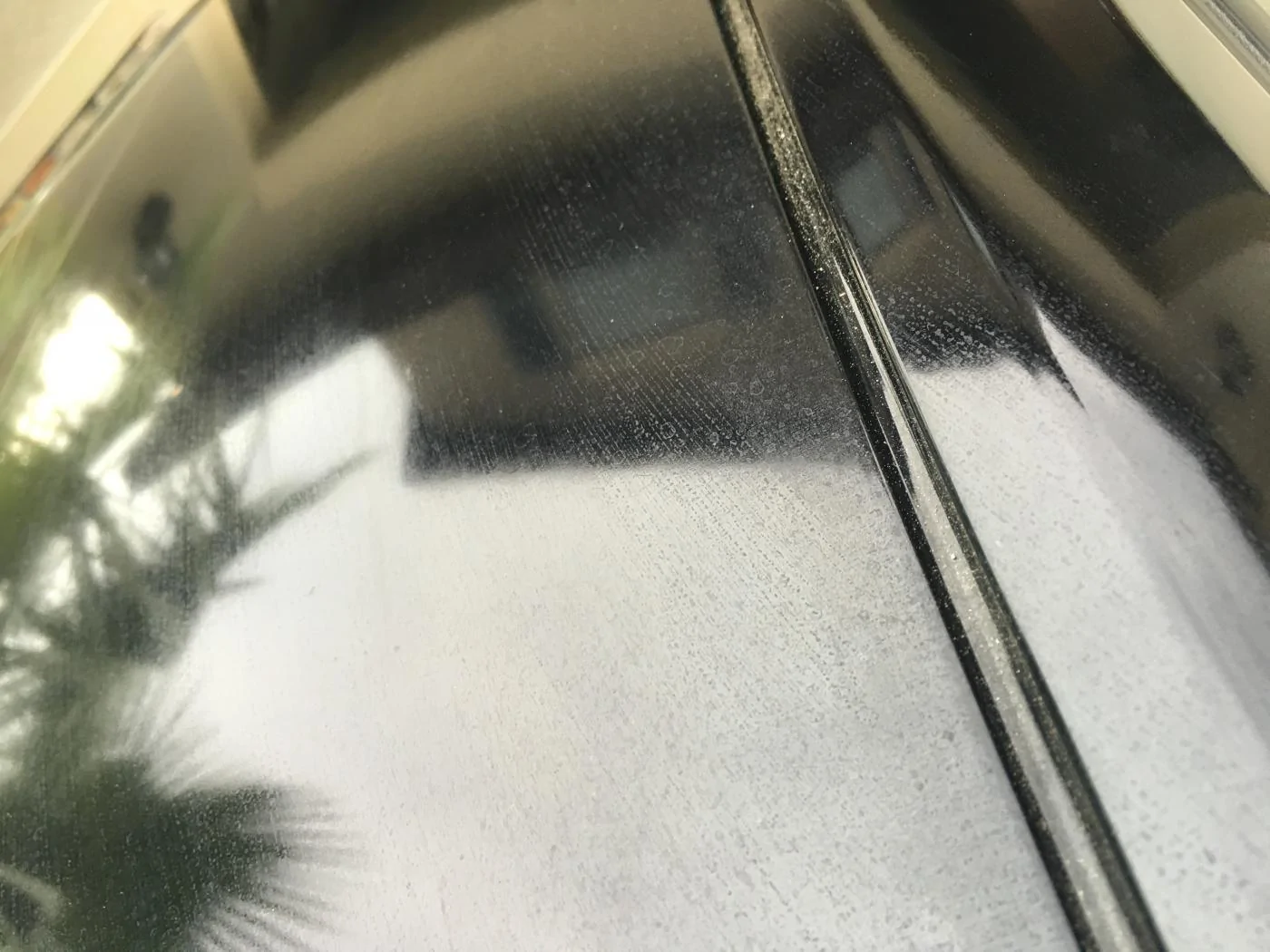

Is there any any visible scratch lines or is it all just random haze?
amotorsports
amotorsports
Mar 9, 2016
TAMPA,FL
2015 PROCHARGED BLACK GT PREMIUIM
Def visible looks like wiped care with dirty rag the whole left side. It's in the clear....

if the dealership "detailed" the car with dirty shop rags, then you would think the whole car would be hazed. Maybe a bird pooped there, and someone "cleaned" it with a scotch brite? :shrug:

First one..terrible

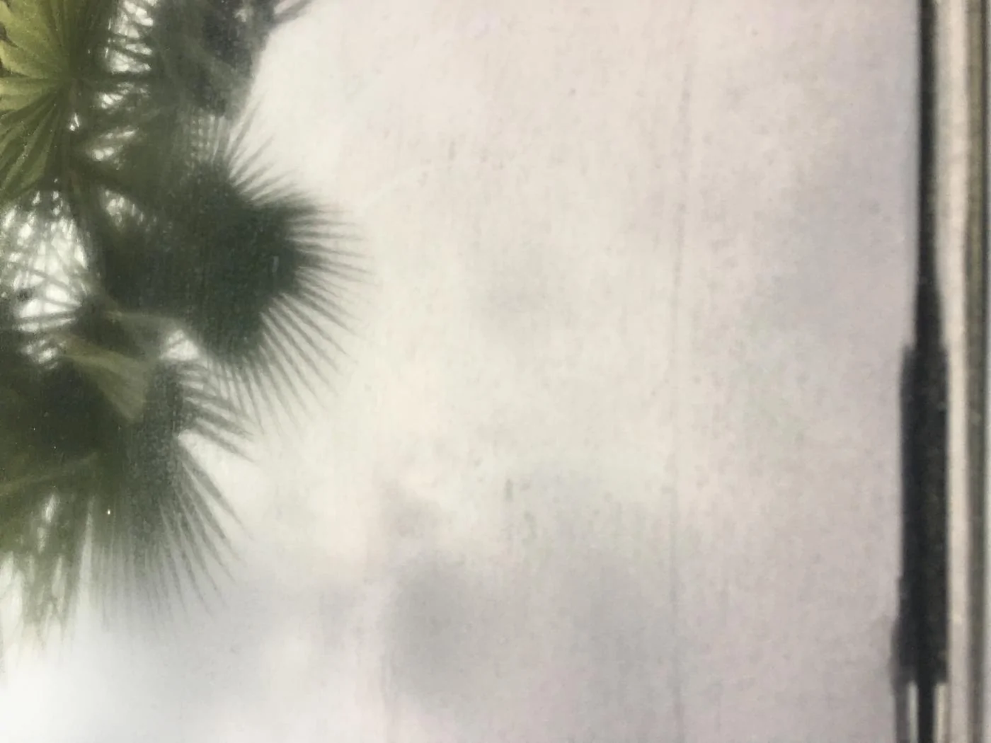

Second

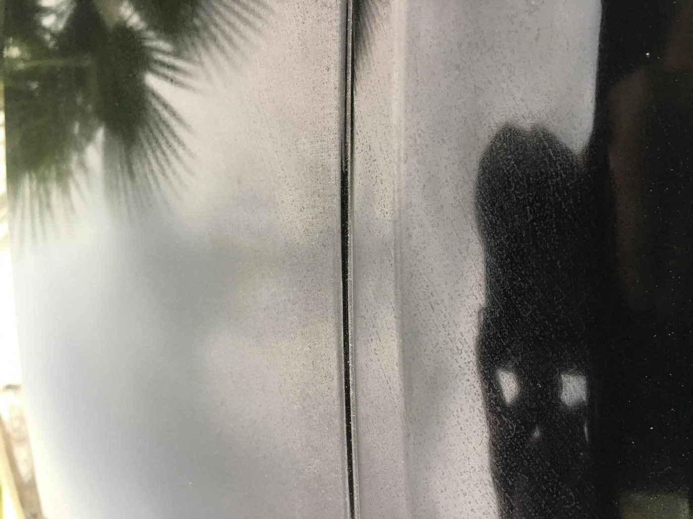

Finally the ugly truth... Grrrrr

Looks like heavy water spotting honestly.
Paint correction should fix it, or polishing it yourself if you're comfortable doing the work.
And once the paint is fixed, when you wash, you'll want to make drying the car a priority. Or just skip the 2 bucket wash, and do a rinseless wash. Especially since you're in Florida.

whole side of the car is like this? I thought it was just a large spot on the rear quarter panel. Other side of the car is perfect paint ?
When did you buy the car? It looks like it got wet and then air dried in the summer sun. More than once. I am assuming it didn't come like that from the dealership as it would have been obvious.
