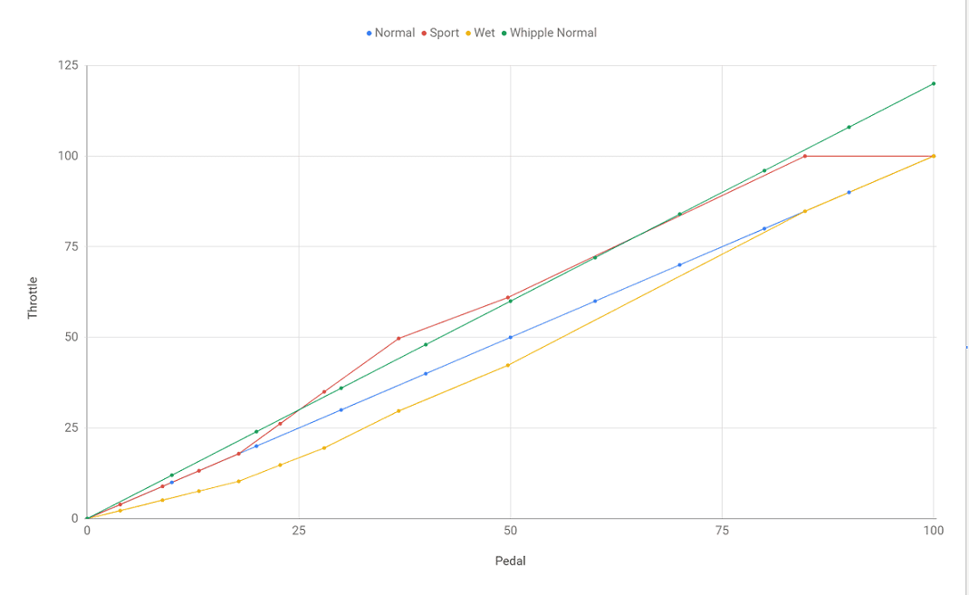

I have a 2018 PPL2 manual stage 1 Whipple I get about 12-13 just driving “normal” can get as little as 6-8 with “hold-on” driving. I usually drive in sport mode. If I switch to “wet mode” on the freeway @ 75-80 normal driving I get 27+ mpg. I’m not sure what wet mode would have done before Whipple, I didn’t use it.
Probably very little change when NA.
It’s likely that wet mode slows the throttle so much that boost rarely occurs, making it drive a lot more like an NA car.

Wet mode makes the throttle sluggish on the low end. I feel like it also makes the traction control more sensitive, and the sport mode allows a little more wheel spin.
At least on my 2016 stage 2 tune, Whipple's "normal" is basically the same as sport mode. Here's a graph from HPTuners data because I'm a nerd:

That’s right on wet mode power is cut, but if your just cruising down the fwy. Why not turn it on to save some gas $$. That money can be better spent for more mods.

While cruising, wet vs normal will not make a difference.
Just where your foot is holding the pedal in relation to the floor. It can be slightly beneficial if you don't have fine motor skills on your ankles.
