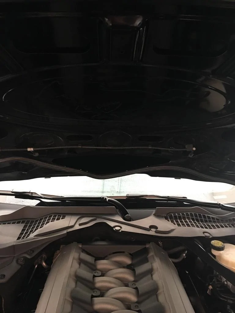

Does anybody have one that I can go off of or know where I can get one
I've never seen a template but Here's a pic of how I cut mine.
Pull the hood liner and it becomes more apparent what you need to cut. I used the weather strip as a cutting guide line and just free handed it and ground and sanded until it was no longer sharp.

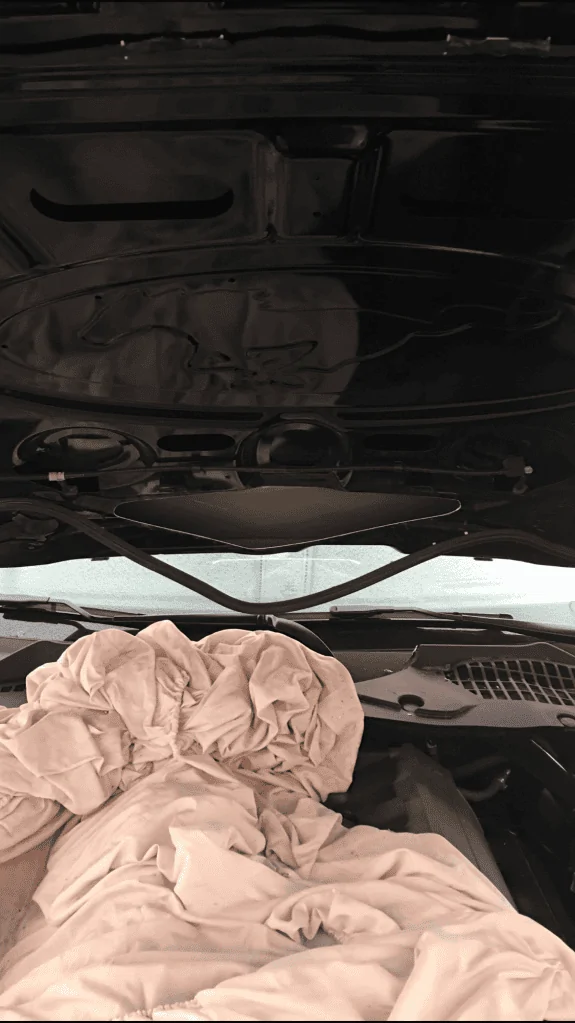

Nice thanks. Would it be possible when you get a second to take a photo with more light to show that area much better?
Yes if the sun would ever come out lol. It was in my garage and being a black car it's hard to see the hole.
