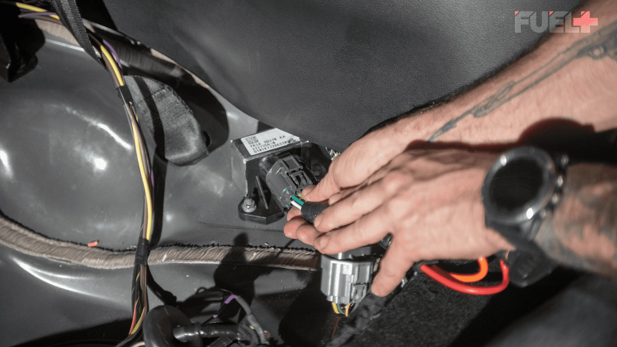

Yes there will be fuel in the lines. The best thing to do is lift up the back seat and unplug the FPDM connector (drivers side, right next to the wheel well) , then start the engine a couple of times to relieve any fuel pressure in the lines. It will still spill some but wont be pressurized. Also, the line leading back to the tank should be elevated as much as possible after disconnecting it, or it can create a syphon and pull the fuel out of the tank.
