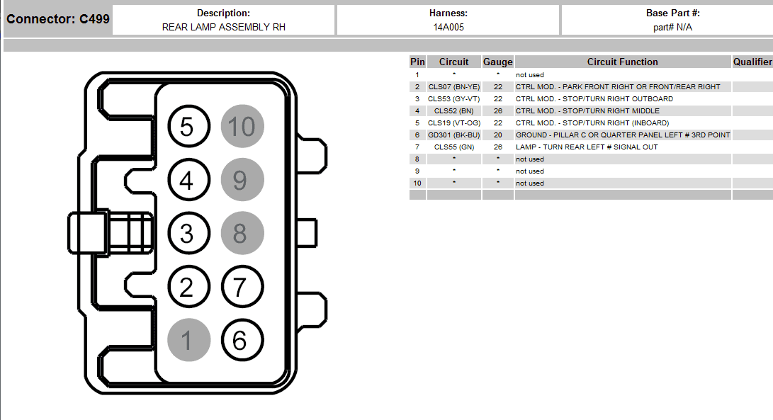

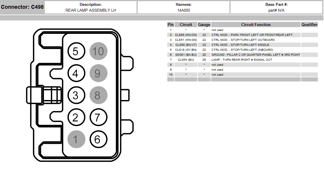

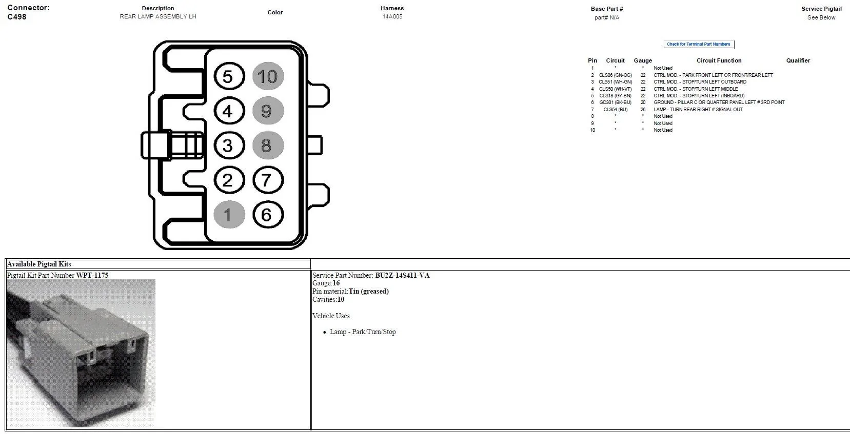

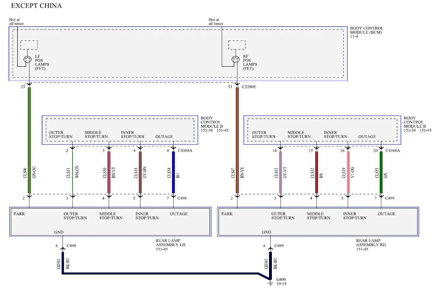

If I'm reading these diagrams from other posts correctly you should have voltage between pins 2 and 6 with the headlights on. Pin 3 is the bright for the outside, pin 4 for the middle, and pin 5 for the inner.

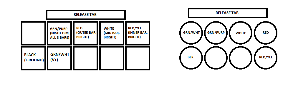

I didn't want to mess with pulling stuff apart again, so I just made this diagram. This is the way both plugs should look for a 2018-19 tail light to work properly.
So to make everything very clear: If using the 13-14 harness I linked above, the 5x2 plug is already set up correctly, with the addition of a 7th, blue wire that is unnecessary (I am not sure if it could be left untouched as I ended up removing mine before getting this harness to work). The 4x2 plug requires all wires to be moved 180 degrees (this means that the black wire was actually in the red spot originally, the grn/wht was in the red/yel spot originally, etc.). The only exception to the 180 degree rotation is that the solid red and the red/yellow wires must be swapped. But obviously no need to worry about that as anyone now can follow the diagram above which is correct. (If you do get it wrong, your turn signal sequencing will be opposite, i.e. it will sequence from the outside in. In which case just flip the solid red and red/yel wires.)
