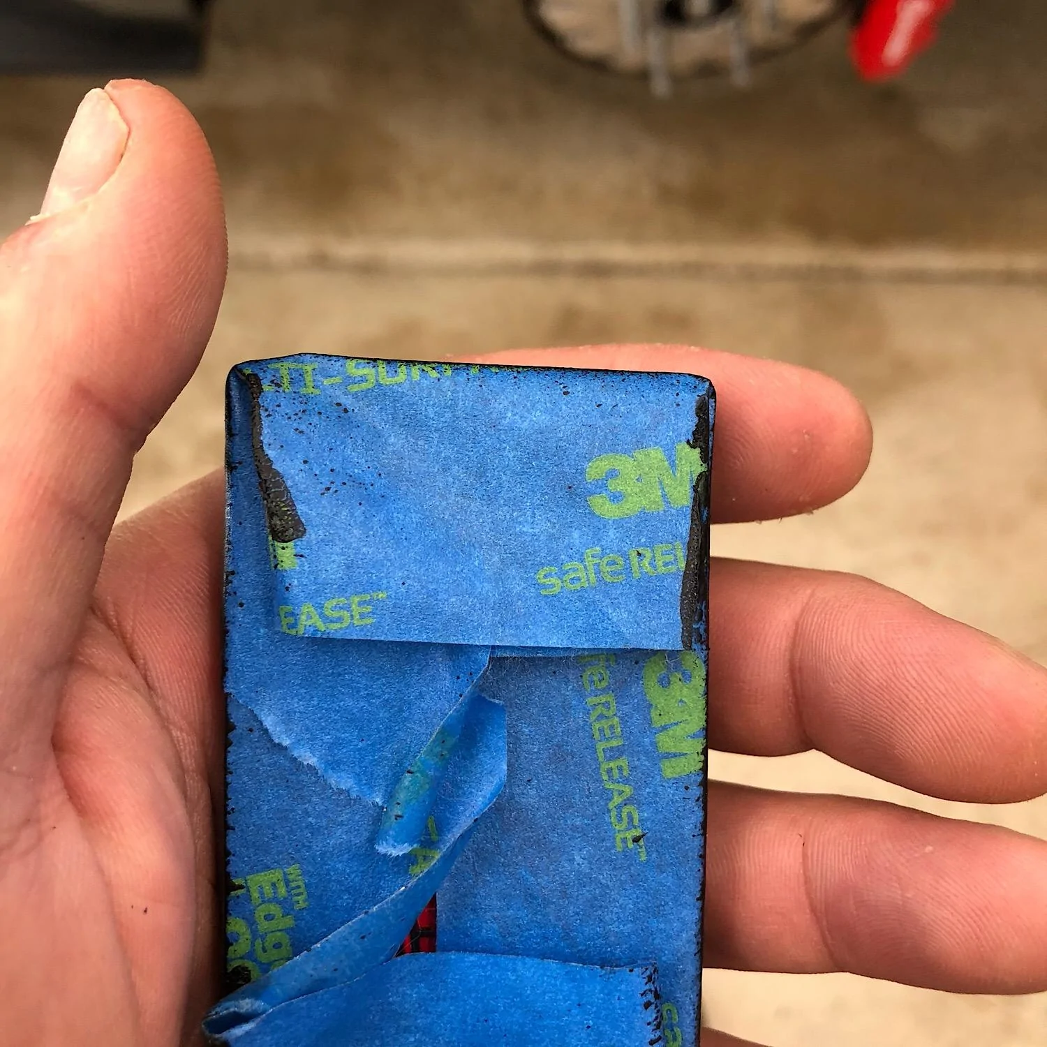

When you do remove your emblem, I’d suggest taping off the exposed side of the emblem to protect that as well.

This is what I started with. The 7 o’clock plastic support broke.

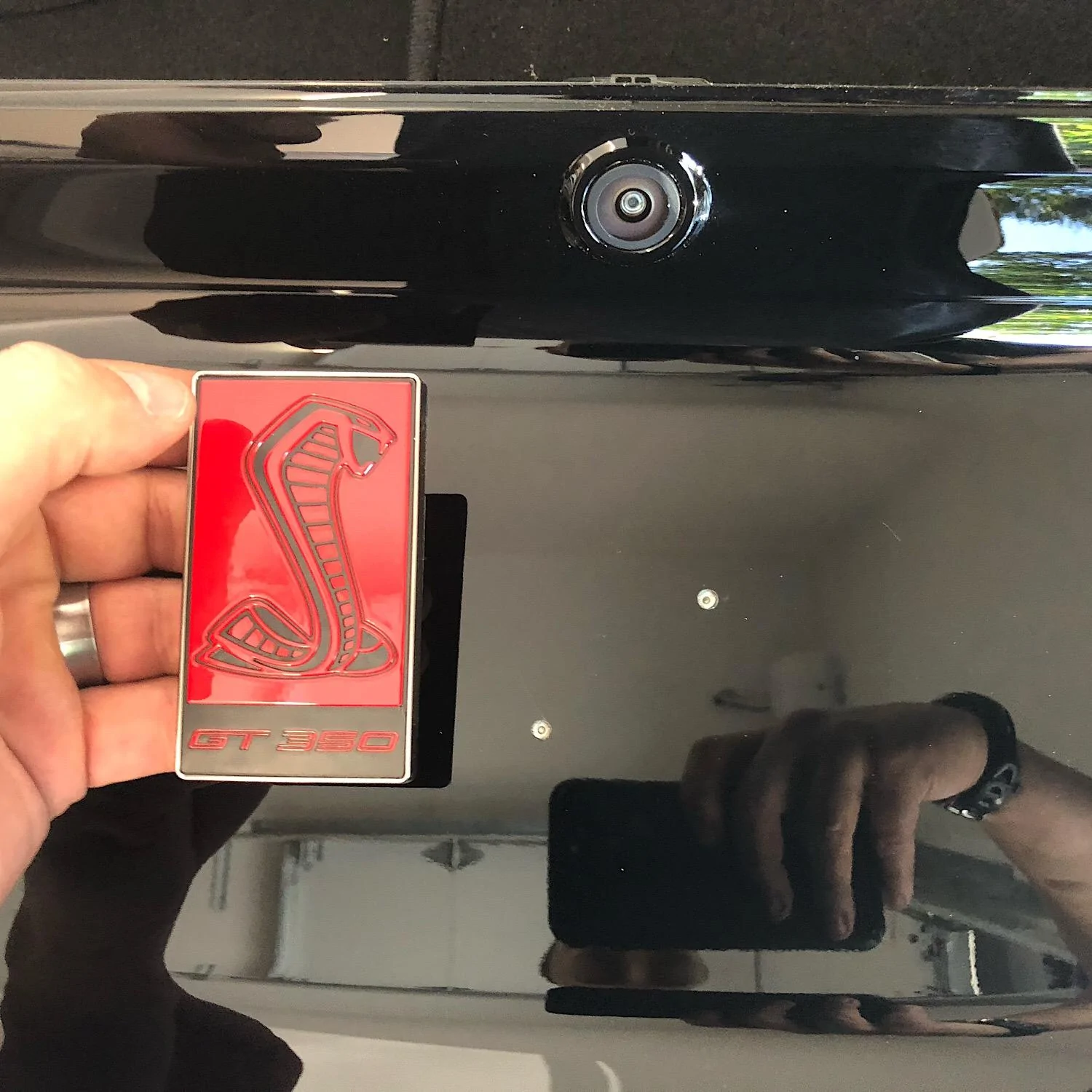

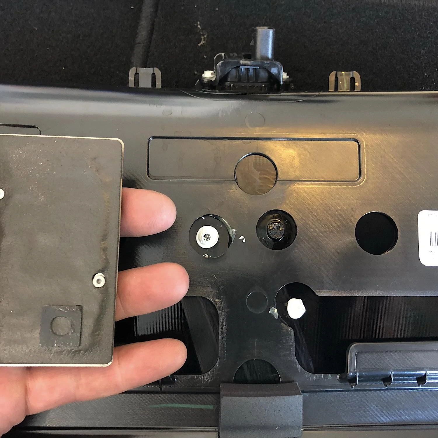

This is how the reverse of the tail light panel looks so you can see how the emblem aligns and is attached.

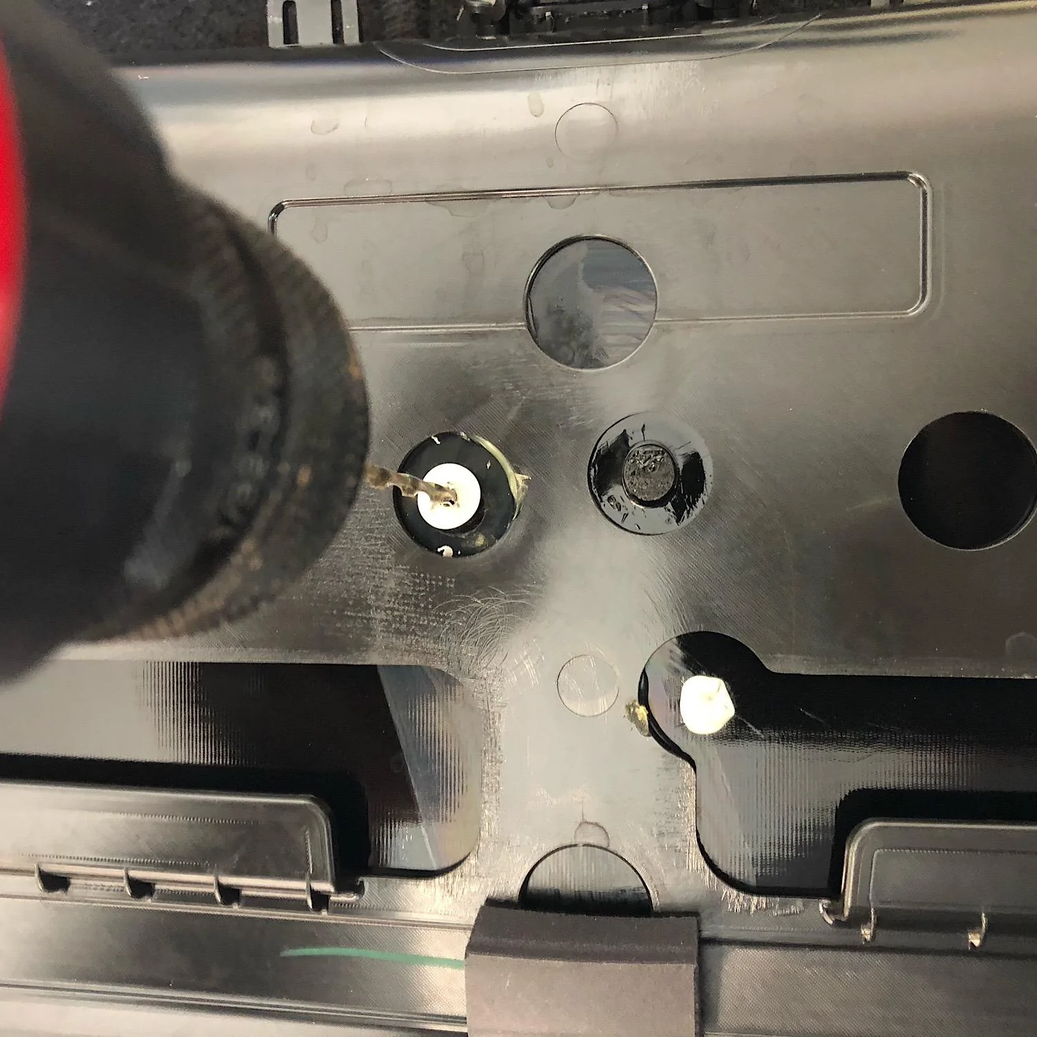

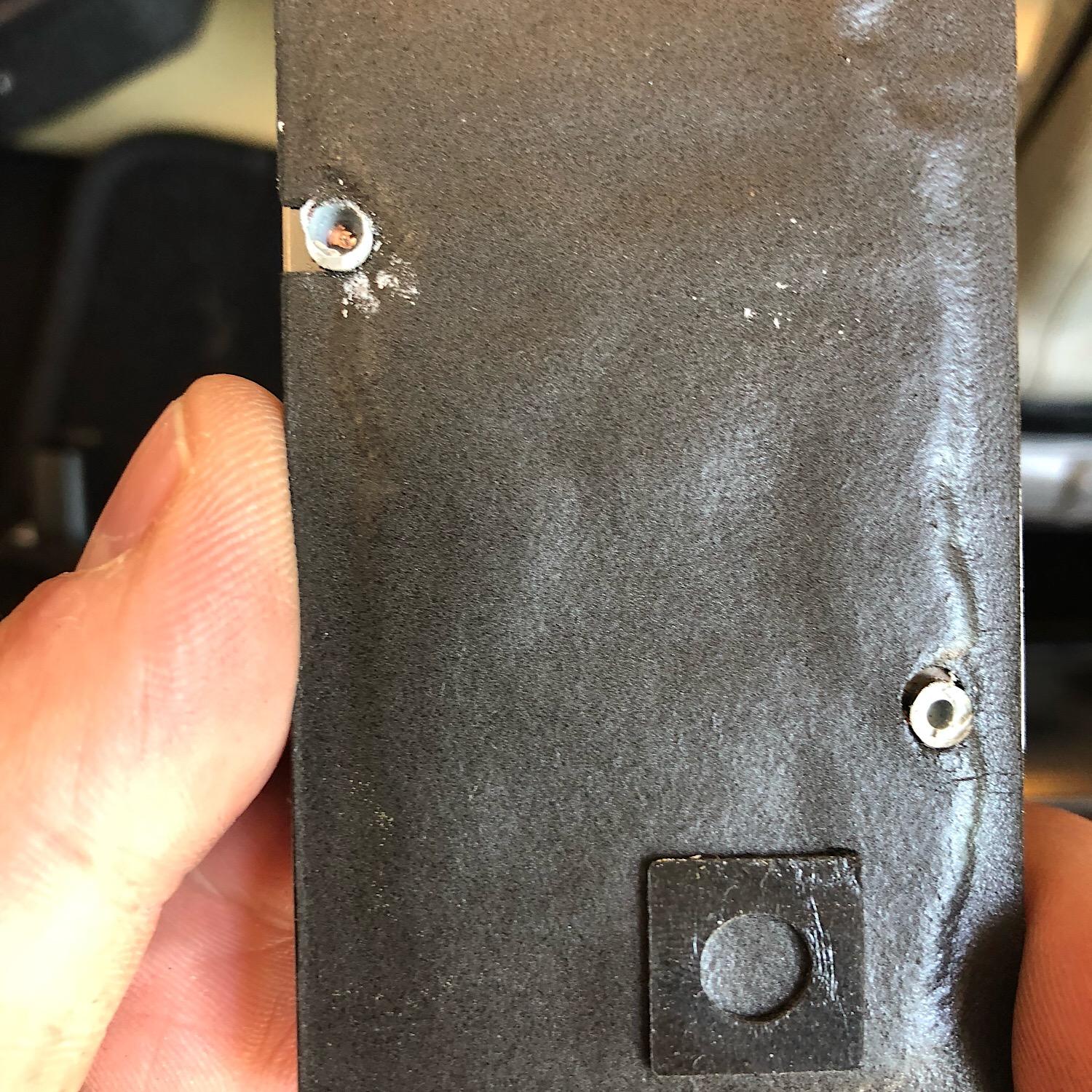

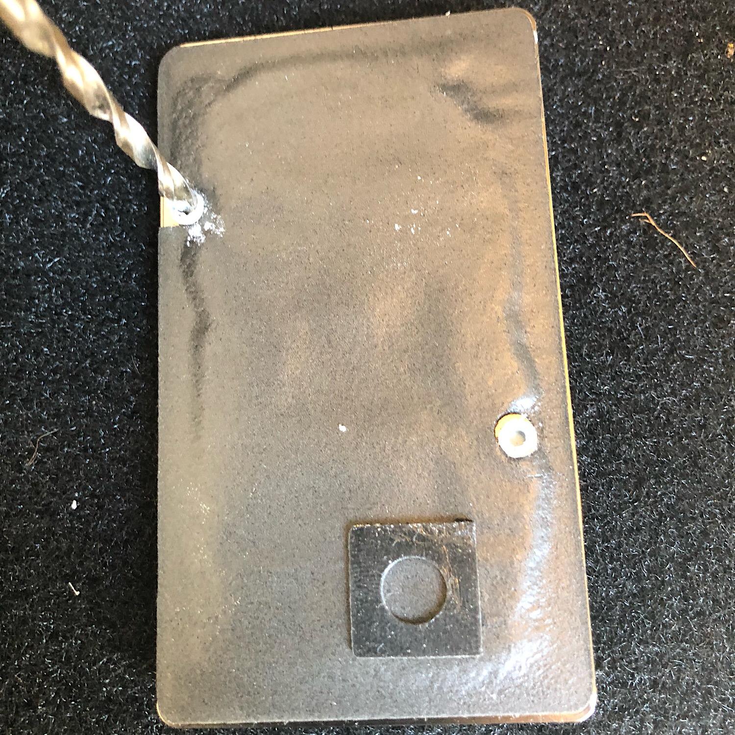

Drill out the remaining plastic on the reverse of the emblem as well as the tabs in the tail light panel. After doing this, it would’ve been easier just to use a Dremel and grind the tabs flush on the back of emblem.

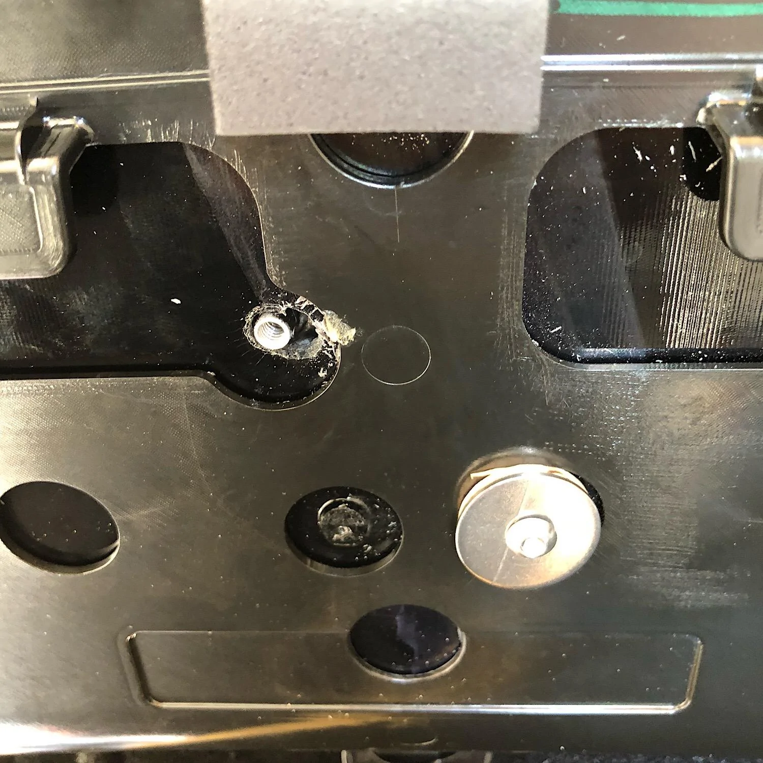

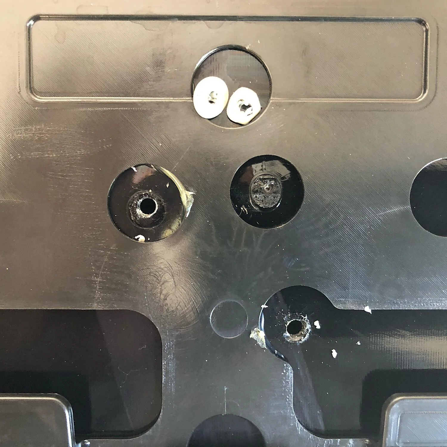

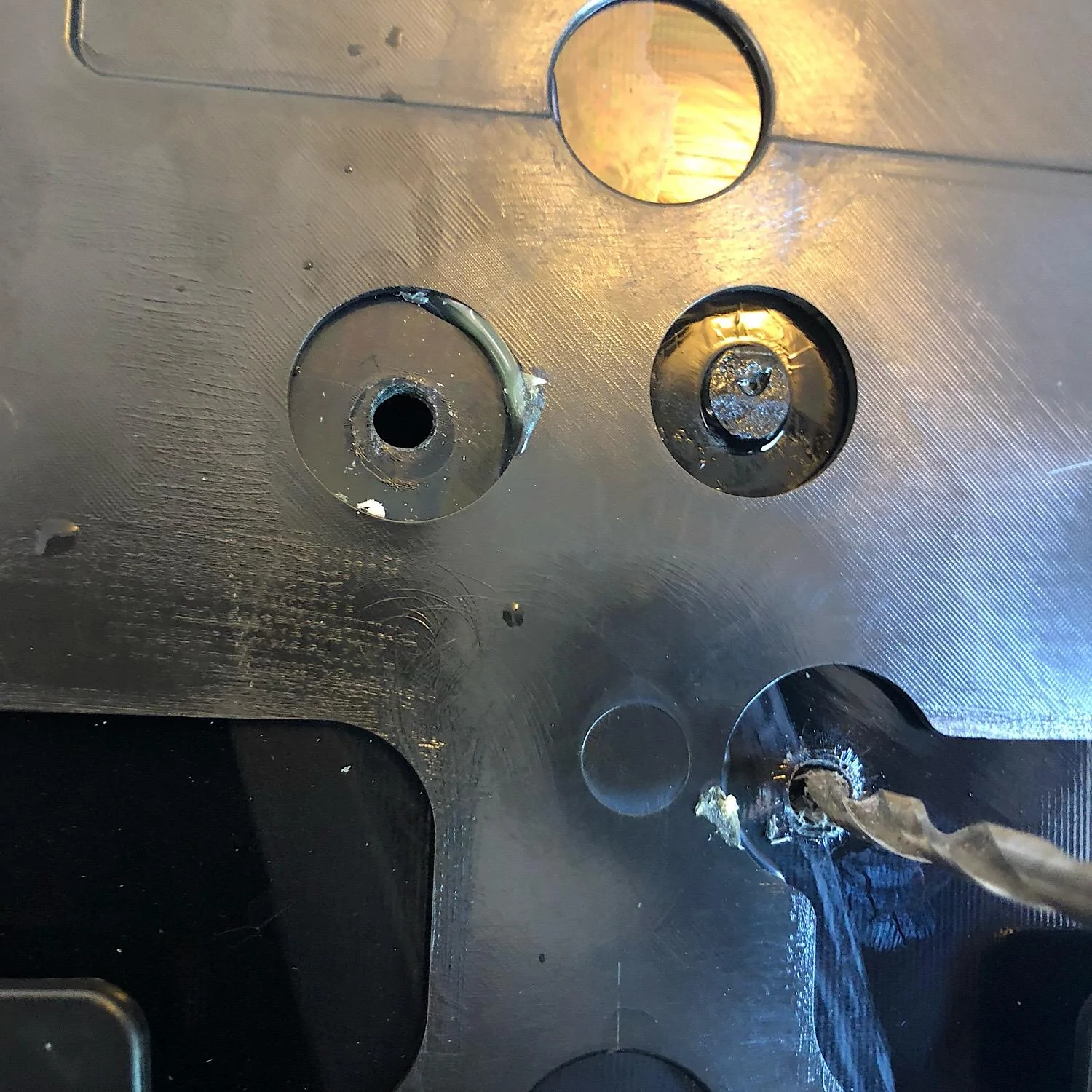

Open up the holes in the tail light panel to accommodate the 8/32 female post nuts.

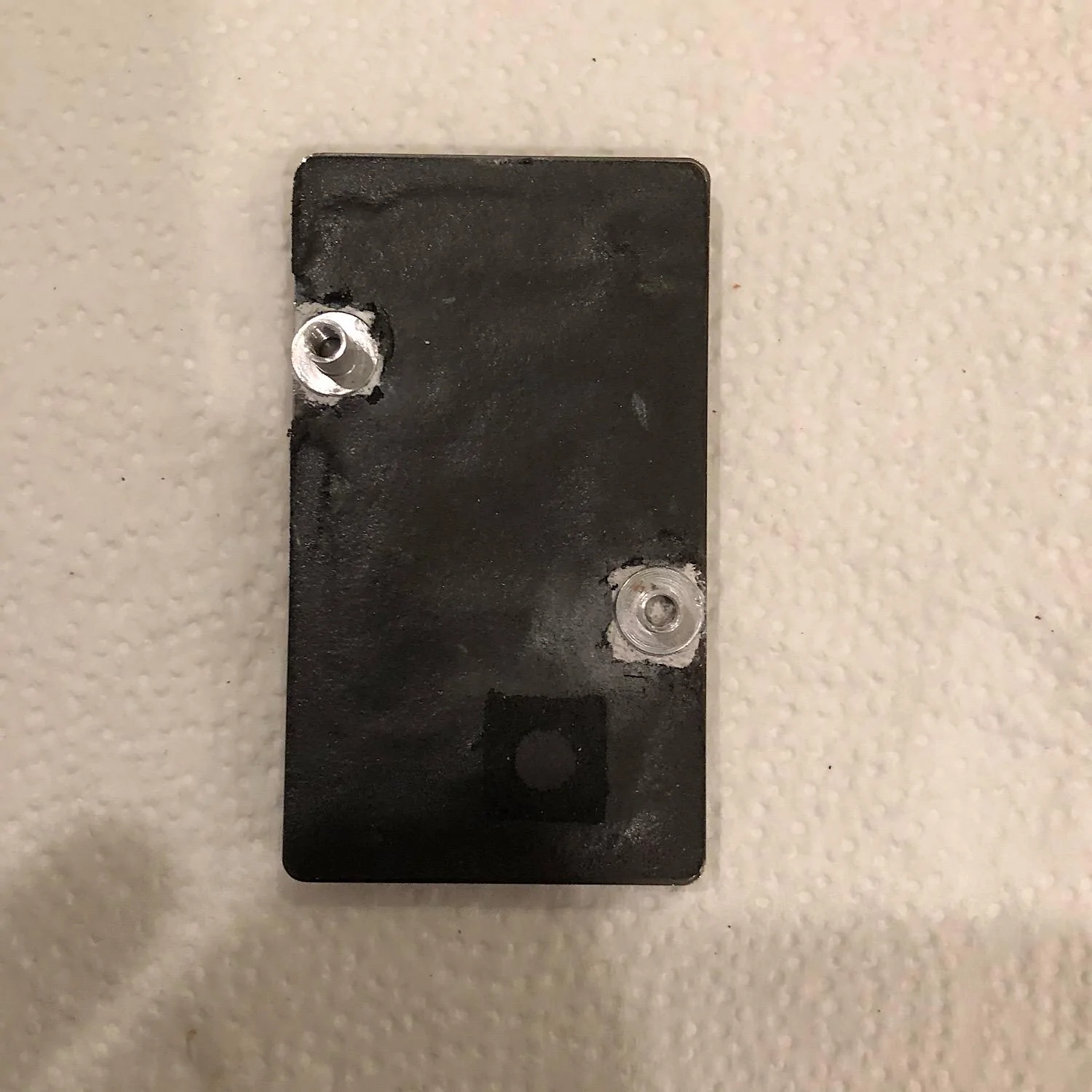

Now, trim away the tacked down foam padding, while the surface with alcohol and then glue down nut using Gorilla Super Glue. I scuffed up both surfaces for good grip and used a little baking soda to help harden the union.

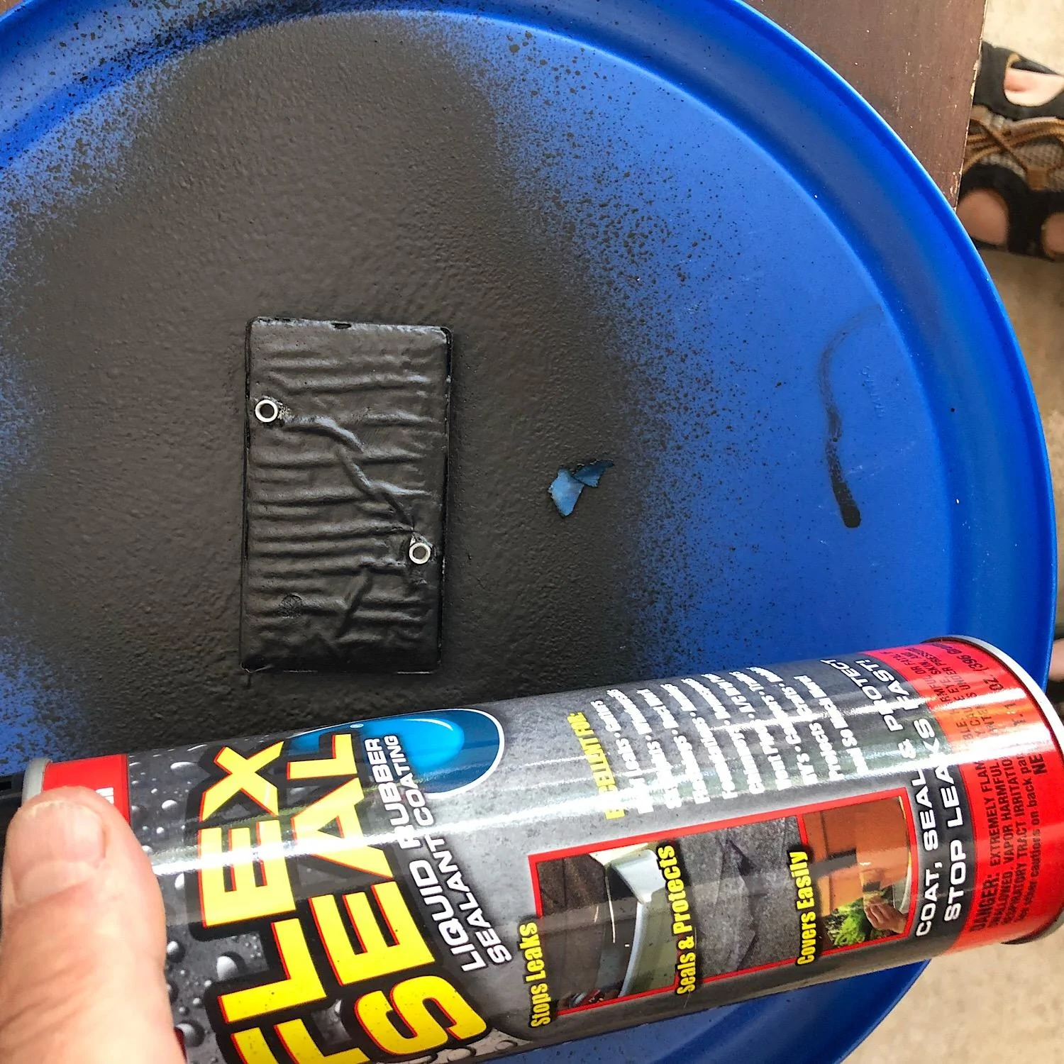

Now lay the masked emblem on its frontside and spray over good with a can of Flex Seal. This was the best medium I could find to act as a barrier between the emblem and the panel, as the foam backing has been removed in some places.

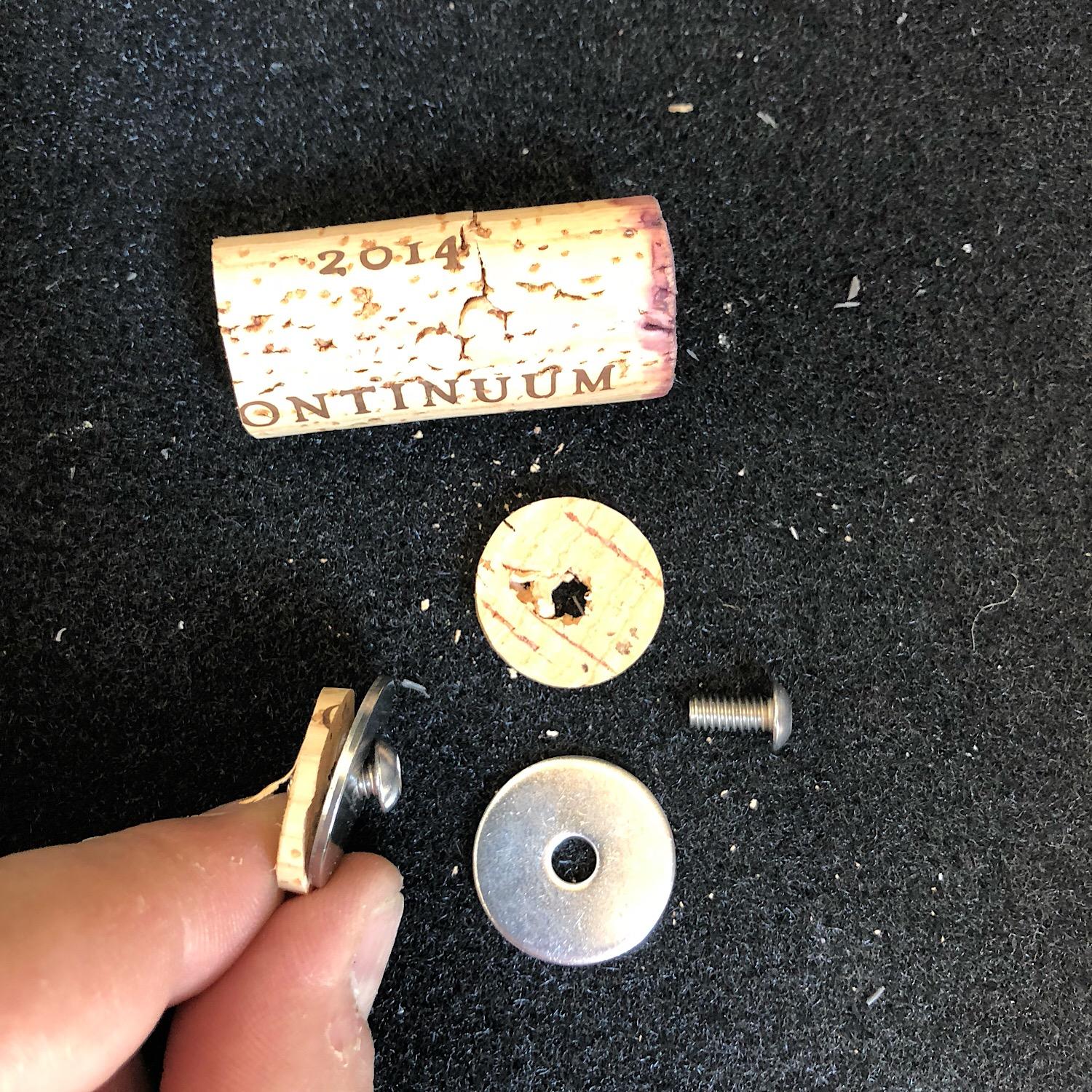

I used two 8/32 female post nuts, two 8/32 x 3/8” stainless screws and two 3/4” washers as the mounting hardware. Since this car makes so much vibration, I drilled a wine cork and then cut slivers and placed between the washers and the panel to help absorb shock.

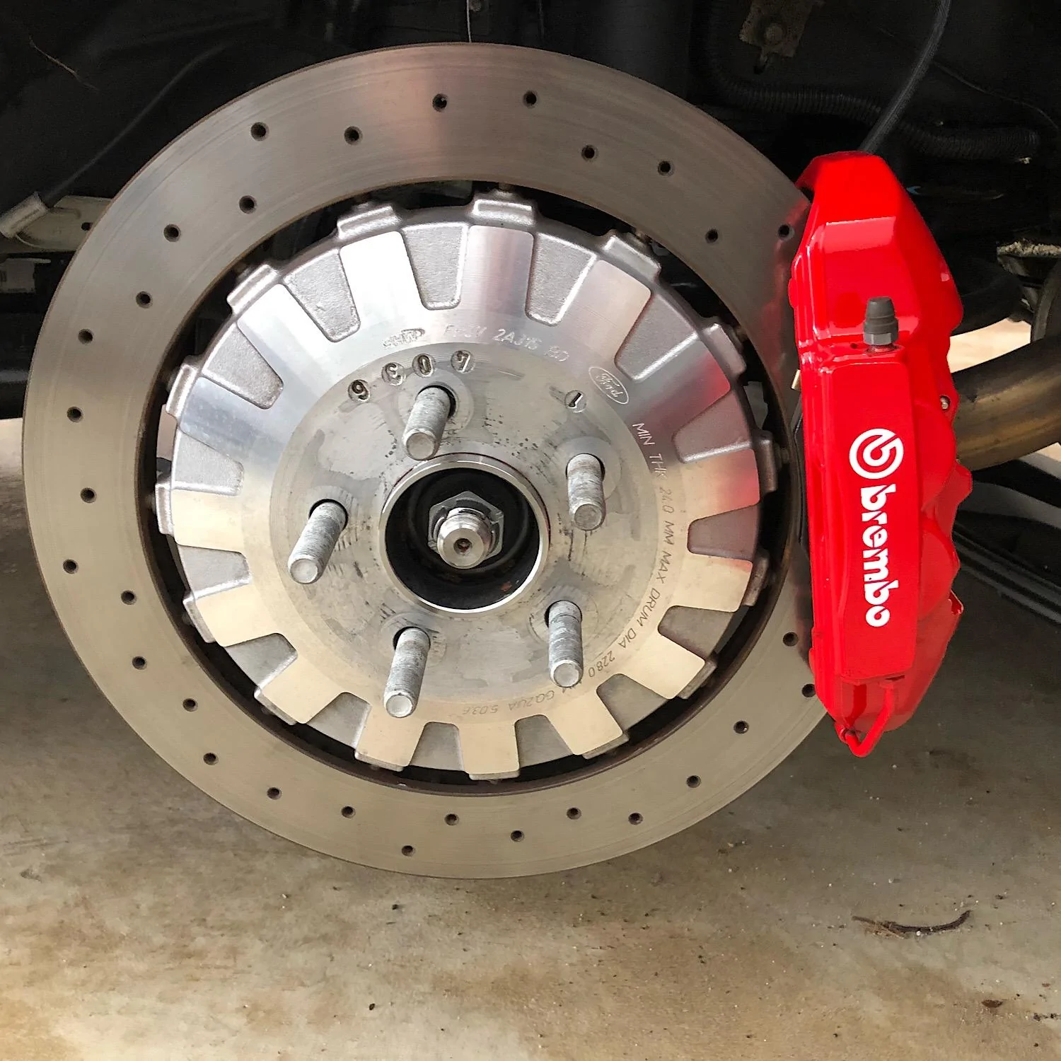

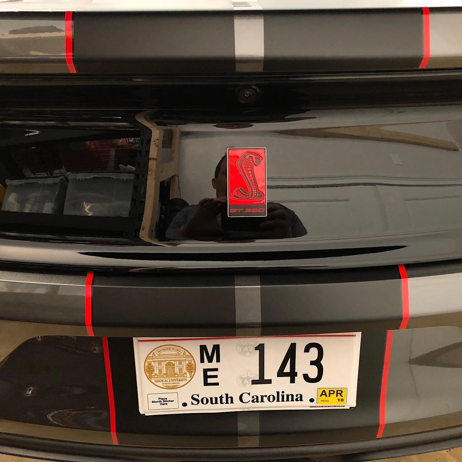

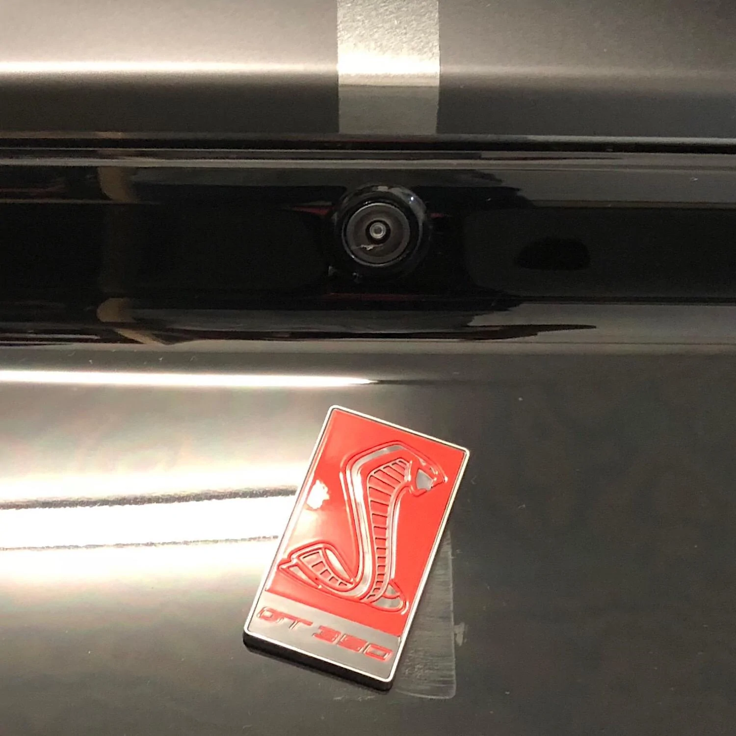

Here is the finished product. I was able to align my panel gaps between the lights a little better. While I was at it, I cleaned my rear hubs and calipers.
