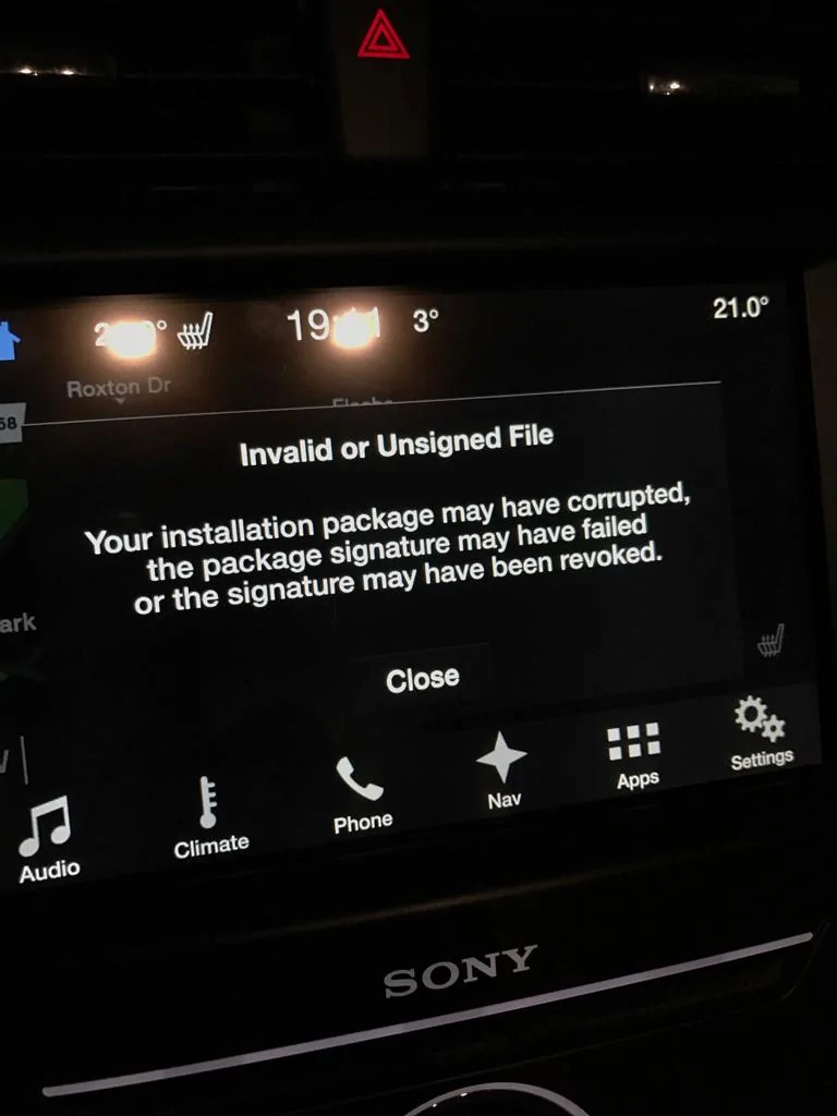

They are the real deal ford update... signed and all. Otherwise you would get this error if someone tries to tamper with the files:
Ford released the update for most 1.0/1.1 Lincolns with Sync 3... none of the Ford vehicles yet.
