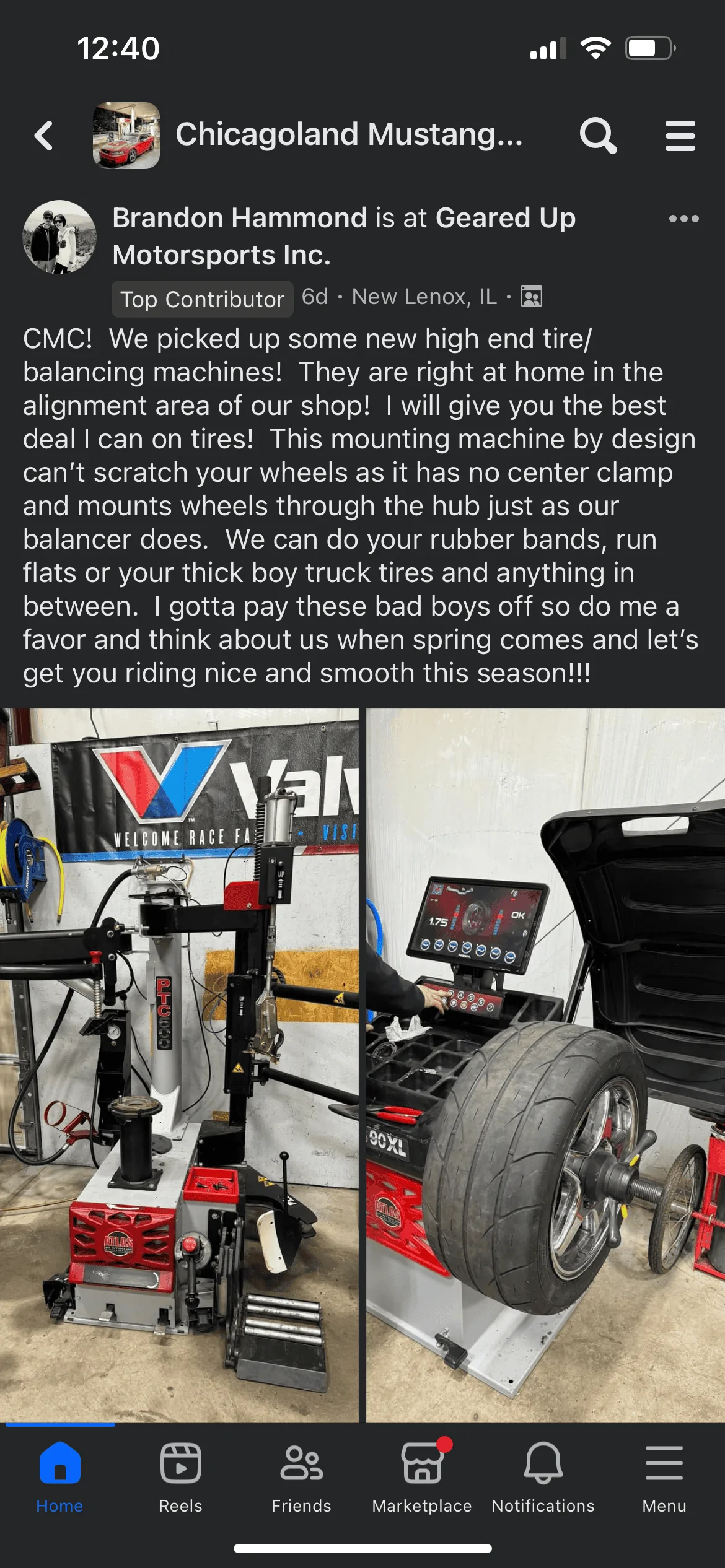

I know I posted in the Chicago thread, but I’ll repost here for the benefit (and thoughts) of others. Crown Customs in Wheeling deals with high end cars/ wheels and Geared Up Motorsports in New Lenox just got a new mounting and balancing machine. Not sure if others have experience with this type of mounting machine so I’ll post it here for comment. Both are closed today but are open tomorrow. Brandon Hammond is the guy at Geared Up.
