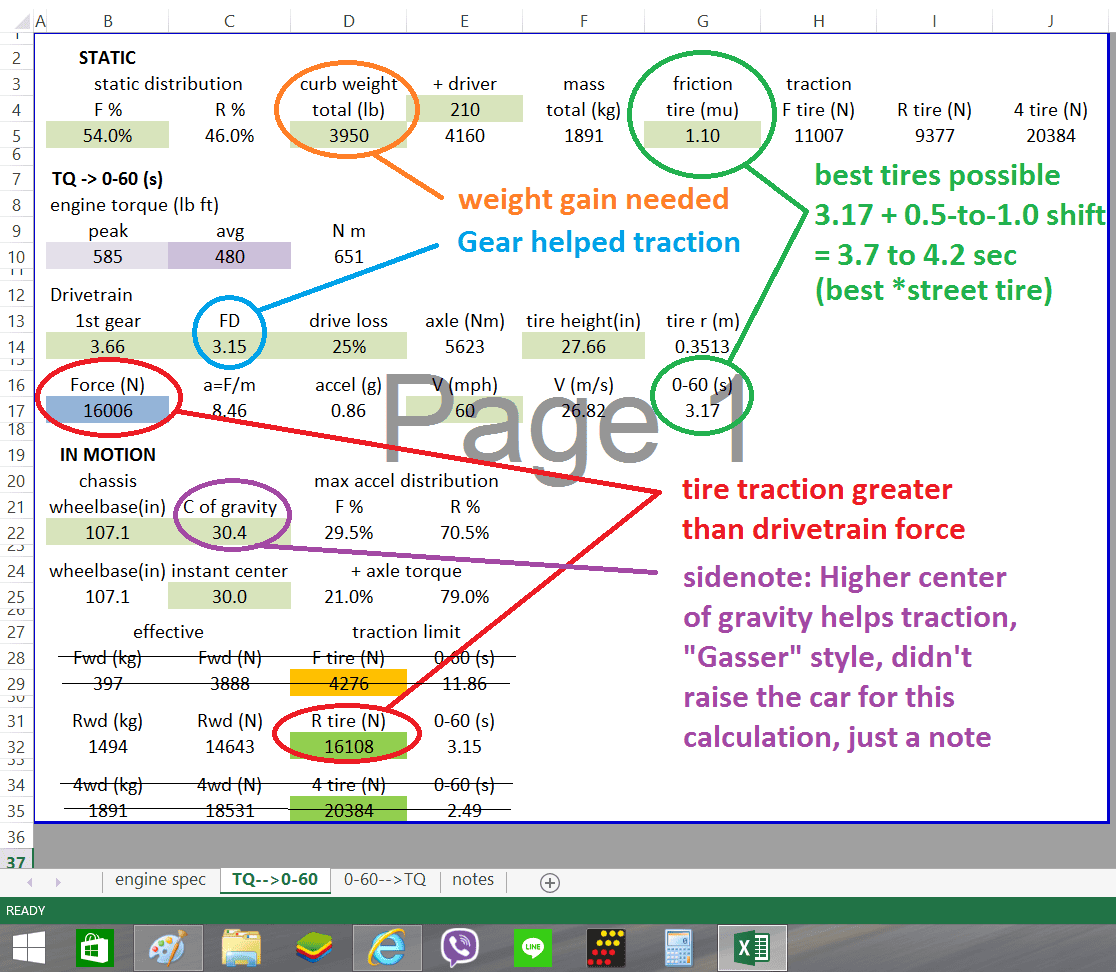

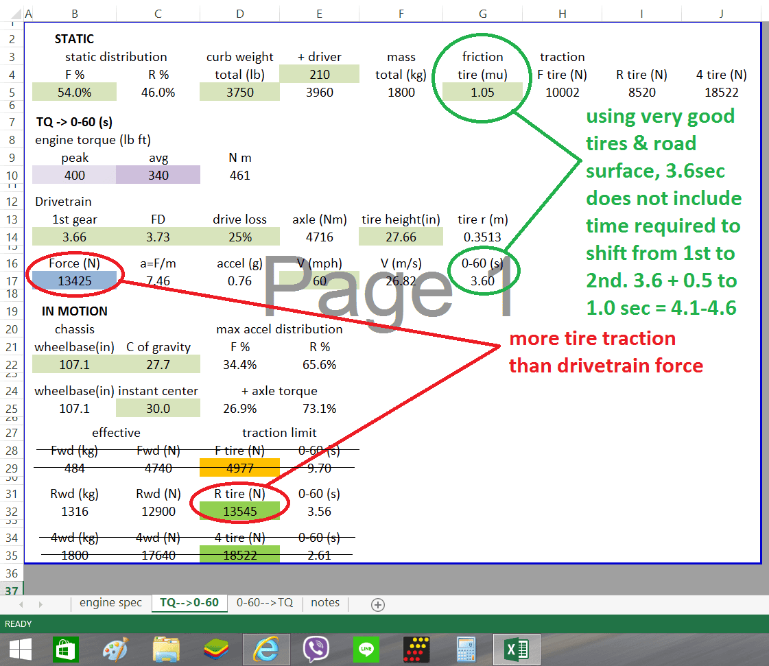

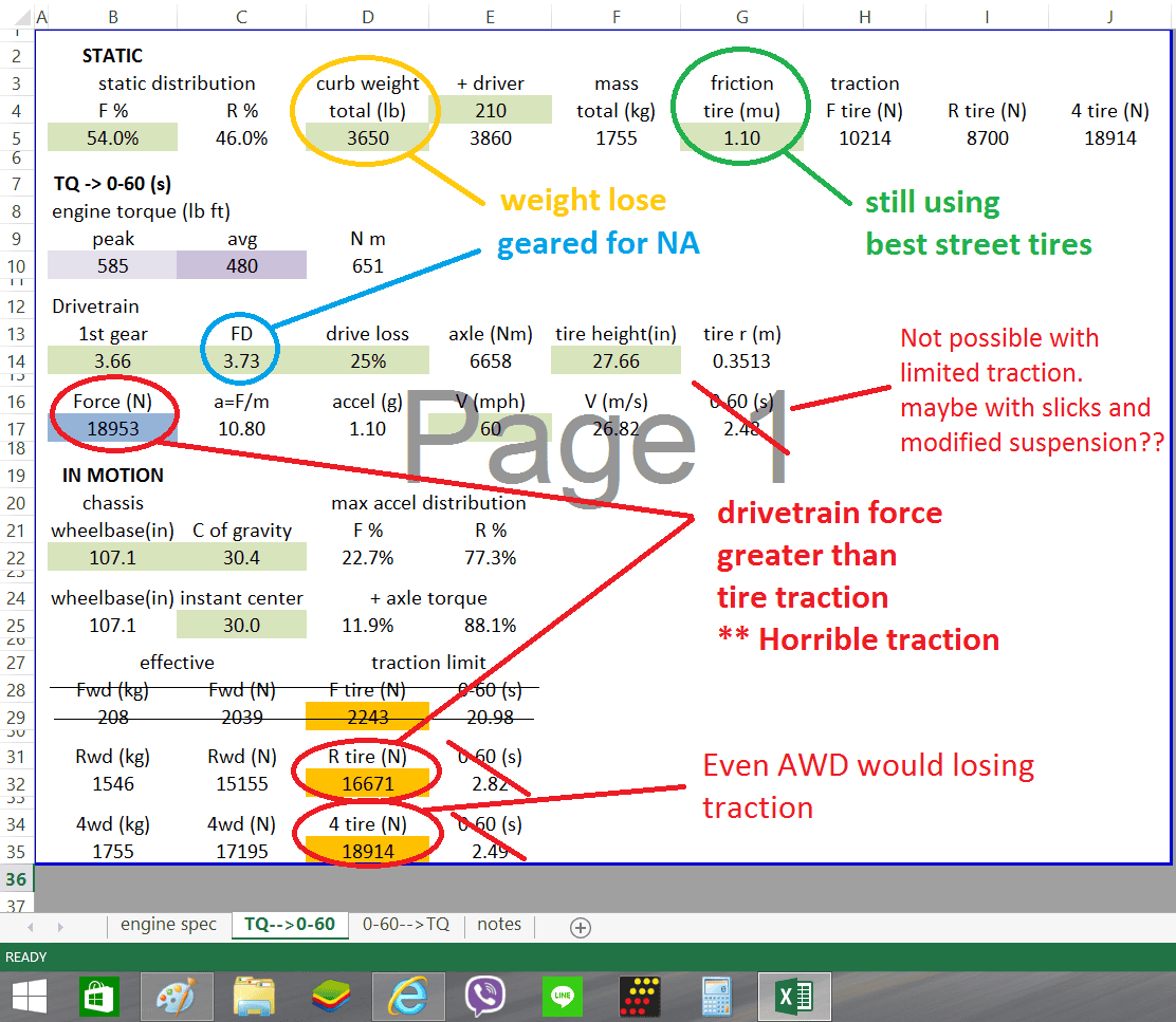

For example, lets compare 2 horsepower and torque numbers:
435hp and 400lb-ft- NA S550 with some bolt-ons
675hp and 585lb-ft- S197 Roush Phase 3 supercharger kit (for S197, using for good realistic comparison.)
At what level does S550 chassis & tires lose traction on street tires?
I built this is very simplified calculator one night a couple years ago. Plugged in the Mustang's numbers.
*note/disclaimer: I guesstimated most of these numbers. If you want to contract me for $200 per hr or 10% of the projects budget. I'll find the real numbers not guesstimates :)
**Didn't raise the car for calculation, supercharger gives the car a higher center of gravity.
You can easily build a car with more drivetrain force than tire traction. But it's a waste of money if you can't put the power down. Only good for smoking tires and Texas Mile top speed runs.

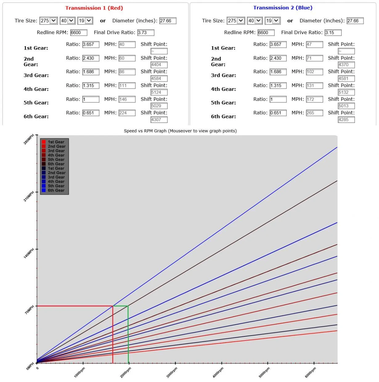

3.73 vs 3.15 highway MPG.
Looks like, at 70mph 6th gear RPM will drop from ~2,000rpm to ~1,650
350rpm move will change the MPG. How much? Please test before and after and share results.
