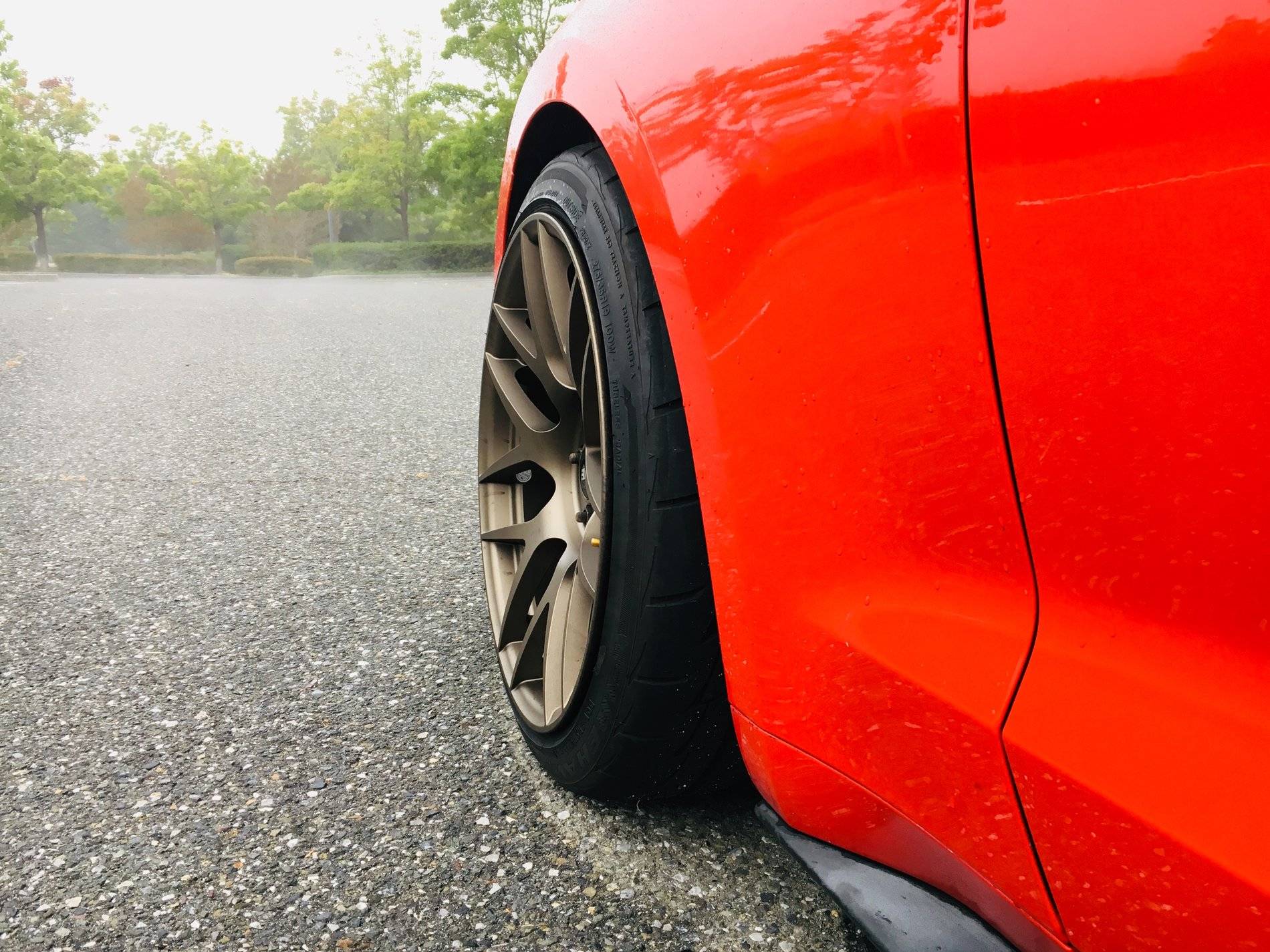

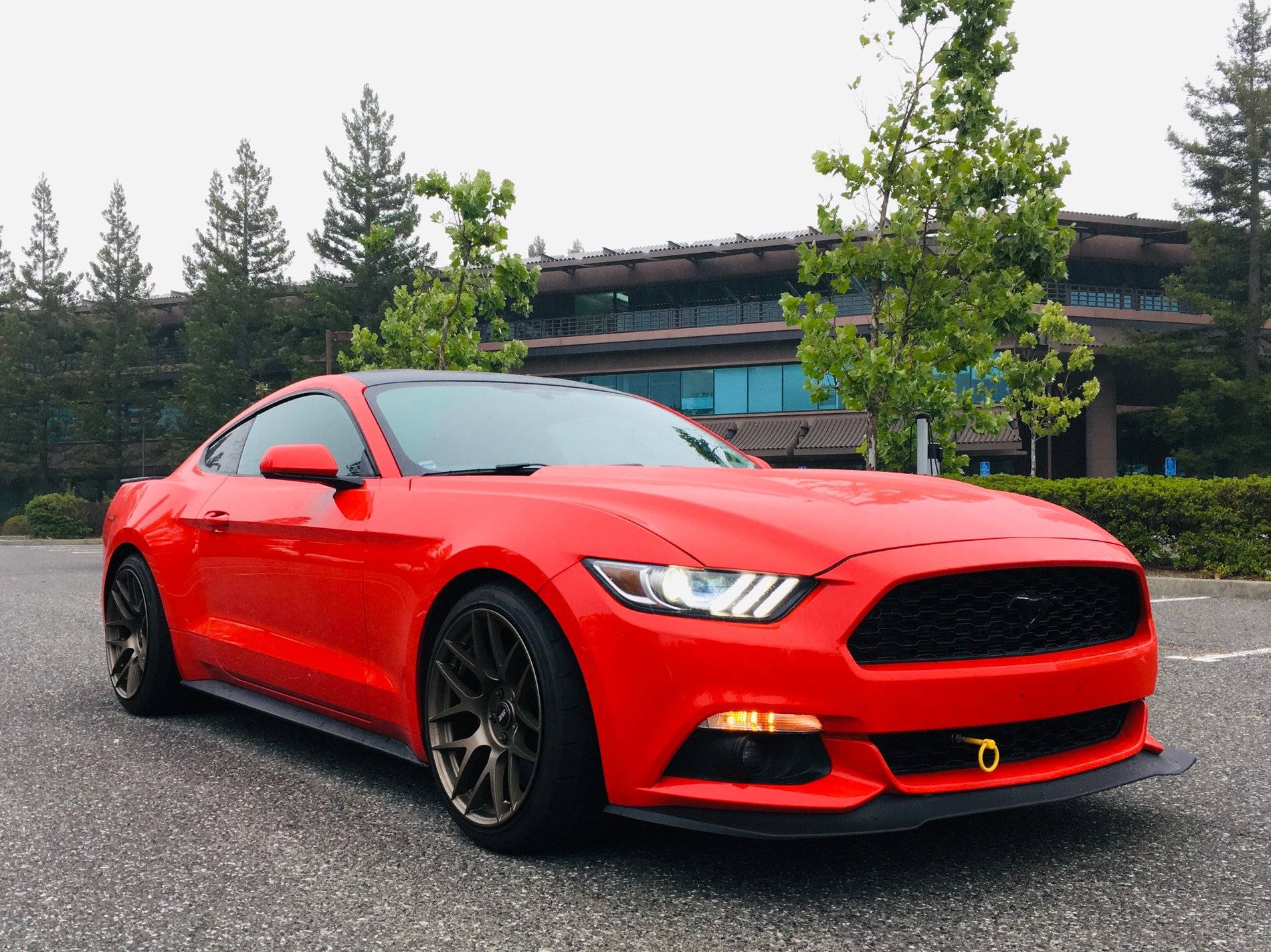

Are these 11in wheels if so what spacers did you use? And what size tire?
Scootsmcgreggor
Oct 26, 2018
502
393
CA
2016 Ecoboost turned GT
Yes 11” all around 25mm spacer up front. Tires are 275/35/19.

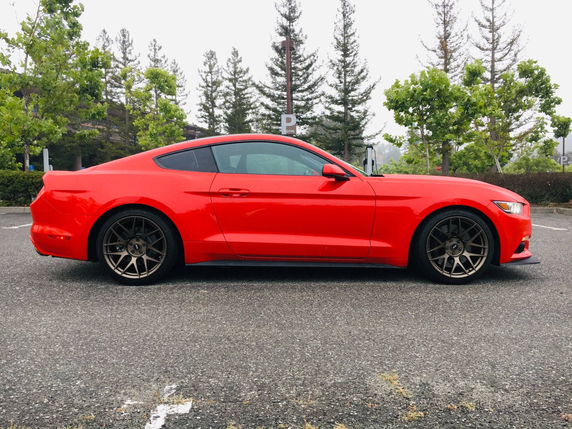

I have to ask, why go through all the trouble to properly fit a 19x11 wheel (studs, spacer, camber) and then only put a 275-285 tire on there?
Sure it will work, but wouldn't it have been easier, cheaper and lighter to just run a 19x10 with the same tires?
Scootsmcgreggor
Oct 26, 2018
502
393
CA
The tires were swapped from my oem rims and had plenty of life left so I’m using them up. 305’s going on next.
