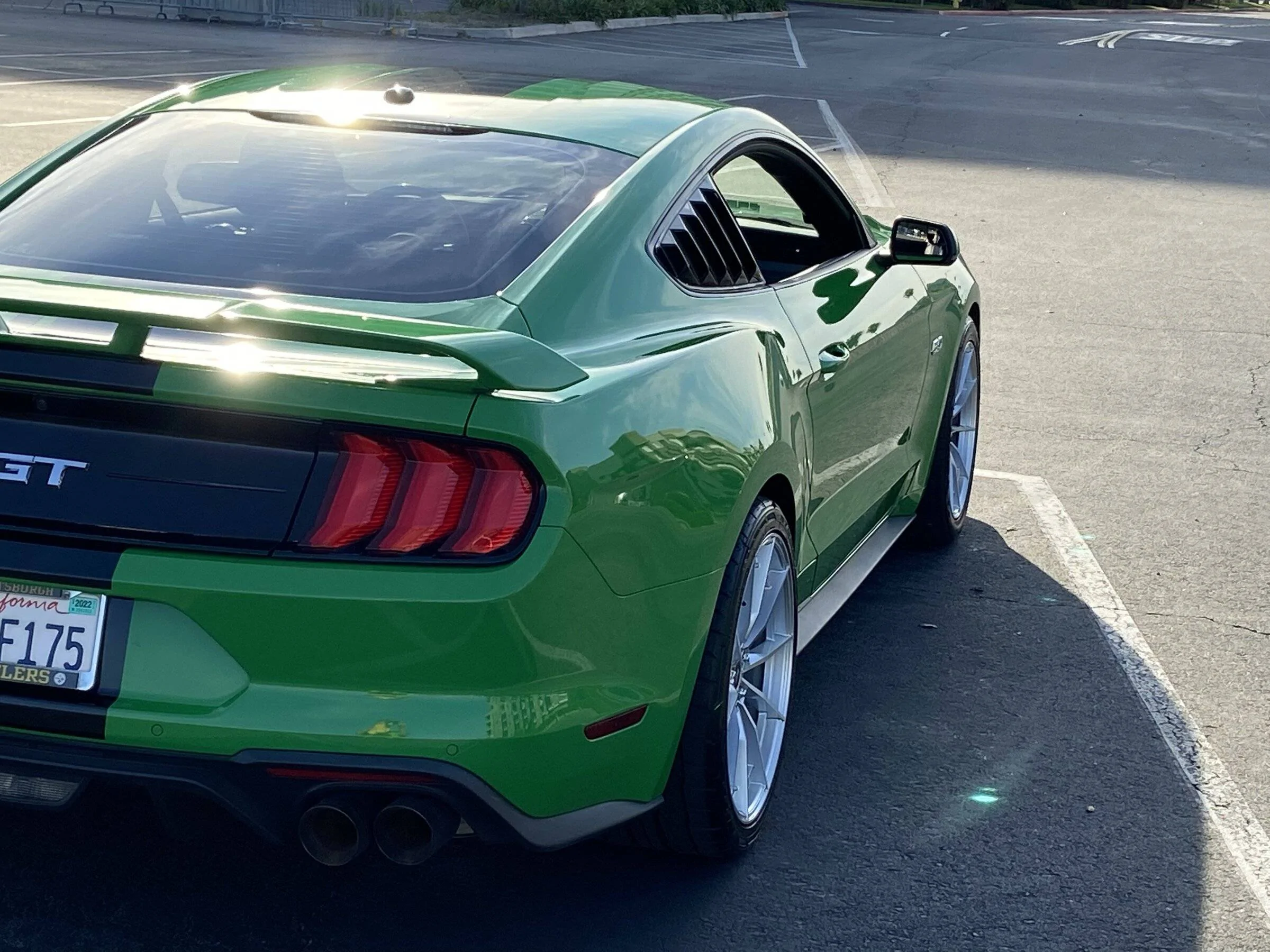

I have 20x11 ET 50 on the rear and love them. Paired with 305/30/20.
