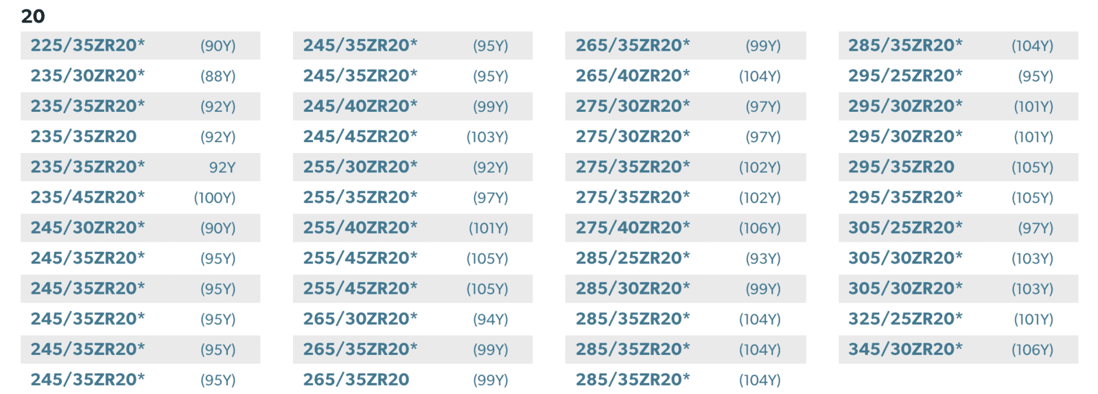

You can get a 325/25 for the rear. the extra width will give you a decent sidewall. You'll also save a lot of money and get a lot more life over the SC2's but then again, it's your money.
https://www.tirerack.com/tires/tires.jsp?tireMake=Michelin&tireModel=Pilot+Sport+4S
