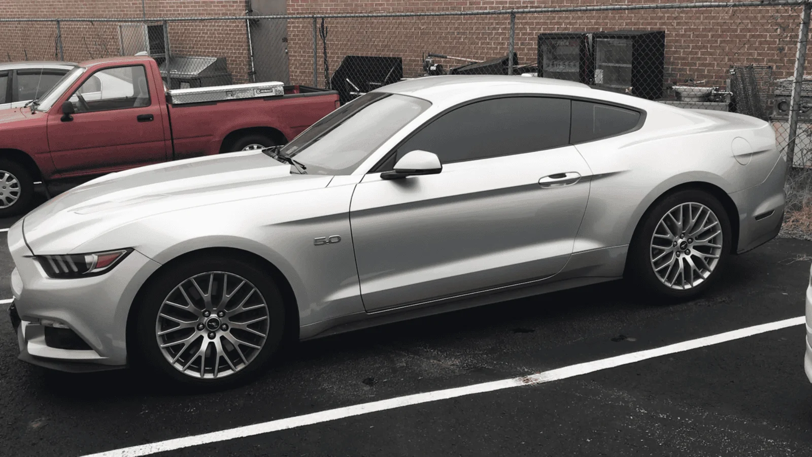

Here is before shot:

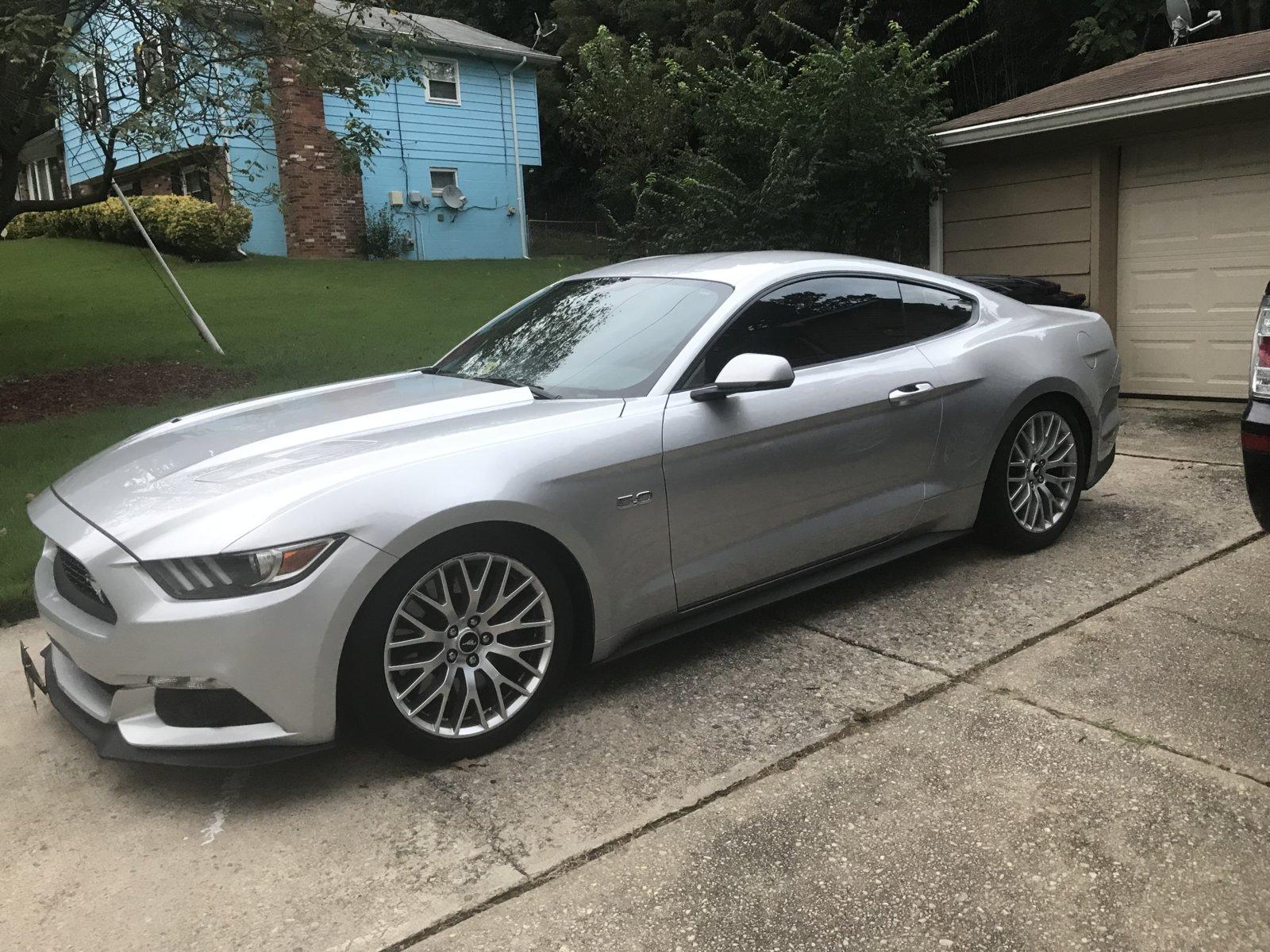

Here is after shot:
