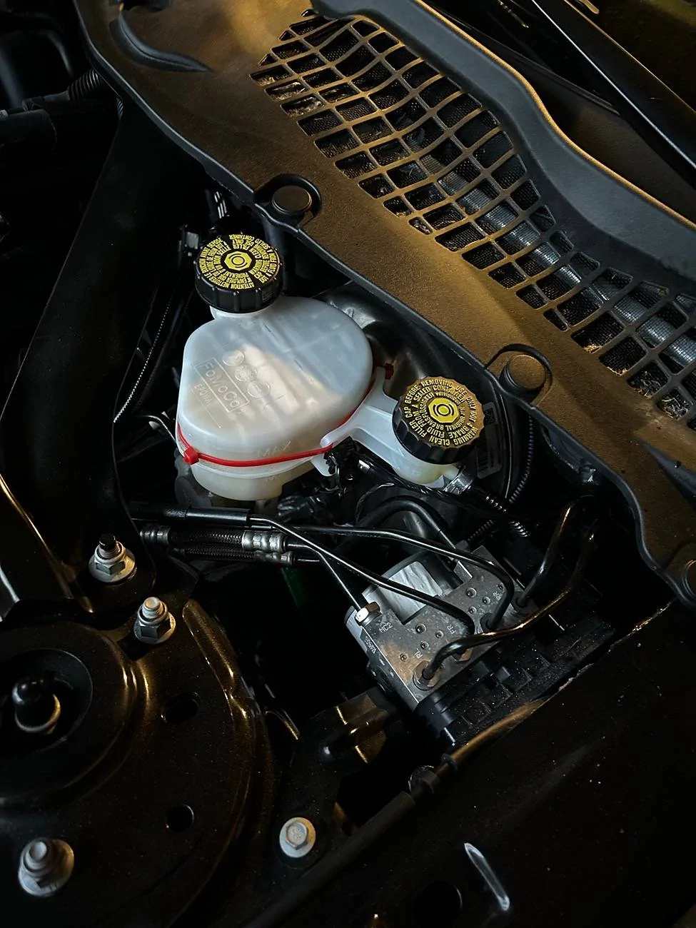

You got a photo of the clutch reservoir? I still need to do mine, just been lazy about it.
Yep
I’ve since made a bracket that mounts to the firewall but honestly this worked fine with the high heat red zip tie.

Good stuff. I'll probably do something similar, but someone over on TMO designed and shared a 3D printed bracket. I might give that a shot first. How well does the clutch line stay on the reservoir?
It’s not an issue with the tension taken off the line by moving it closer to the firewall it fits like it was actually intended to. I added the fuel injection clamp for added security and it’s never coming off now.
