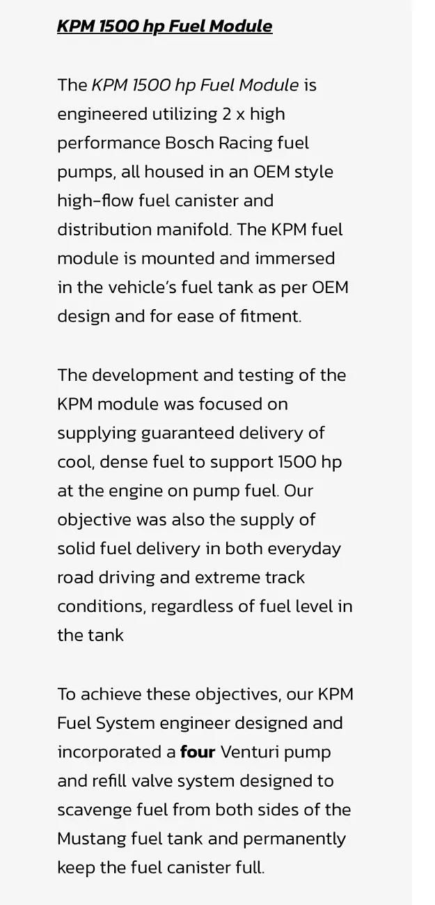

as Mike has said…I believe KPM was designed for just such a scenario, but add a couple of his improvements for sure and this is just the 1500 kit 😉
From my understanding all of KPM numbers are based on regular fuel, not E85. I make over a 1,000 now on E85 and with my new motor I’ll be going over that. I figure I need at least 1,500 capable on E85 to support what I’m trying to do.
That’s why I converted your hp desired into lph and mentioned the kpm2200 version earlier.
