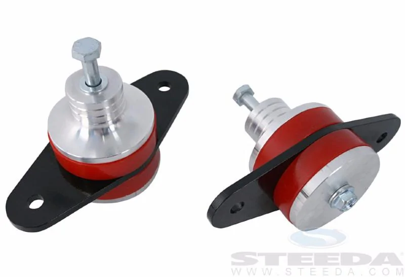

When you fit the Whipple you need to cut away a section of the K brace due to the additional height.
If you fit Steeda adjustable engine mounts you can lower the whole engine enough to clear the K brace and avoid any modification to it. ÂŁ219 for a pair.

I have Steeda adjustable engine mounts already bought to lower the centre of gravity of the car and let the supercharger fit the engine bay more comfortably.

Yeah we say its a must do mod in the UK. PLus of course they are stronger and better able to deal with the added weight of the supercharger and of course all that extra torque!
I have to say that working with Steeda has opened my eyes to the power of engine mounts! Something I had always assumed to be something you only changed when yours broke has now been repeatedly proven to me both personally and by customers to be a potentially major improvement.
Example 1. Focus ST: Our demo Focus ST was transformed by the addition of our rear engine mount, which i tested on an airfield sprint course. Without it, it was crazy wheel spin and hop, with it...boom! traction! I was stunned that a single mount could make so much difference.
Example 2: Customer Race S197 Mustang: Fitted to help with Supercharger install BUT wow, he LOVED the improvement it made to his cars handling: Read the full blog post HERE
But in Brief:
"The main point of fitting the Steeda engine bushes was not intended to improve performance, but to take advantage of the adjustable height washers in the kit, which allowed the engine to be lowered by nearly one inch, to gain increased underhood clearance for the supercharger pulley. A side benefit of this was to allow the Steeda strut brace to be refitted, which had originally been removed when the supercharger was fitted, again due to clearance issues."

"The black stiffer rubber bushes meant that instead of energy being wasted twisting the engine, it was now going to the back wheels which felt like a 50BHP power upgrade. This also meant I was able to lower the engine by an inch, which in turn meant that I was able to refit the strut tower brace which had previously been removed as the supercharger was too tall. The lower centre of gravity and stiffer front end had transformed the car’s handling – it now turned like an old mini ! It is quit astounding that such a simple upgrade involving some bits of rubber and bent metal could have such an astounding improvement on both performance and handling – giving a huge increase in confidence in the cars abilities. I would strongly recommend this Steeda upgrade as the best value for money performance increase you can buy for your Mustang ! " :clap2::headbang::cheers:
