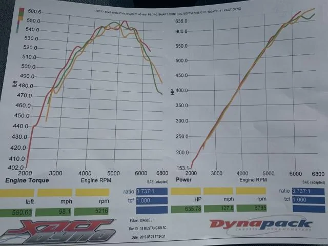

Not sure about you UK guys, but my 3.2 KB just made 635hp 560tq to the wheels on the 91 tune since that’s all I can’t get in this state. That’s 748 at the flywheel, more than the 725 listed for the 91 tune. And that was with him lifting at 6300 because he thought the redline was 6500. After that it was heat soak city. So there’s a little more left in her, and that’s just just on ten PSI.

Looking good! Have you got a Dyno reading (Graph) pre KB? it would be interesting to compare the differences in the curve/output.
Unfortunately, no. Wish I would have, just never got around to it.

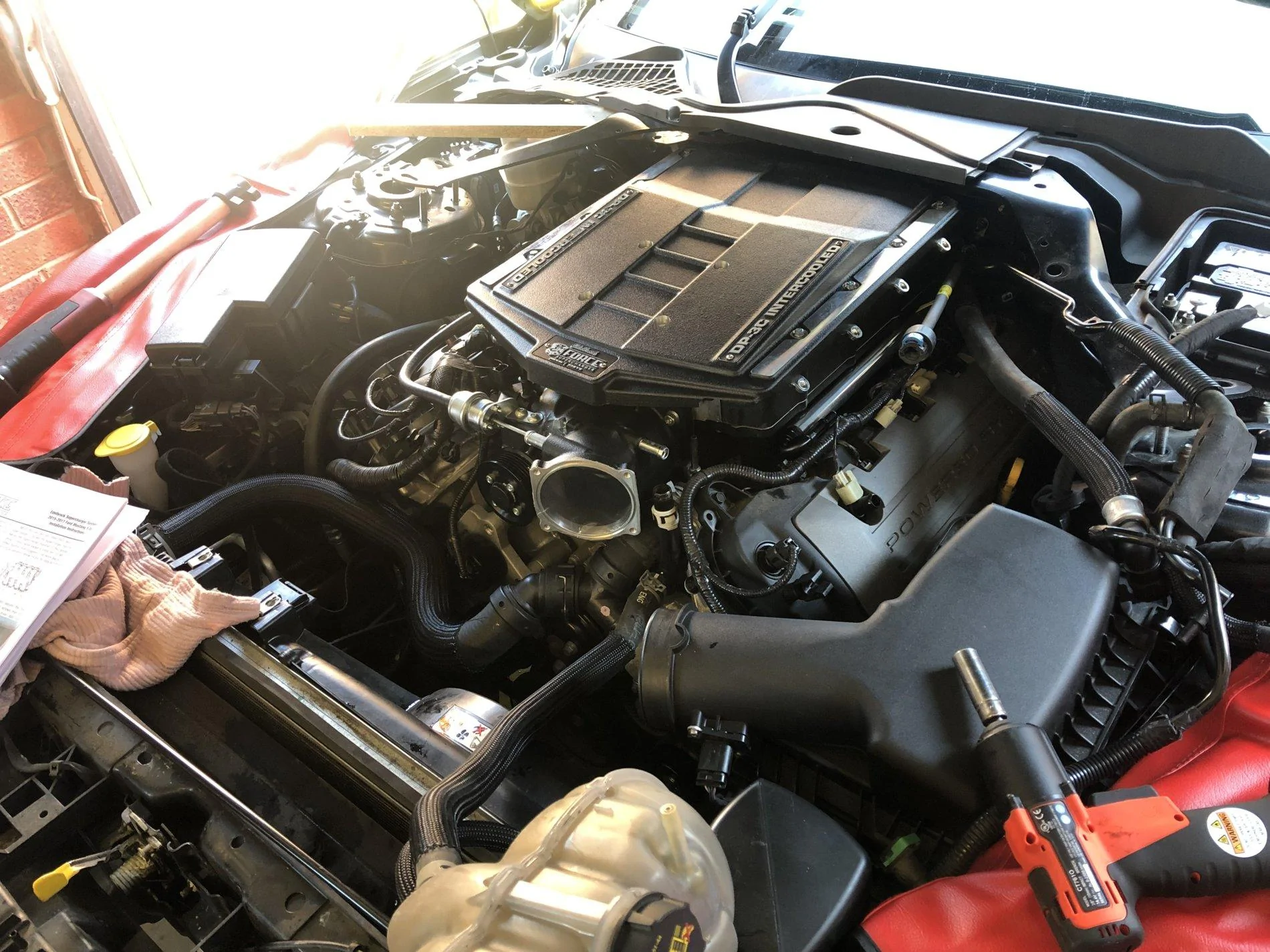

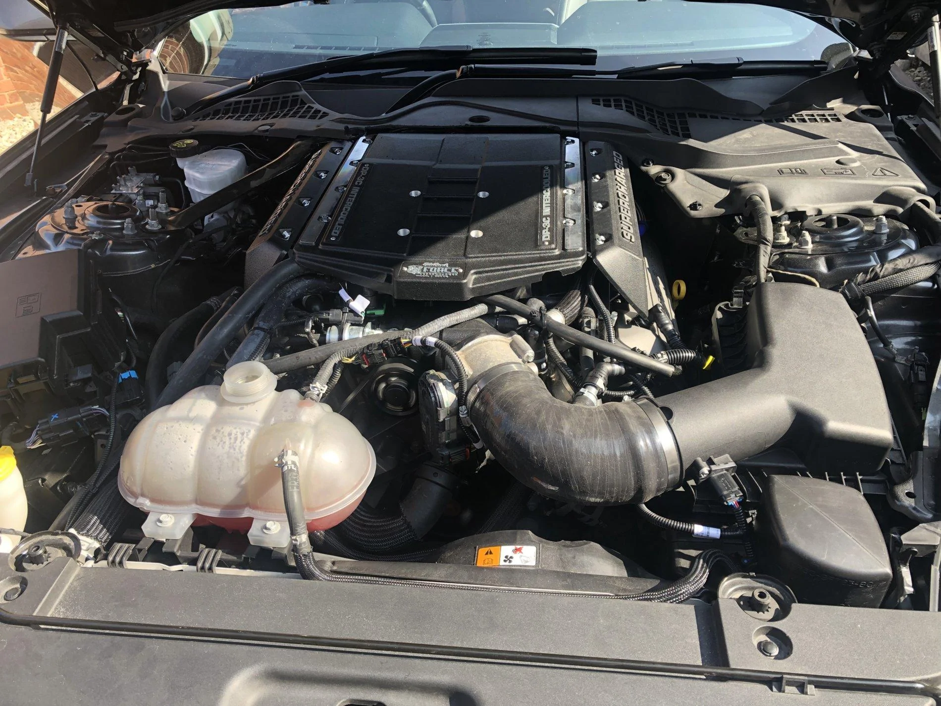

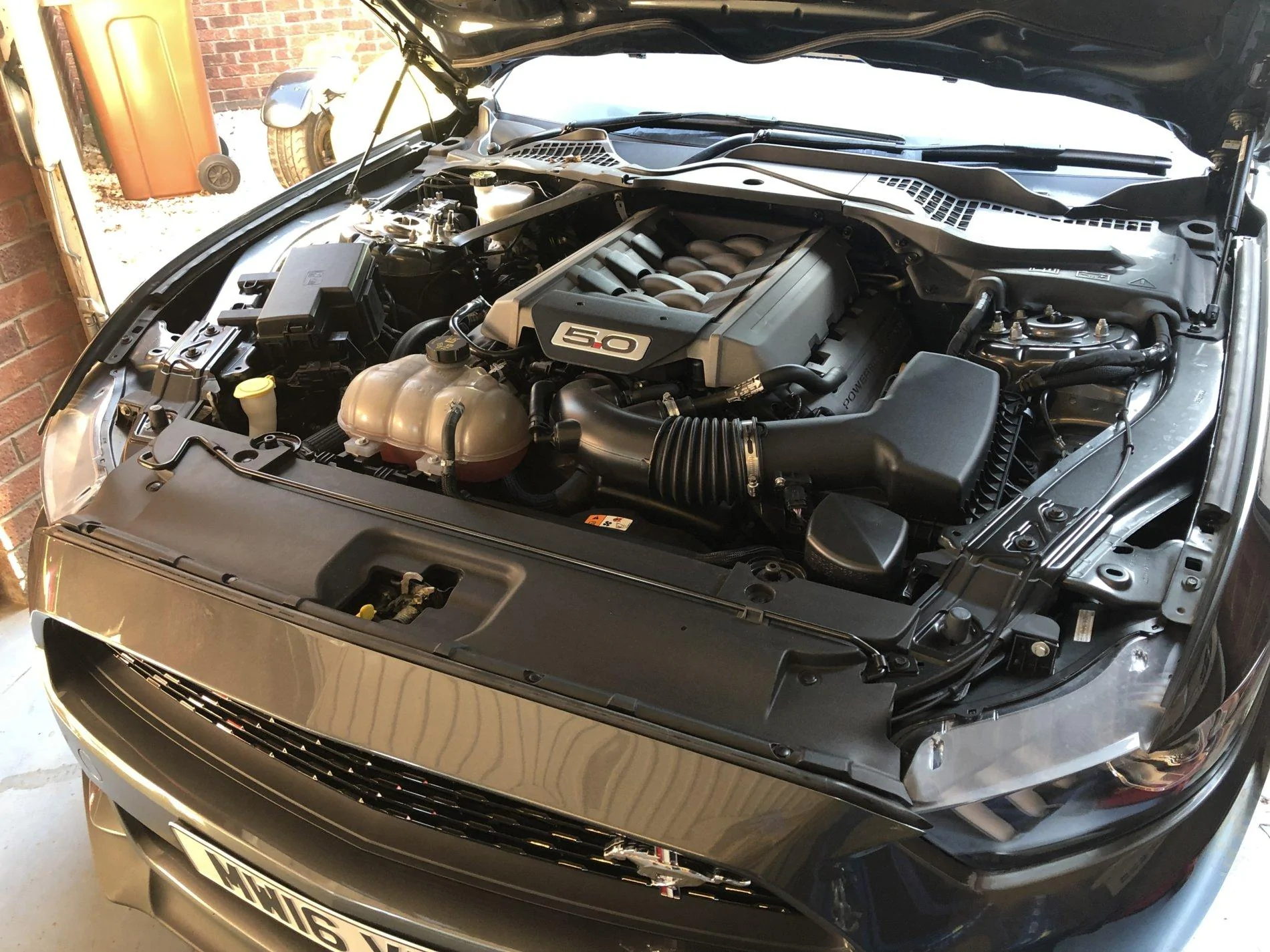

Well, it’s fitted
CraigJ
CraigJ
Oct 28, 2018
337
327
Wakefield, UK
2016 Mustang GT, 97 Westfield SEW
It’s certainly faster, but think the mapping could be better so will be going for a custom setup soon. Lost some low down torque.
Took the day to fit but did some last minute fettling today. The kit is for LHD so some of the bits don’t fit so had to mod some piping but nothing hard.
The K brace does have to be trimmed a fair bit to clear the blower and side covers.

sounds like a custom tune is definitely in order then. My KB has 500 foot pounds of torque at 3000 RPM on just their supplied tune. What boost are you at?
