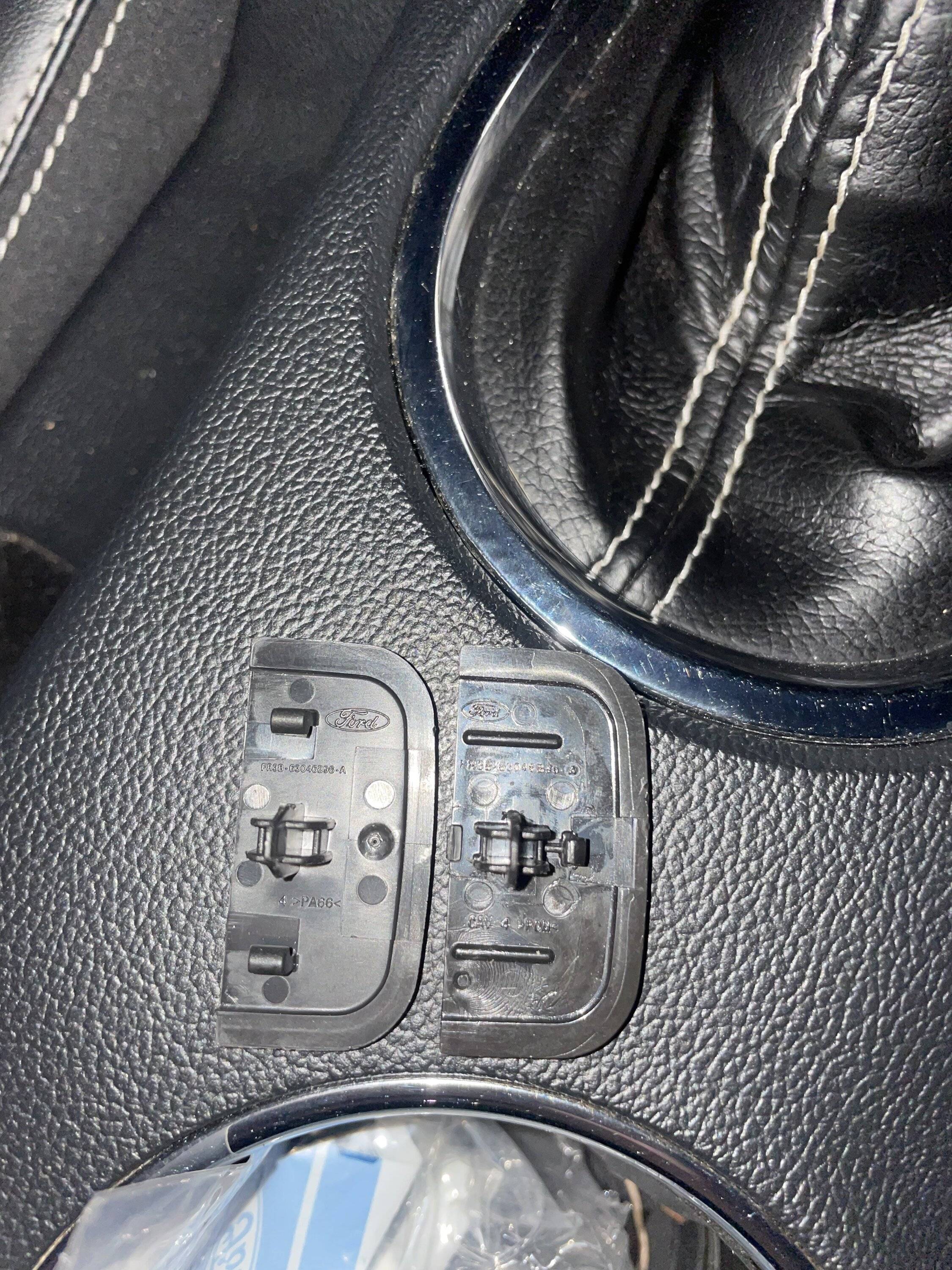

Hello. I'm trying to get a sun visor cap to cover the clip that holds the sun visor in place because I am missing one on the passenger side visor. However, the cap I got from the local Ford Dealer does not fit, as the hooks are in a different location on the cap.
First pic
on the left is the cap I ordered, and on the right is the cap that is on the driver side sun visor.
Both show part number FR3B-63046B96-A embossed into the part, however the part number on the packaging is FR3Z-63672A40-AC.

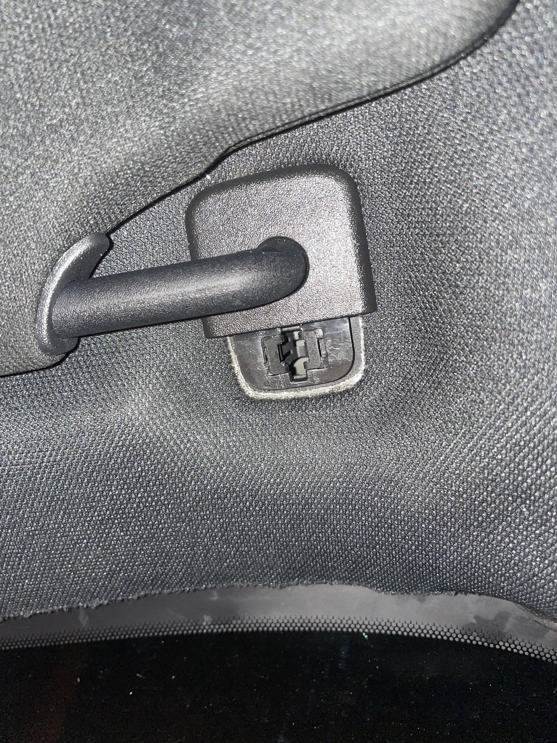

Second pic
This is where the cap goes into. The new cap will not work because those hooks collide with the plastic on the sun visor.
Looking online I can find three eBay listings for the FR3B-63046B96-A and then some foreign websites. No Ford Parts website shows that part number to exist on anything. Should I try my luck with the eBay parts? Any help is appreciated!

The cap on the right is the one that will fit in my 2015 GT.
Regarding FR3Z-63672A40-A*, I looked at the variations from A to D:
A and C give the part that I received today. B gives a track cap which is completely different. D gives the cap that would fit, but only Ford Parts Giant lists the item for sale.
Yes, I gave them my VIN while looking for this part. In person or online, using my VIN pulls up the cap that I received on the left. I'm going to try again at the dealer but give them the pictures I uploaded on here.

I talked to the Ford dealer and they did some research. Apparently in 18-19 they redesigned the sun visor, along with the clips. So I essentially am looking for an obsoleted part.
I'm definitely going to try those eBay listings I found earlier. Otherwise if I want to correct that issue, it'll be two new sun visors and hardware, costing around $500.

Unfortunately the cap you need is no longer serviced , it has been updated to a new visor and cap assembly ...
2 dealers near me show the updated cap , I had them look at them and they look like the one you have on the left , which will not work with the old visor ... If it was me I would grind or snap off those tabs and make it fit .

That is what I was told by my Dealer as well. If I need to I'll remove those clips and stick it on with double sided tape. But for now I'll try to source a couple of old style visor caps. I'ma make it work one way or another lol
