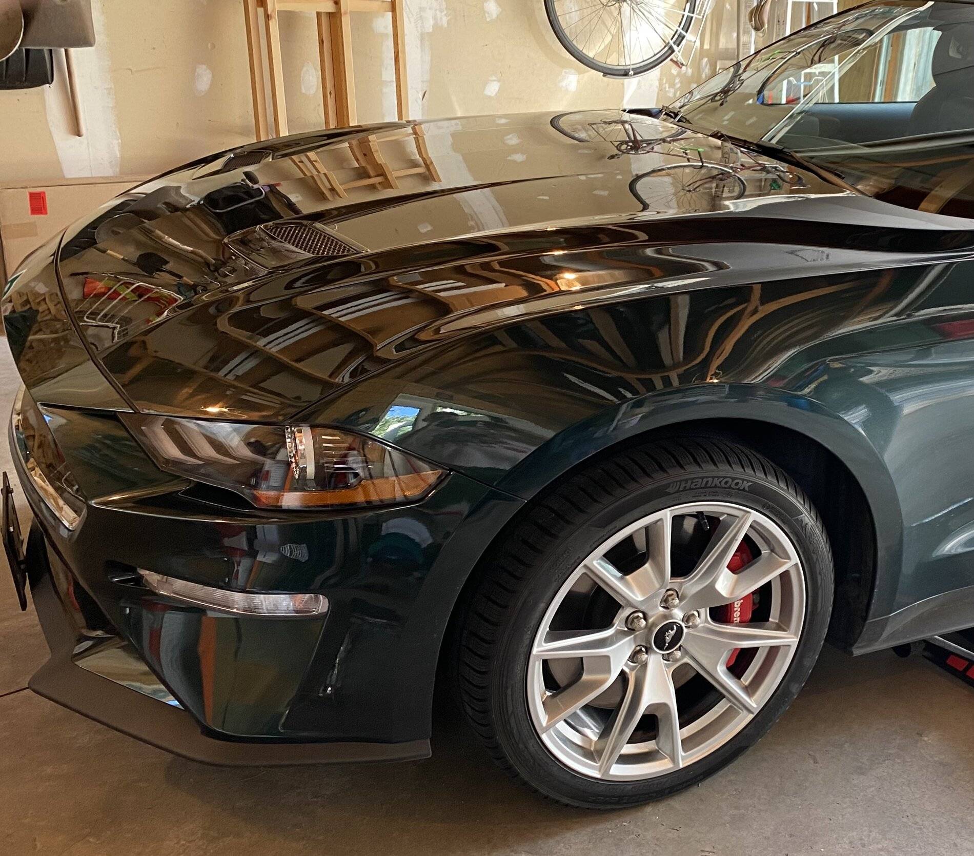

With cooler weather coming I put some winter tires on my car a couple of weeks ago, Hankook Winter icept evo2s. Cooler weather came and then a spell of some great warm weather soon after that.
And the tires were fine.
Nowhere near the grip of the PS4Ss, of course, but fine.
If I was going to drive to Florida tomorrow, I’d happily trade the loss of grip and slightly worse ride and noise while there for the security of driving on winters on the way down.
