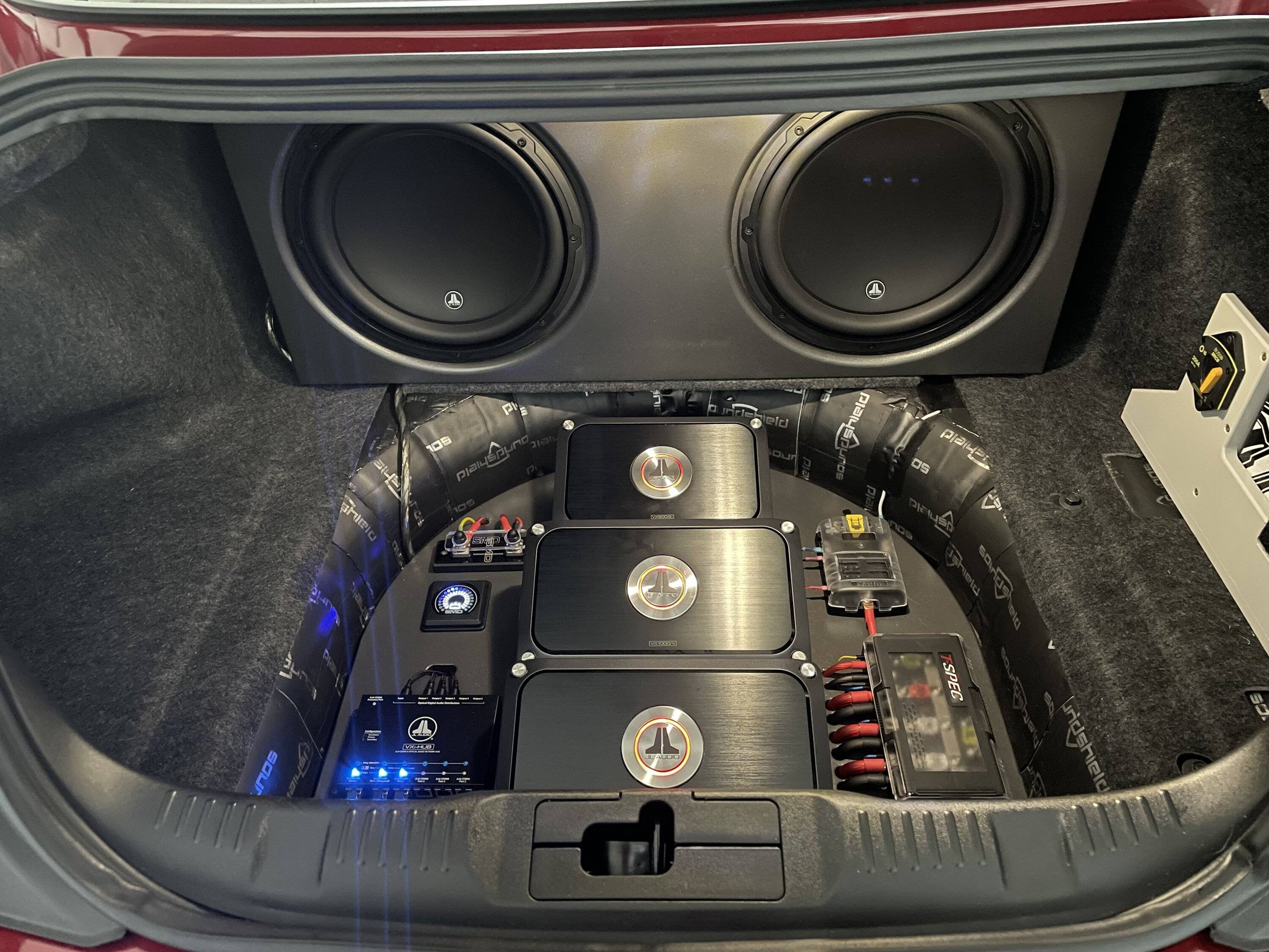

I did my own fabrication and install and it’s definitely not for everyone.
I’m assuming you don’t have the stock sub so you don’t have the B&O system? If this is the case then the Rockford Fosgate DSR-1 is most likely your best bet for tapping into your stock signal and creating a better starting point. This will allow you to run any aftermarket amps you want without having to do any splicing or wire cutting.
If you want a cheaper option you can tap into one of the stock signal wires and run them into a LOC or an amplifier with the ability to accept high and low level inputs.
Here is my setup, it’s two JL Audio 12w3v3-4 wired into 2 ohms to a JL Vx1000/1i monoblock amp. The other two VXi amps are running my woofers, mids, and tweeters.
