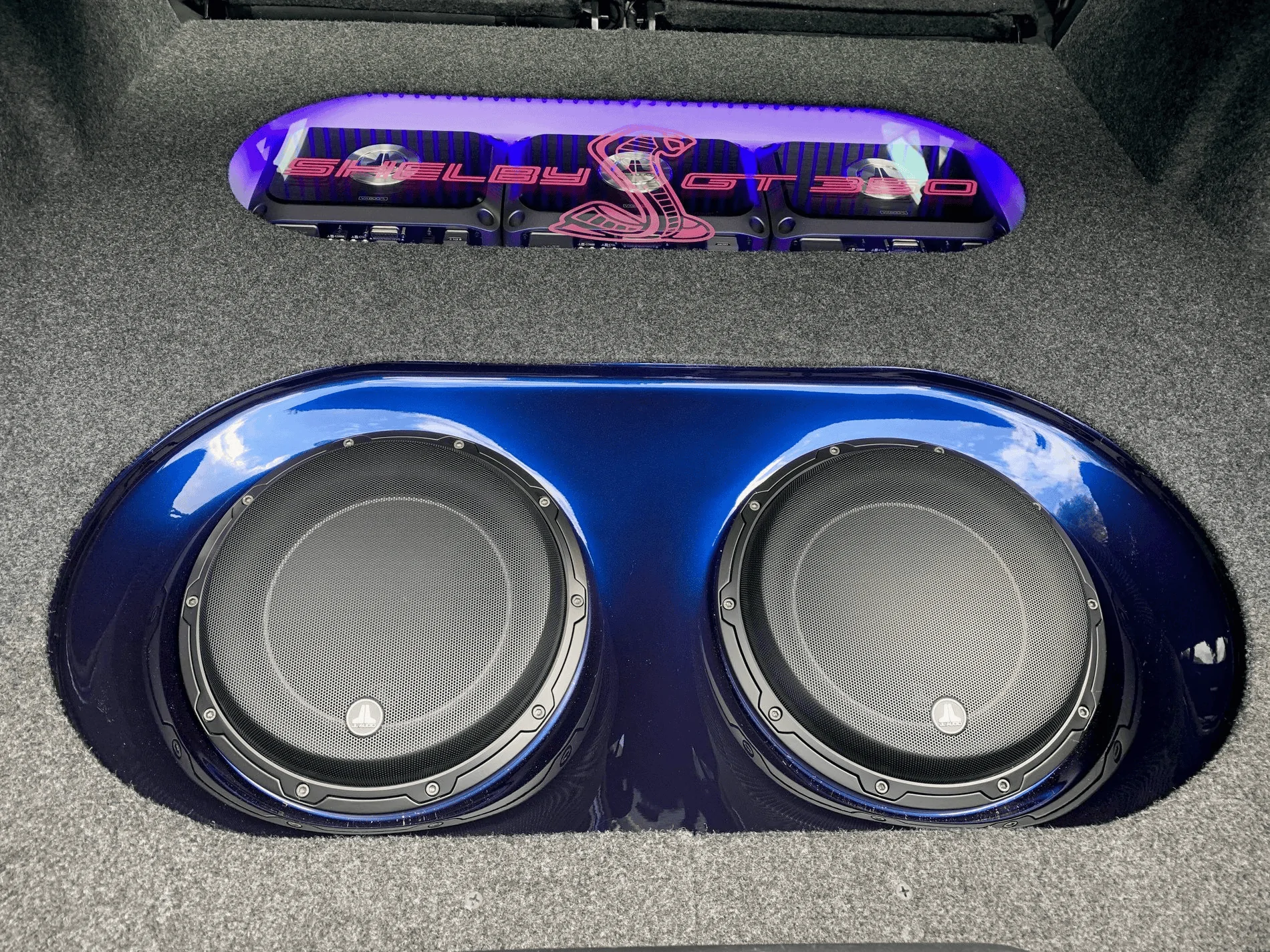

I’m not at all worried about trunk space, hence doing the sub wall.

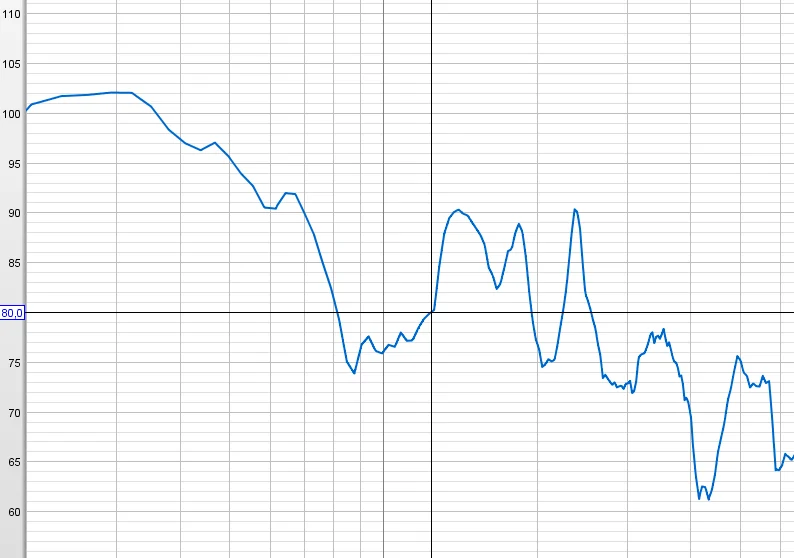

If reardward firing and box tucked behind the seat you get a deep dip between 80Hz and 120Hz.
Above response is a JL Audio 10w3v3 in a ported box rearward firing sitting directly behind the seats.

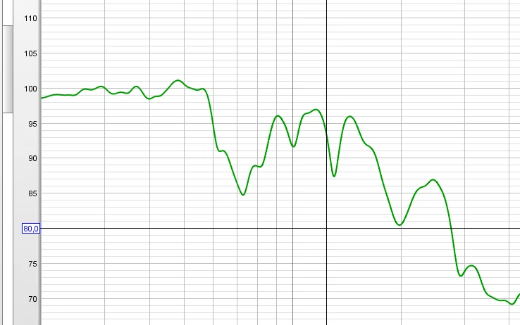

In the position where Ford puts the stock subwoofer i get the following response (JL 8w3v3 in stock enclosure).
A lot more midbass, but a dip between 60 and 80Hz, but otherwise perfectly flat between 20Hz and 60Hz.

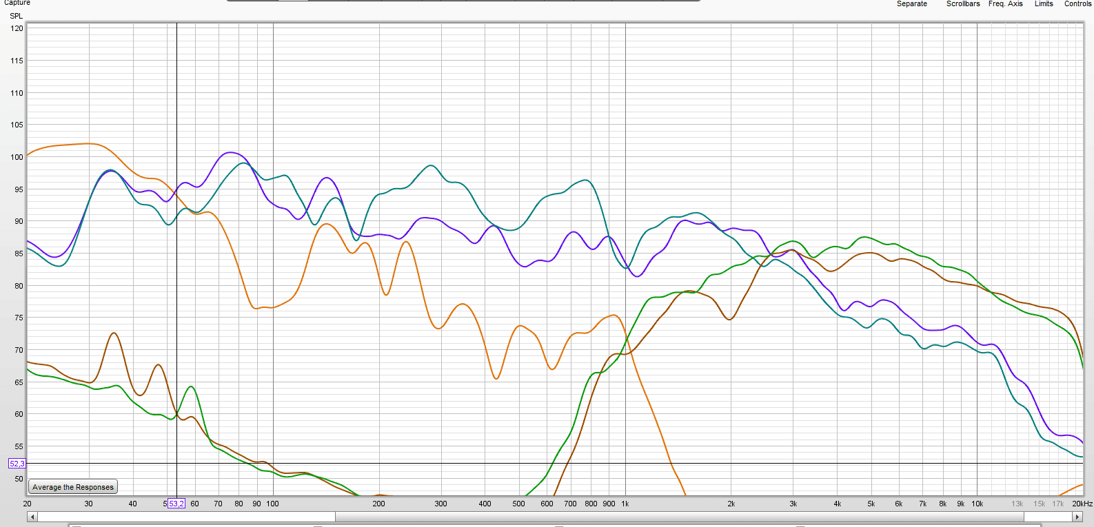

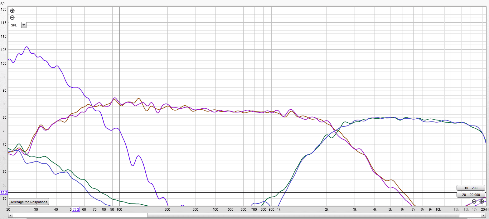

These are my before and after measurements of my system before and after setting up my DSP.
so please don't assume that i don't know what i'm talking about, ok?

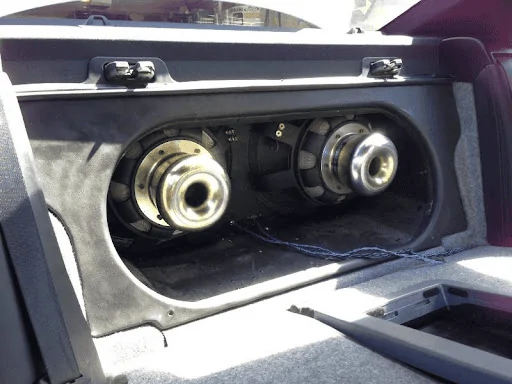

@Cathul is correct. I have basically the same measurements in my car with a huge null at 80hz. Ported sub behind seat facing the rear. Having a sub at the trunk opening is not practical for obvious reasons and I didn't want a spendy JL stealthbox.
If I were to do the sub install over again, I would go infinite baffle on an angled board and have the subs magnets pointing toward the rear seats. Bass passing through the open holes in the rear deck because I don't like driving with the rear seats down. Like this but the drivers flipped around to save trunk space:
I have my mid-bass drivers helping fill the hole at 80hz and it sounds good. But I know it can sound better with a different sub arrangement.
