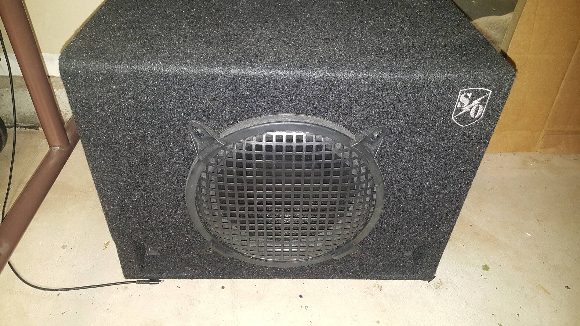

Since I bought the AF set-up, I bought a 10" HSU driver on clearance ($40) from Parts Express and a ported Sound Ordinace box that I use for my garage's 2.1 system and its impressive for what I have spent (<$150 excluding amp). I will run some A/B comparisons between it and my AF once I get my install done.
