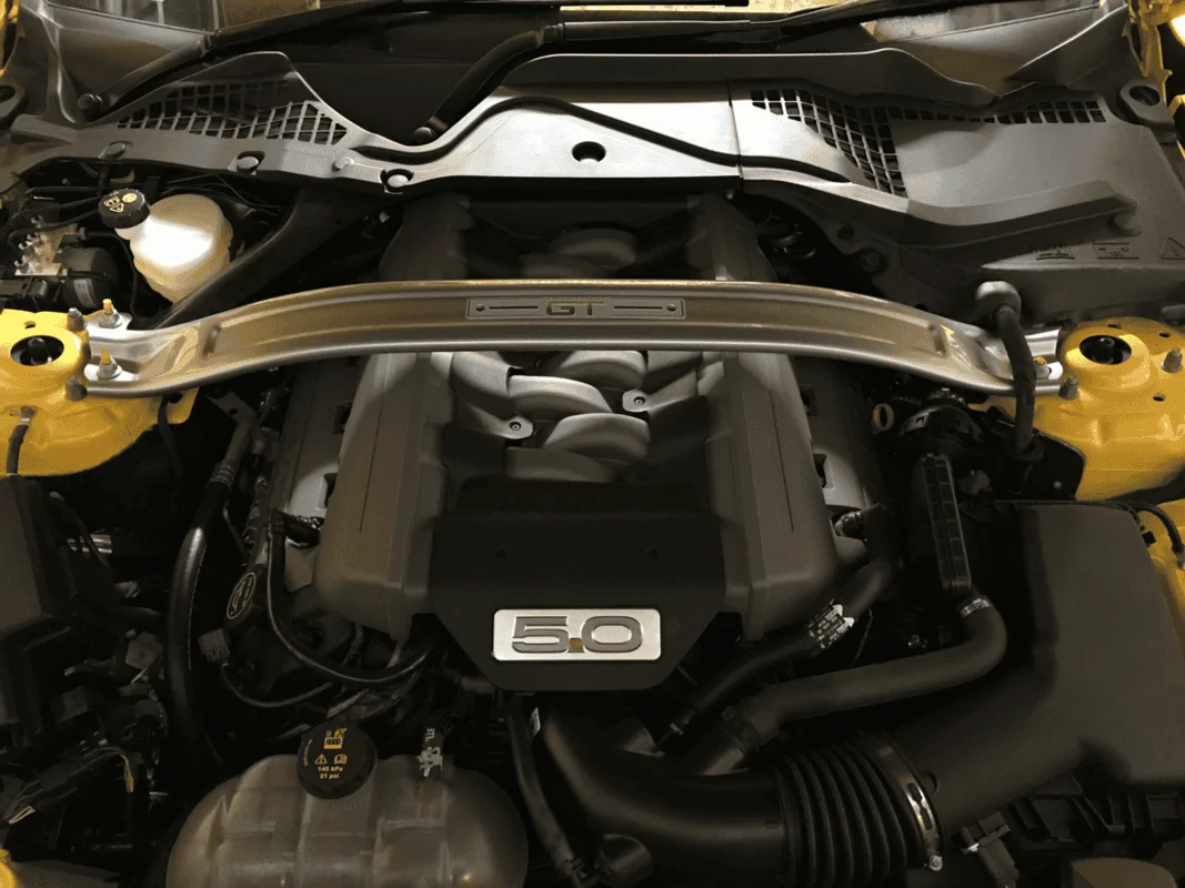

you have to shim them all to work on RHD models but its just a couple of washers or an impact driver on the nut to bend one of the tabs of the brace.
the gt350R brace is alu not steel so is considerably lighter its also more expensive because of that.

You will need washers/spacer to fit with the k-brace we have or can be ground to fit with grinder.

The yank cars don't come with the K brace as factory standard they come with a strut brace instead so you have to grind a little off the back tab of the s trut brace so it sits flush with tower and kbrace fitted. or remove the kbrace. or shim up the other holes to raise the entire brace to the level of the kbrace.

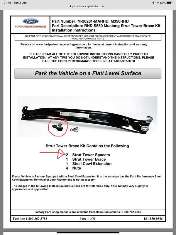

The RHD specific ones from Ford UK are supposed to bolt straight in without modification.
i'm pretty sure there are no rhd specific ones its just the lhd one with a couple of washers in the pack.

2017 GT - TripleYellow \ Black stripes
Yup - well spacers rather than washers. Did search to see it if available standalone but to no avail
