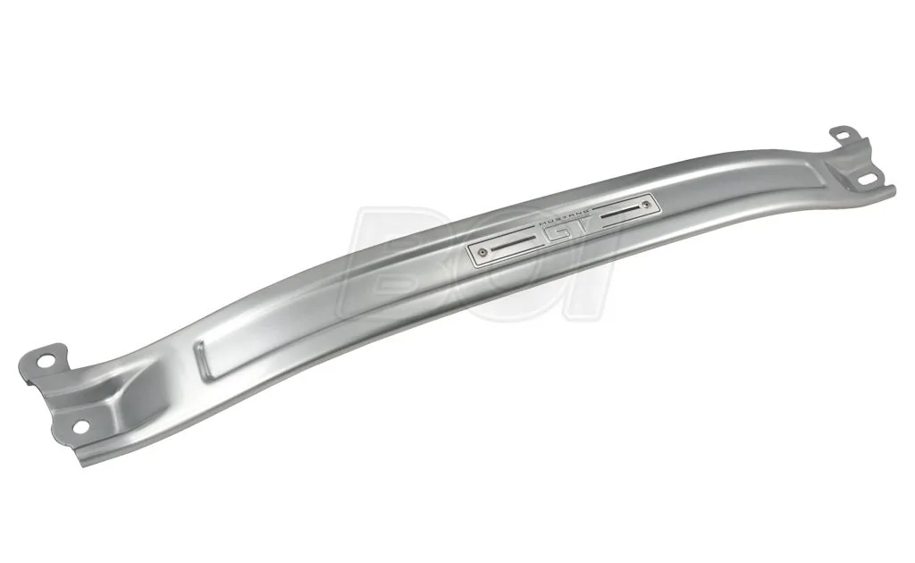

I've seen 2 posts about that brace; one saying it DOES fit and the other saying it DOESN'T! :lol:

I have fitted the ford racing one I got from usa and it fit straight on
looks good too
I've bought the ford racing one as well (M-20201-M) to fit the GT and Ecoboost, but I don't have a mustang to try it on yet. Would you be able to take a few photos showing how the tower brace fits around the RHD K brace?

This is the size of the area that would need taking out/grinding down to clear the K-brace, basically one quarter of that connection:
That's a great pic, thanks. It does look from that, as if the OEM GT brace might fit. [MENTION=12268]mkforks[/MENTION] can you help with a pic of yours?

Here's my STB from Schropp in Germany. I didn't take any pics from underneath but the parts that go over the towers are milled to accomodate for the K-brace perfectly.

That^. ;)
I did see that brace on the other thread but as Slow has pointed out; it fits LHD perfectly as does the Steeda one.
For some reason the K-brace on our RHD cars is a bit different to the LHD ones. :(

None, for the strut brace.
The Steeda strut brace sits on top of the K-brace thereby leaving a gap between it and the car where the K-brace doesn't continue as far as the strut brace. The spacers are purely to fill that gap and since they're made of delrin are quite up to the job.
That said, I do like the engineering on that Schropp brace.

Back on topic, I'll get my FRPP strut modified like in the Oz thread, to fit. There's enough 'beef' on that to cope with any stress after modifying.
