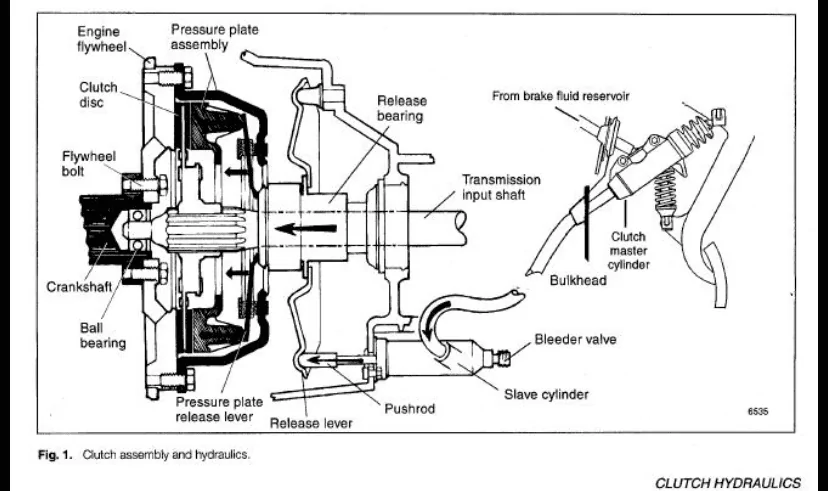

Or we could call it a hydraulic throwout bearing. That’s why I related the two, since both are terms used often on here.
Didn’t realize they were integrated together as one unit. How do you bleed that thing?
The original Ford part is “self bleeding” and as Vlad said requires some fancy footwork to eventually bleed the air from the line and build pressure.
Exedy states theirs can be bench bled to jumpstart the process. A few other manufacturers make them, but I’m not sure if they’re able to be bench bled.

Interesting. This is what I’m used to working on.
Yeah, pretty standard. That’s how the T-45 looks in my old GT.
The MT-82 slave/TOB is fixed in place by two bolts and rides on the input shaft. There’s no release arm/lever since it’s actuated hydraulically.
