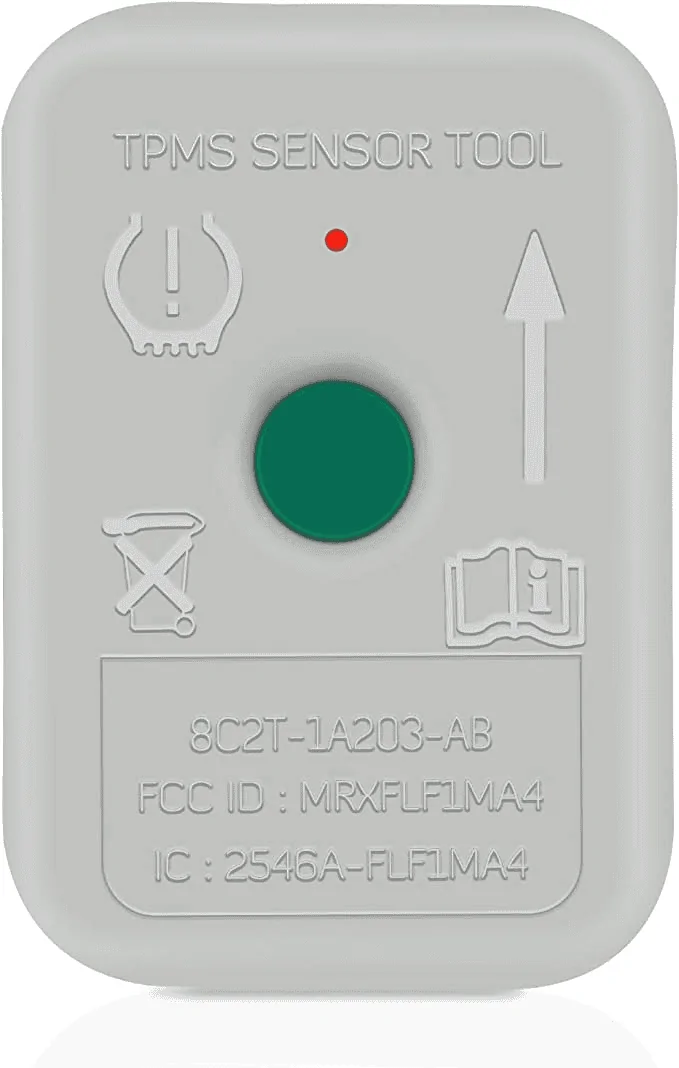

I have two sets of wheels and tires. I've been swapping them twice a year for over 5 years every spring and fall (summer and winter tires). I've never had a problem with the car recognizing the different TPMS sensors each swap. This fall, the car failed to recognize all four of my original TPMS sensors. I just used the 12 dollar tool from Amazon below and my sensors are working like champs again.
So I guess we do need this tool once the sensors start aging.
Glad to hear you got things working. IMO, it's a sign the internal TPMS sensor batteries, being five YO, are on their way out. Next season or tire change, I'd consider replacing the sensors.
