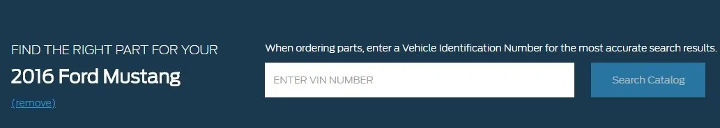

The Amazon kit (TPMS35) worked perfectly in my 2016 GT and no tool was needed. I recommend going to Ford's parts site and input your car's VIN. It will show the appropriate part number. There are different sensors depending on build date and other factors even for the same model year.

Got a link for the Ford site that will display part numbers by VIN?

I went Levittown put vin in and shows two part #'s for my s550. Waiting for Levittown to get back to me. Either I have a defective set or part # goes by vin.

What a joke. You put he vehicle vin in and it gives you three different TPMS part #'s for the 2016 S550. I'll wait to hear back from Benny at Levittown.
