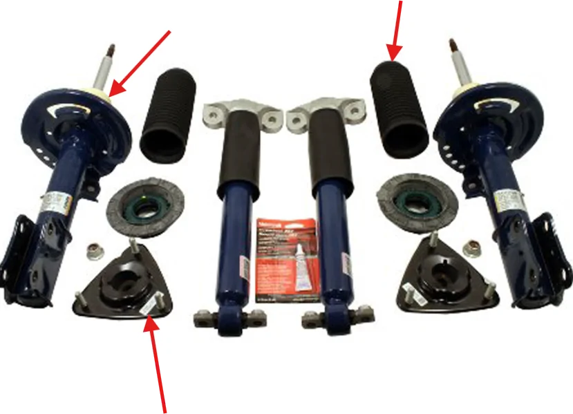

Steeda Springs work with all brands of strut/ shock.
The Ford Performance Track Kit comes with everything you need(bump stops, dust boots, top , mounts.)
Camber plates are recommended but you can alternatively use camber bolts if it is only a street/daily. Camber bolts are not recommended for sport driving (auto cross, HPDE, endurance)

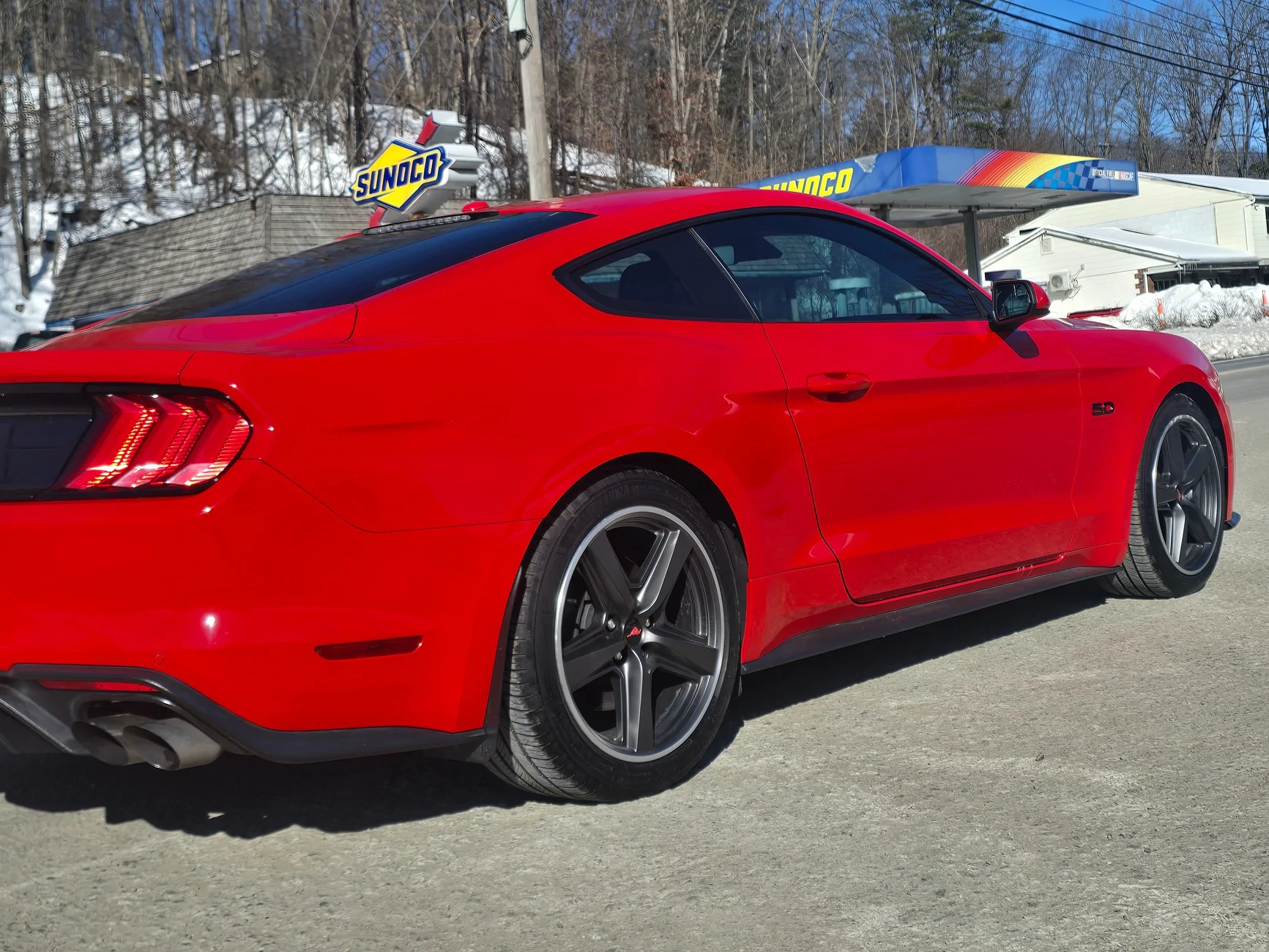

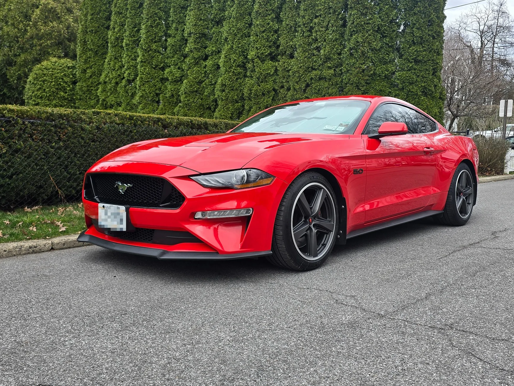

I got the ford performance track shocks and struts with ford performance street lowering springs and the car rides amazing. I have a 19 pp1 car and this is exactly what ford should have done from the factory. The car actually rides alot smoother and handles great. Im sure steeda parts are great also every other suspension product i have on my car is from steeda but I can only speak to what I have and I cant recommend the ford performance parts enough. Best of luck

have any pictures of the fitment and your tire setup
