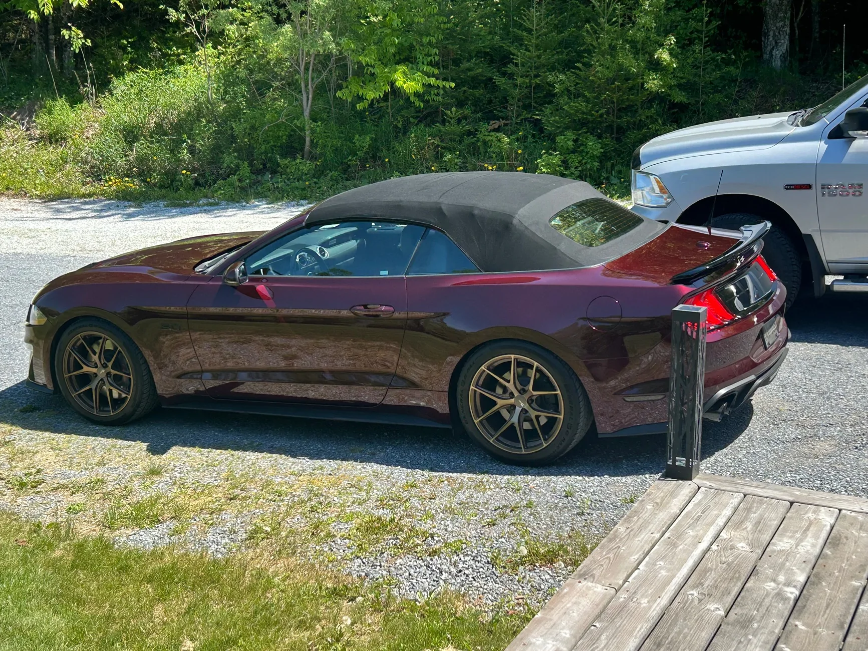

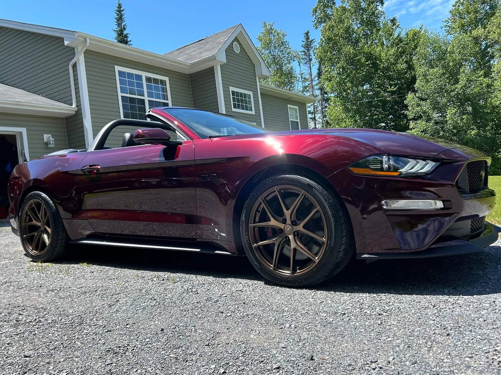

I am running their Progressive springs with the pro-active (555-8423) non adjustable shocks and struts. I did use camber plates to dial in the alignment. But ride quality is as good or better than my factory PP1 springs and shocks. Wheel gap is just where it needs to be with 19” wheels. Roof up is after roof down is before

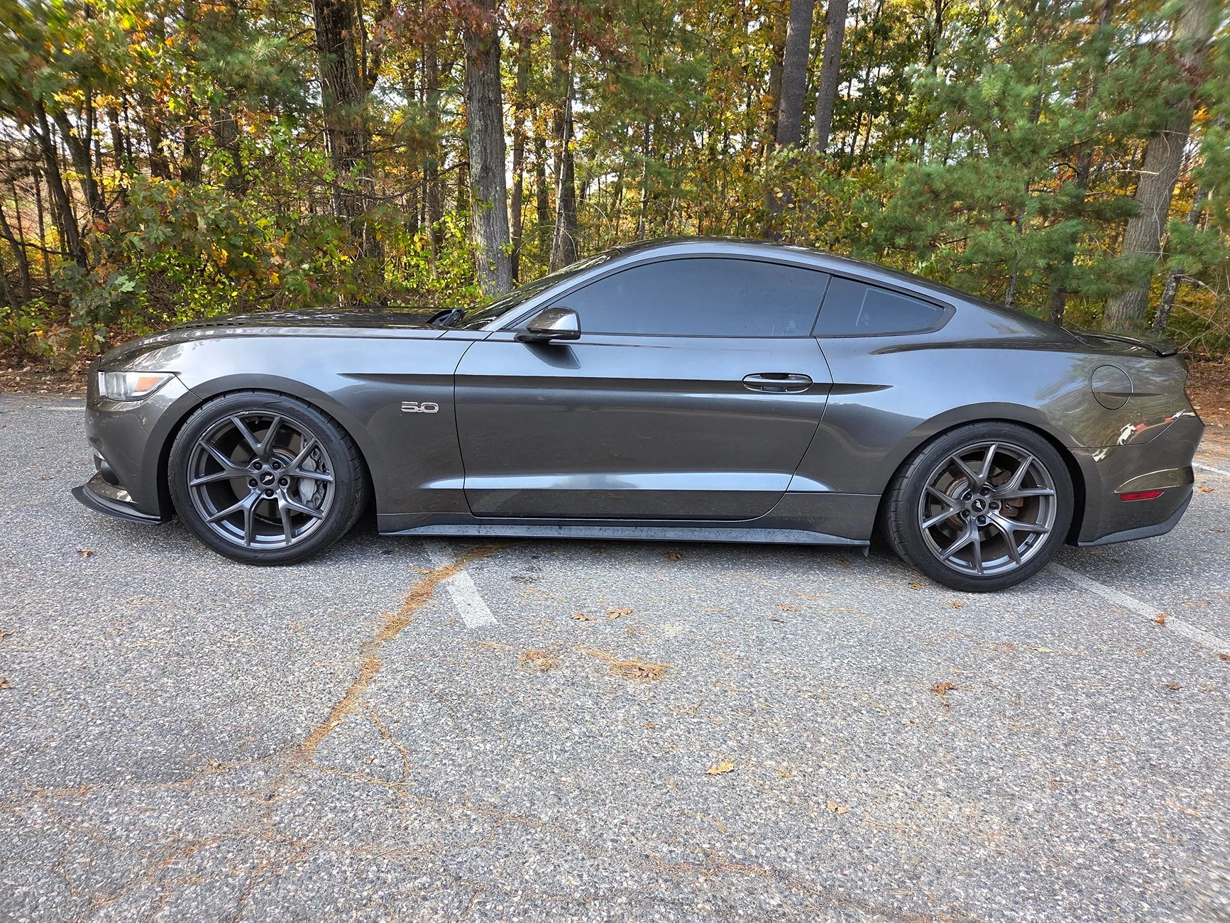

I paired the steeda ultralite linear springs with the Ford track struts. Ride quality is definitely stiffer than stock, but not bouncy or sloppy. The car feels very tight in a good way. I had BMR and stock struts previously and this setup is drastically more stable.
Also ride height is perfect imo.

I have a whole bunch of suspension work on the car so its definitely stiffer than just with the struts and springs. But overall I would say that you would definitely be able to daily the car. I dont daily this car, but you could.
These are SP2 reps 10" front and 11" rear. All four tires are nitto NT555. G2. Fronts are 295/35r19 rears are 305/35r19. I also have 5mm spacers all around but idk if these were necessary. I had them from a previous setup and just left them on.
No camber plates or anything so far. But i do have the steeda adjustable rear camber arm I just need to put it on.

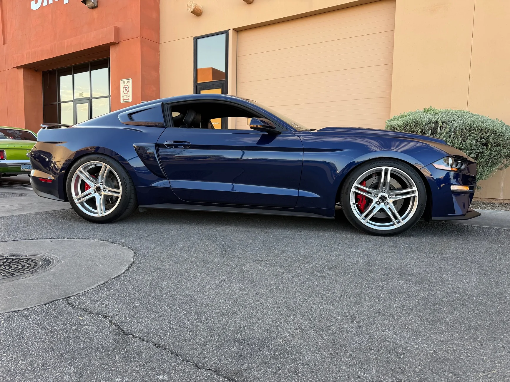

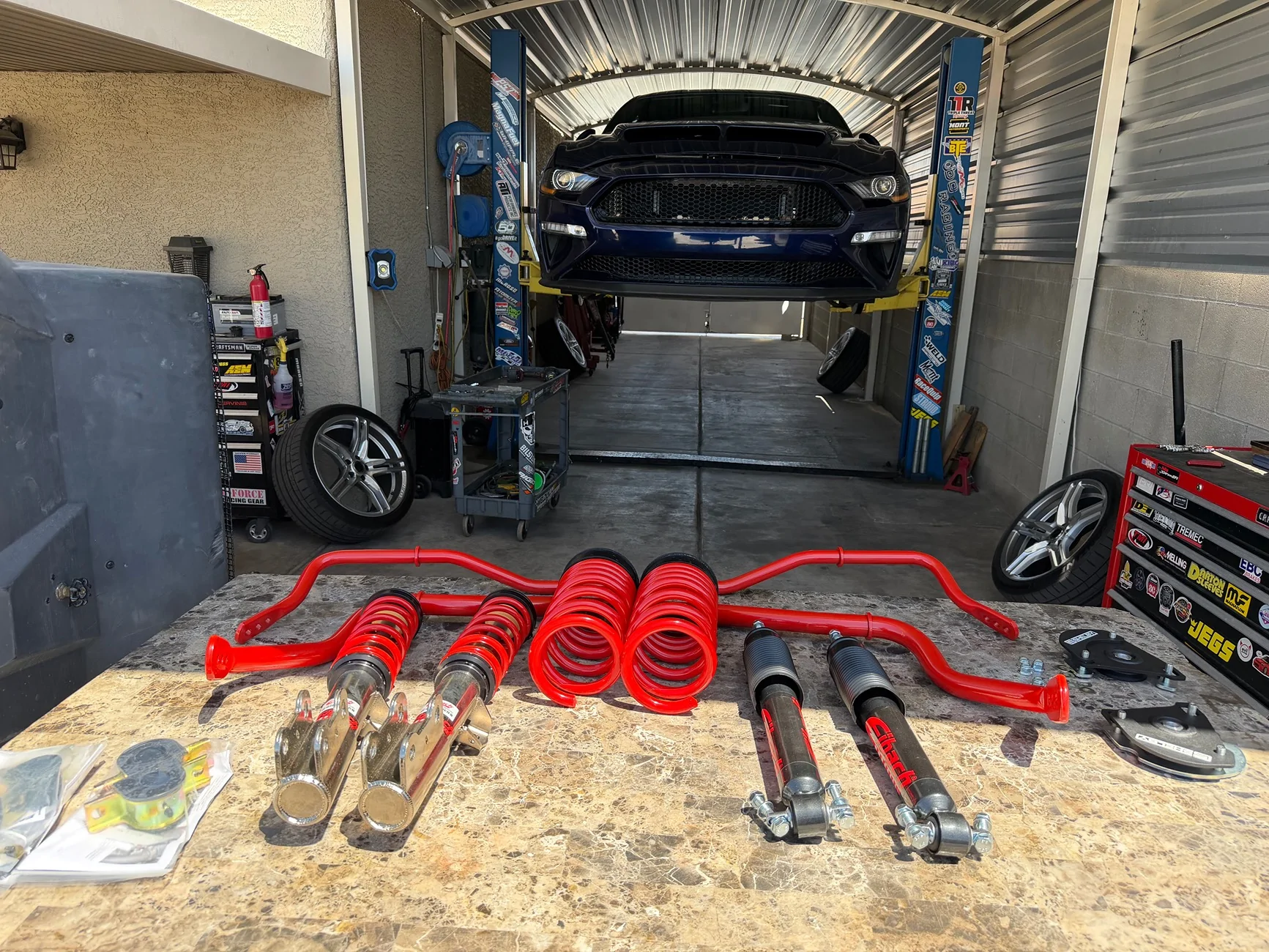

I put on Eibach coil over shocks, lowering springs and their front and rear sway bars.
I have 20" rims 305/35s on rear 275/35s in front- zero rub!
