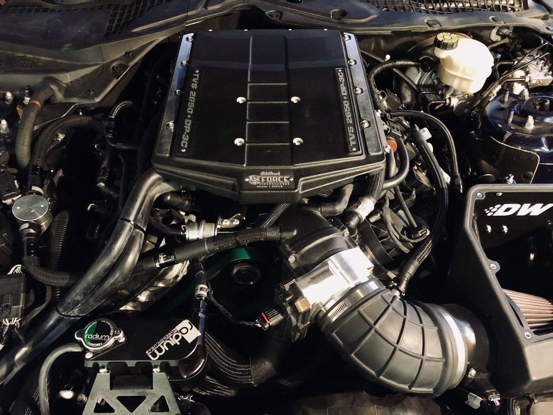

I'm boosted tvs2650 Edelbrock. Manual, 3.55, on 285 rears. I don't plan on drag racing it. I see there's a wide range of causes just from these few responses. For the guy with 300 passes on stock that gives me more confidence I'll keep mine stock for now.

I'm running an Edelbrock on 12psi and e85, if you don't ever launch the car the half shafts will be fine, they handle rolls, they just won't like launching from a dig on a surface that hooks. Also the guy with 400 passes looks to have a 6r80, those rarely break half shafts, the 10r80 snap them a lot easier, especially in 1st gear
