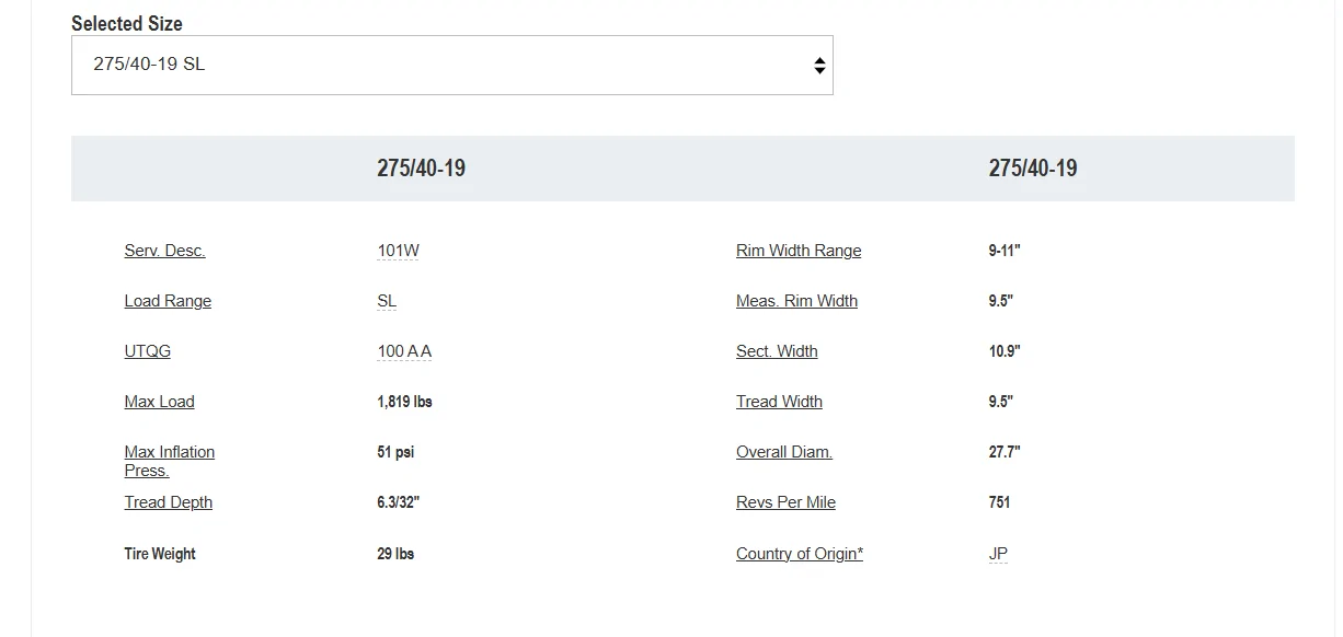

OEM tire 255/40 which is where I want to be. The Nitto 555 R2 is a 275 and they recommend a 10" wheel........I want to avoid tire bulge related downsides.

Sooo this is one of those very rare situations, where I'd actually run a tire that is too wide for the wheel just for grip. because I know the tire well and its a huge step up from the other options. I'd run the Yoke A052 in 265/40R19 (versus the very short 255/35R19).
A052 is worth some tradeoffs. Its going to feel pretty squirmy in corners because its soft in general, and because its pinched on an 8.5, but its going to stick, the linear grip from it is pretty insane.
because its not a standard fit and the tire is too wide (by the chart) for the wheel, you'll need to find a smaller shop which isn't run by lawyers and computers to mount it for you. Its not THAT insane, I ran 285s on 9" fronts, but they just don't make the perfect tire in that size.
