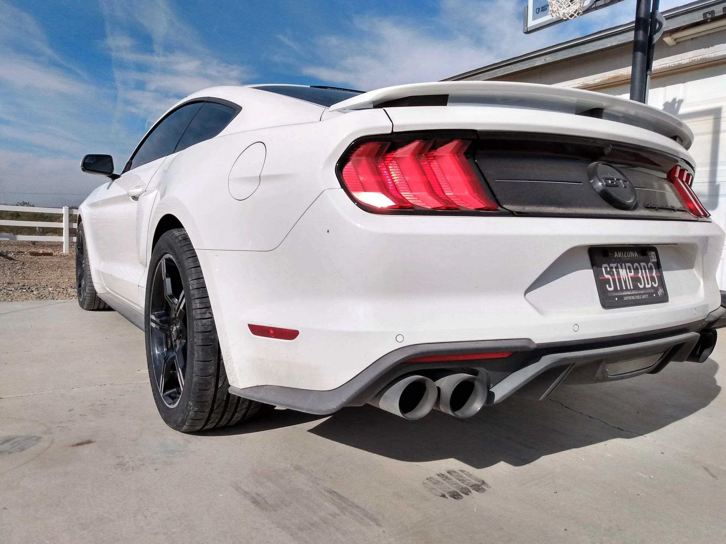

I think the stock 255/40/19s looked a little stretched on my 8.5" wide wheels. I smoked the rears off and have been running a set of 275/40/19s on the rear and they look a little big so next set up will be 265/40/19s (MICHELIN PILOT SPORT ALL SEASON 4) all the way around so I can rotate all 4 again. I'll see if I still have the pics and update. And I am running 1" wheel spacers all the way around. You said you want the grippiest tires, then look for the treadwear rating number the lower the better. Drag radials will usually be a 100 or lower, the Michelins I'm getting are a 540 those aren't as grippy but will last longer.
Not at all stretched. An 8.5" wheel is the minimum for a 255/40/19.
You're right Dave,
That set-up actually looks a bit pokey in the rear to me and probably isn't optimal for performance.
