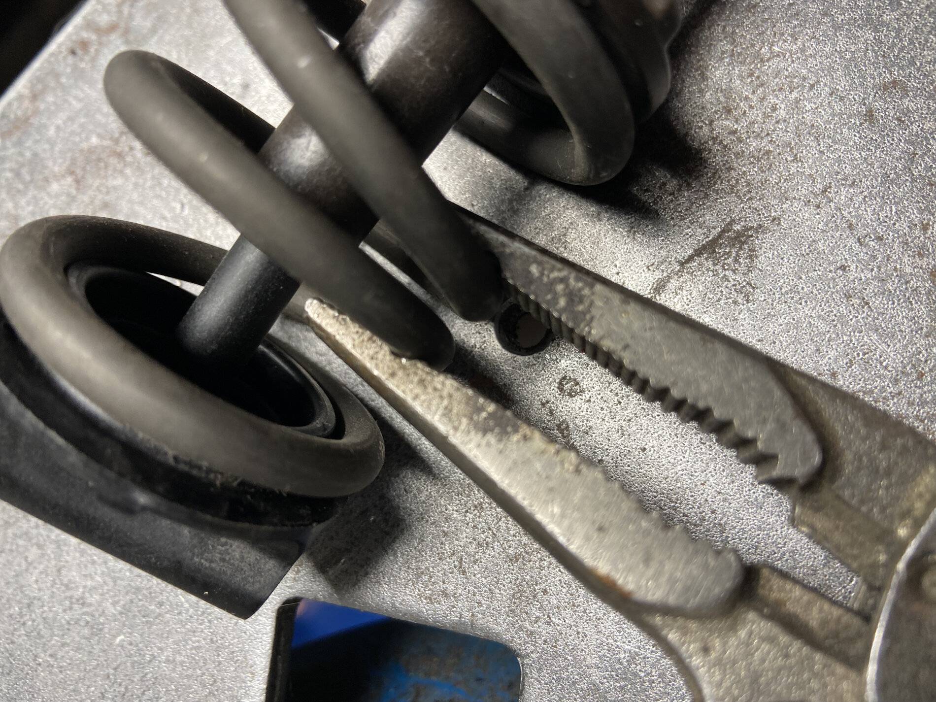

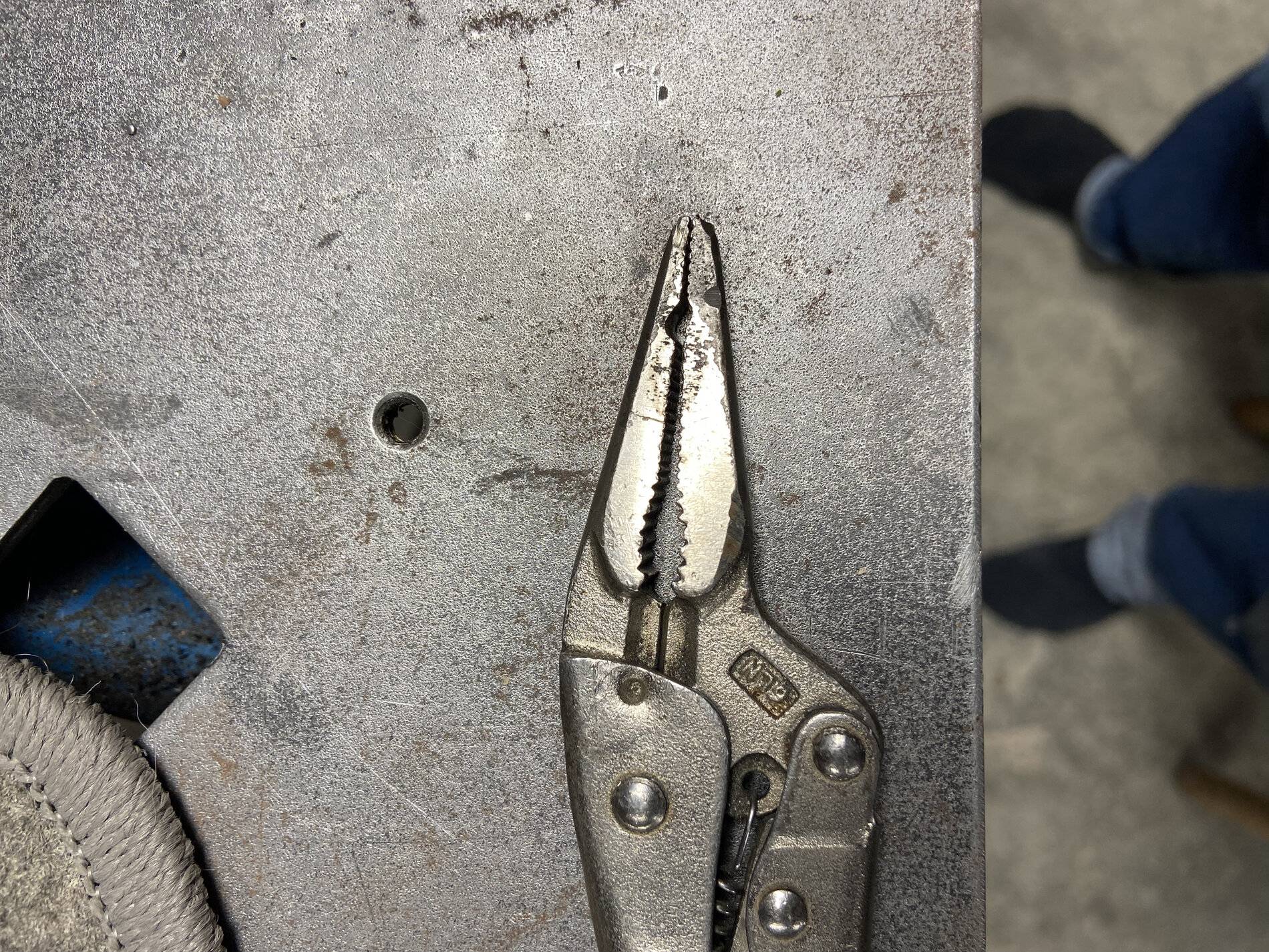

That sounds like it has a factory return spring. It's not sticking the spring has a quirky spring tension rate. Do not remove it replace it, Steeda return spring will solve that.
ttps://www.steeda.com/steeda-mustang-clutch-assist-spring-perch-upgrade-kit-555-7024.html
Do yourself a favor, harbor freight pliers, cut a notch in the tip.
Holding the spring, will really make the install easy.
