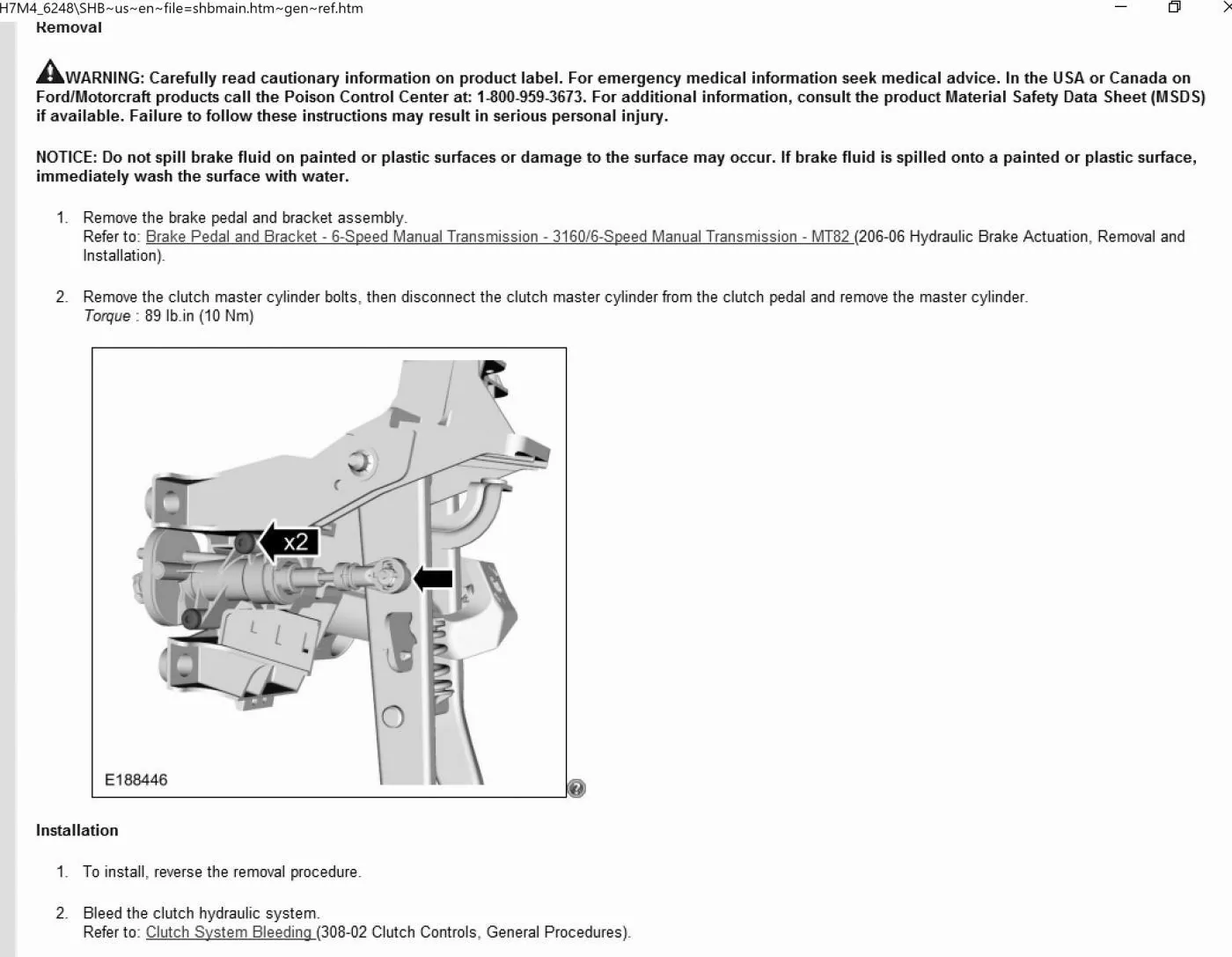

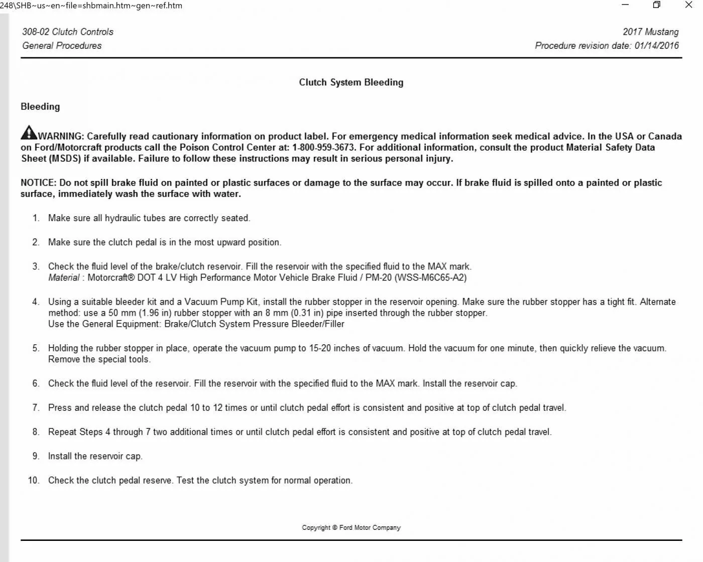

When I swapped transmissions I bled using the factory instructions and it worked fine. The toughest part was making up a rubber stopper to fit the master cylinder. When you pull a vacuum the air bubbles come out of the system. The vacuum helps the air rise because gasses expand with low pressure. When the gas expands the relative difference in density between the brake fluid and the gas increases. This helps the air bubbles to rise out of the system.

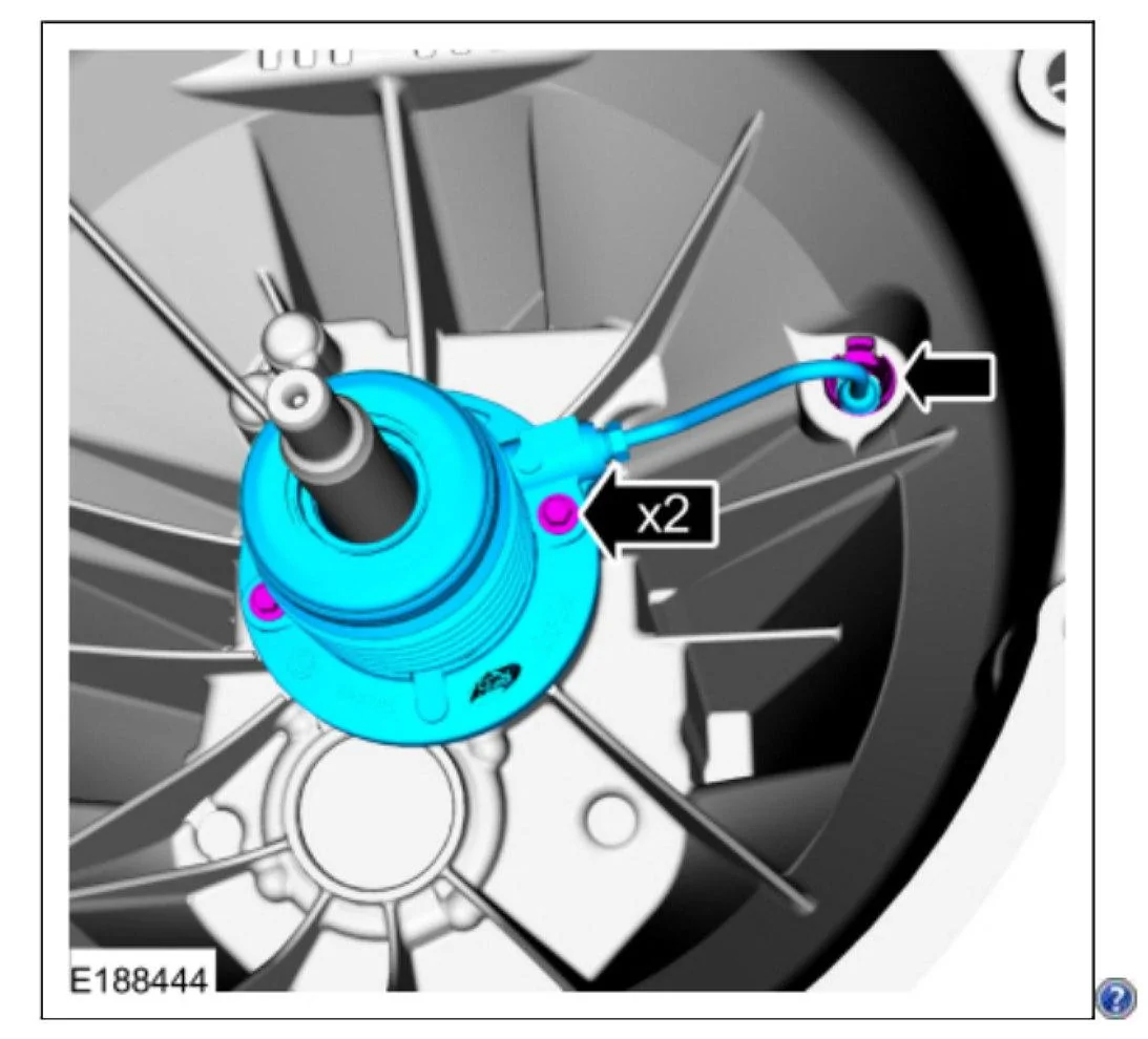

There is no bleeder on the slave built into throwout bearing.
It's too bad that they didn't include a bleeder in the throwout bearing.... On some earlier models of Tremec T6060's (mostly chevy's), had a bleeder..... you were able to install a remote speed clutch bleeder. A brief description:
Hinson Motorsports remote clutch speed bleeders turn a once difficult process into a simple one man job! Clearing your hydraulic system of trapped air takes only minutes with these braided stainless steel lines. Just attach the 4 ft. bleeder hose to your slave cylinder, and zip tie it permanently to any area you can easily reach. Then crack open the bleeder end fitting once when needed, and close it when the air is released from the clutch system.
Also, I was able to install a small dedicated reservoir for just the clutch fluid.
.. I didn't want to share the main reservoir above the master brake cylinder.
