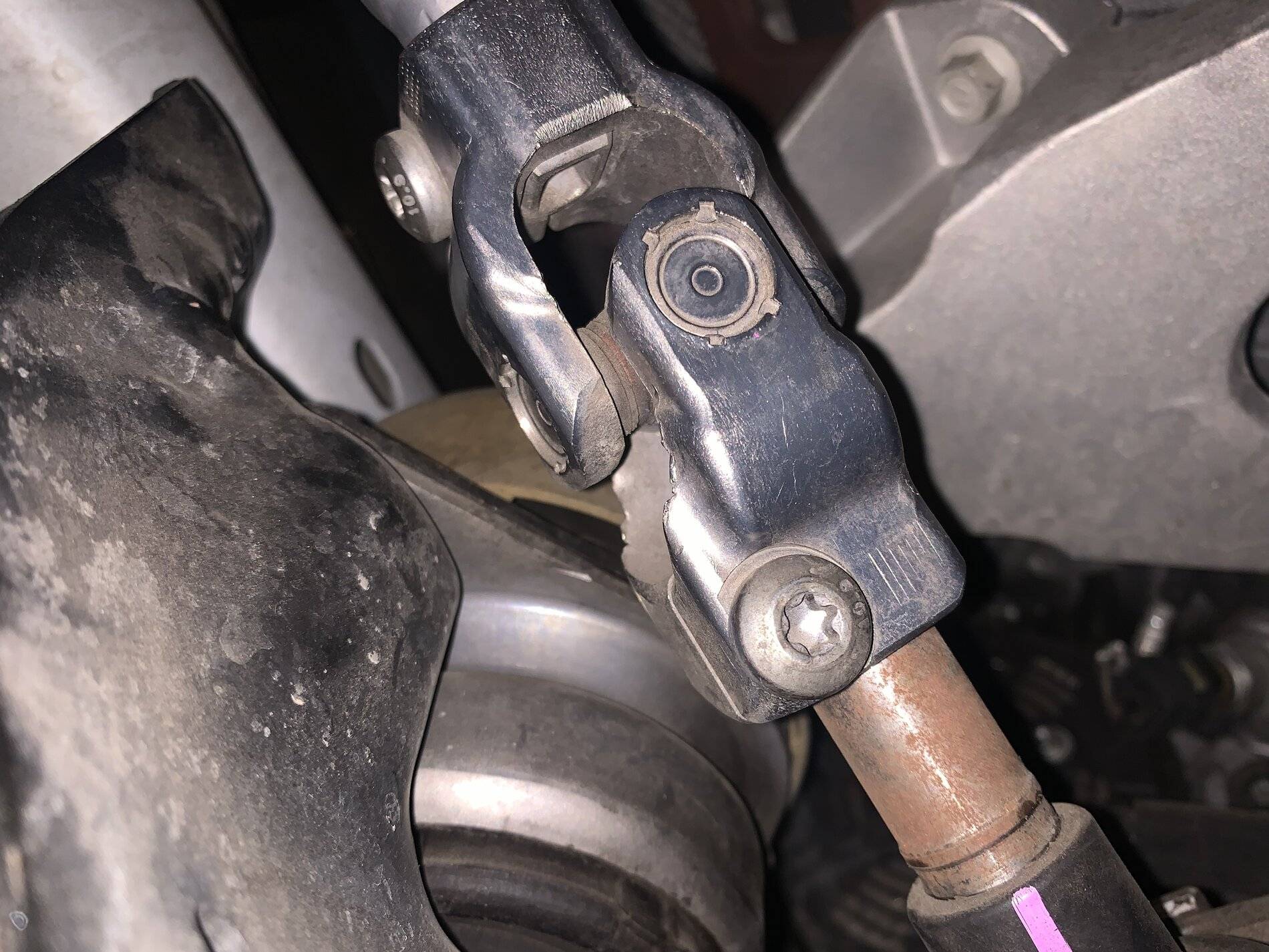

I had taken it to a shop and they checked all my suspension components and said there was nothing out of the ordinary. All bushings and tie rods were good. I had gotten new tires mounted and alignment done. They test drove it and could feel the issue in the steering but said they couldn’t pin point why. So my automatic assumption was the electric steering, I assumed maybe something was loose so when I checked I had wiggle in the pinion like in your video.

One thing to note is my yoke did seem to have damage like something hit it but I’m not sure what or how it happened

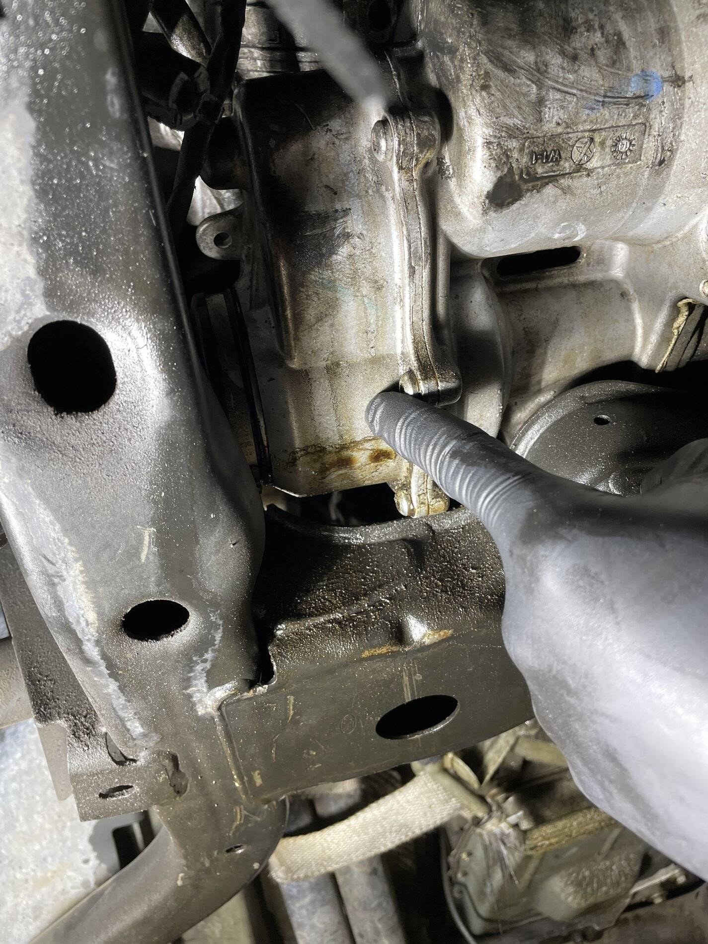

I have been chasing down a clunking noise at low speed when turning. Fairly new Steeda tension links with bearing and lateral links, Steeda bumpsteer and camber plates with new spring seat and bearing. I checked over everything and all are good.
I finally put it on jack stands and moved the steering shaft.. it definitely has play and makes the sound very very similar to what I hear when driving. Car has 58k on it and not very happy that something like this would fail, I don’t track the car or put hard miles on it. The removal and installation doesn’t seem to be hard but what about programming? Can this be done using forescan? Can I swap my current epsc module on to the new rack? Trying to figure out the most cost effective way because dealership prices are insane and a new rack is $1100 after the core charge. Thanks in advance
