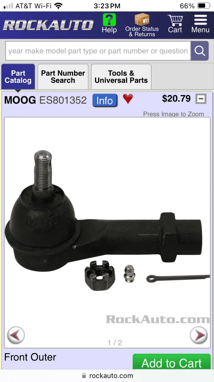

id replace the outer tie rod ends first. much easier and cheaper.
i used these
I replaced the inner and outer tie rods. It is the rod that sticks out of the rack that connects to the steering shaft. I got under neath the car and placed my hand on the lower shaft and rotated it back in forth and I was hearing noise from the steering rack
