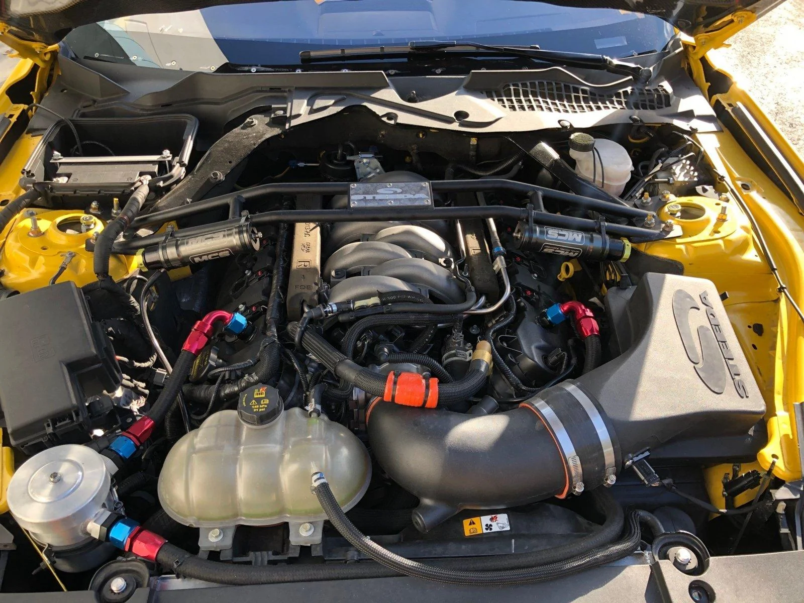

Regarding the stock engine in the Q500r. What rpms do you take the stock gen 1 s550 to with the GT350 intake manifold. Any concern/issues with the valve springs, pistons and oil pressure?

What rpms do you guys rev the stock gen 1 S550 coyote too? If you get above 7800rpm, any concerns/issues with valve float, oil pressure, fuel pressure and any concerns with the stock pistons and those oil squirters?
We rev the engine to 8000 rpms production stock engine no issues at all. This winter we will freshen her up,will keep everyone posted with the changes.

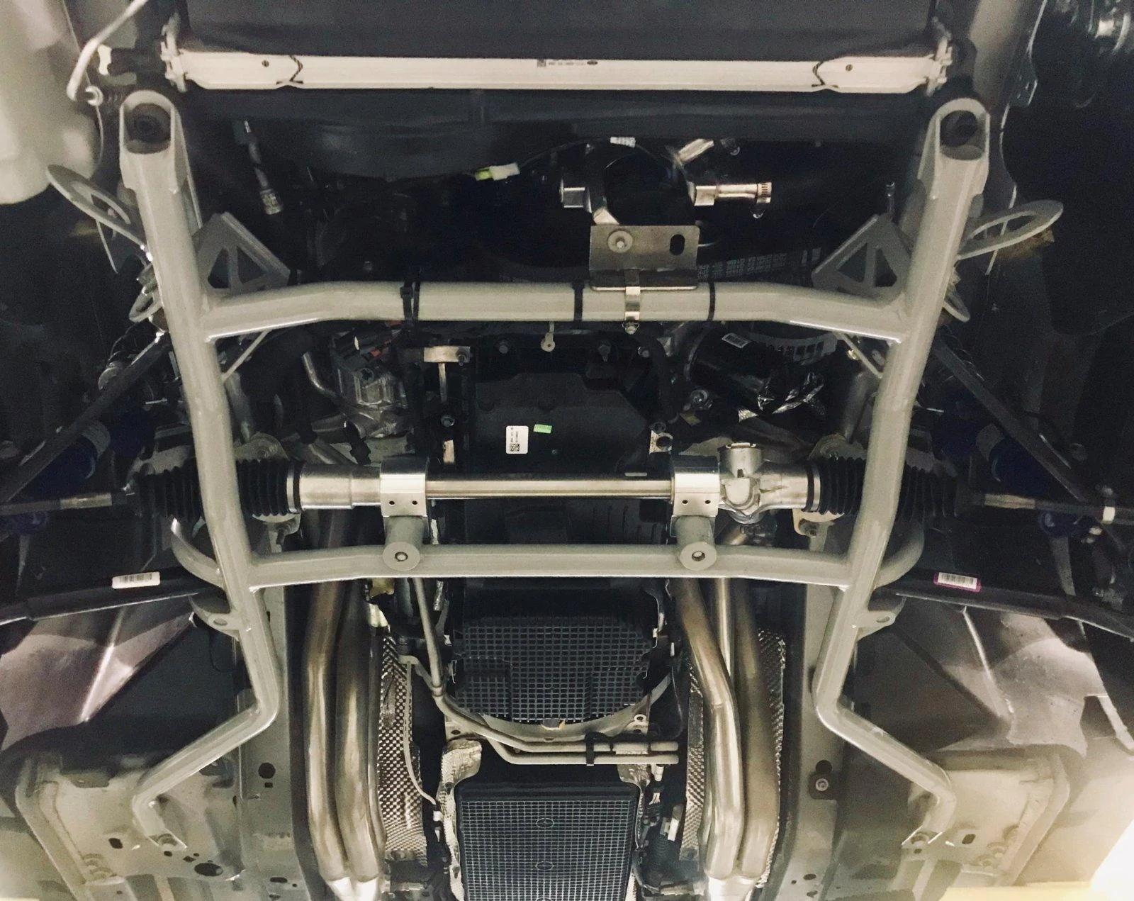

New Road Race K-Member to be released first quarter of 2019

I need this in my life. Can you share the details of it? Will it work with stock steering components and how much weight does it save?
wildcatgoal
@sirboom_photography
Feb 8, 2016
76
6,589
2,513
TBD
Is it "stronger" than the factory setup and thus are the two forward bracing options (2 and 4 point) unnecessary?
Can it be powdercoated in another color (i.e., endlessly thick and rock resistant gloss black). :)
Does installing one of these mean you no longer have "factory pickup points"?
