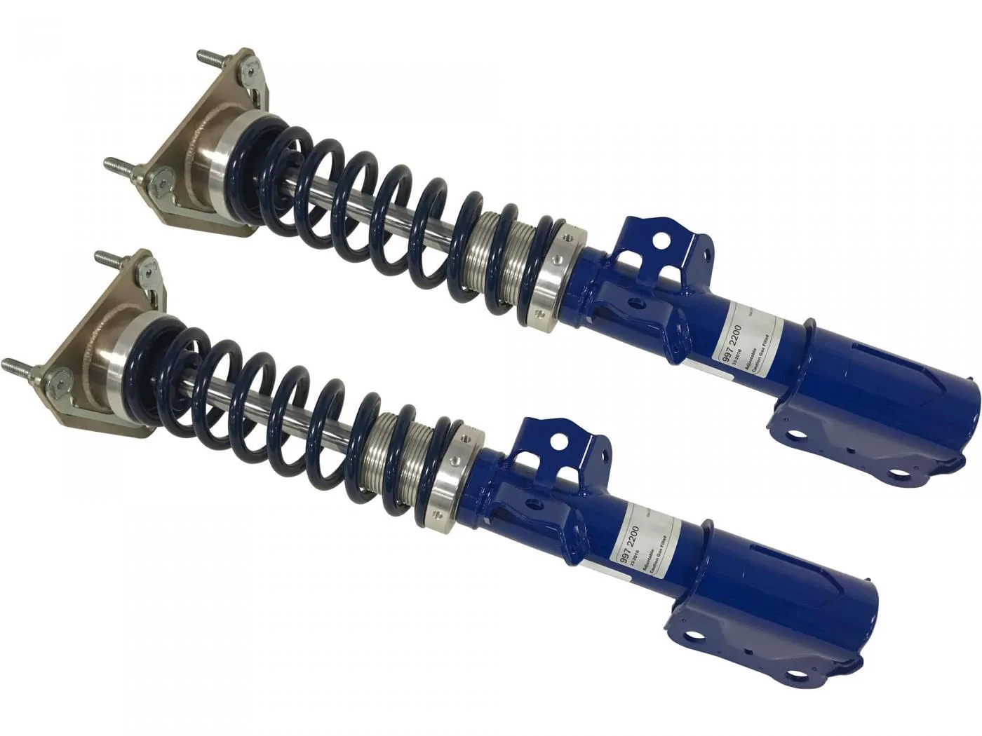

Yes, only rebound adjustable. This is a very high quality damper engineered especially for the S550, not a universal kit. They can handle up to a 450lb/in wheel rate.
Furthermore, you have your choice of rates for the front anywhere from 150 to 450 lb/in for spring rates.

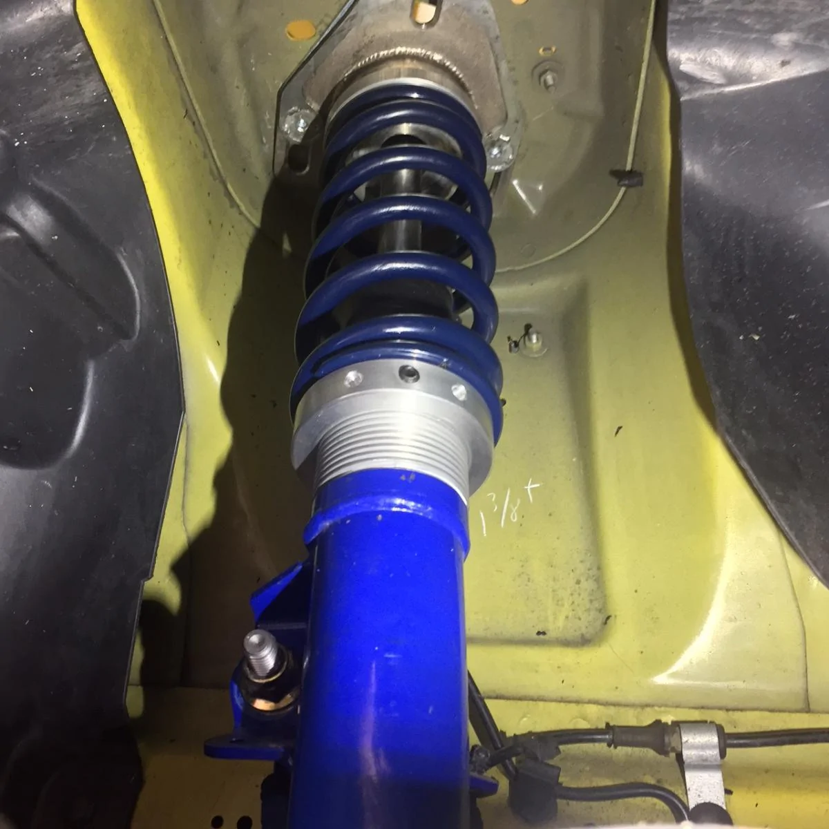

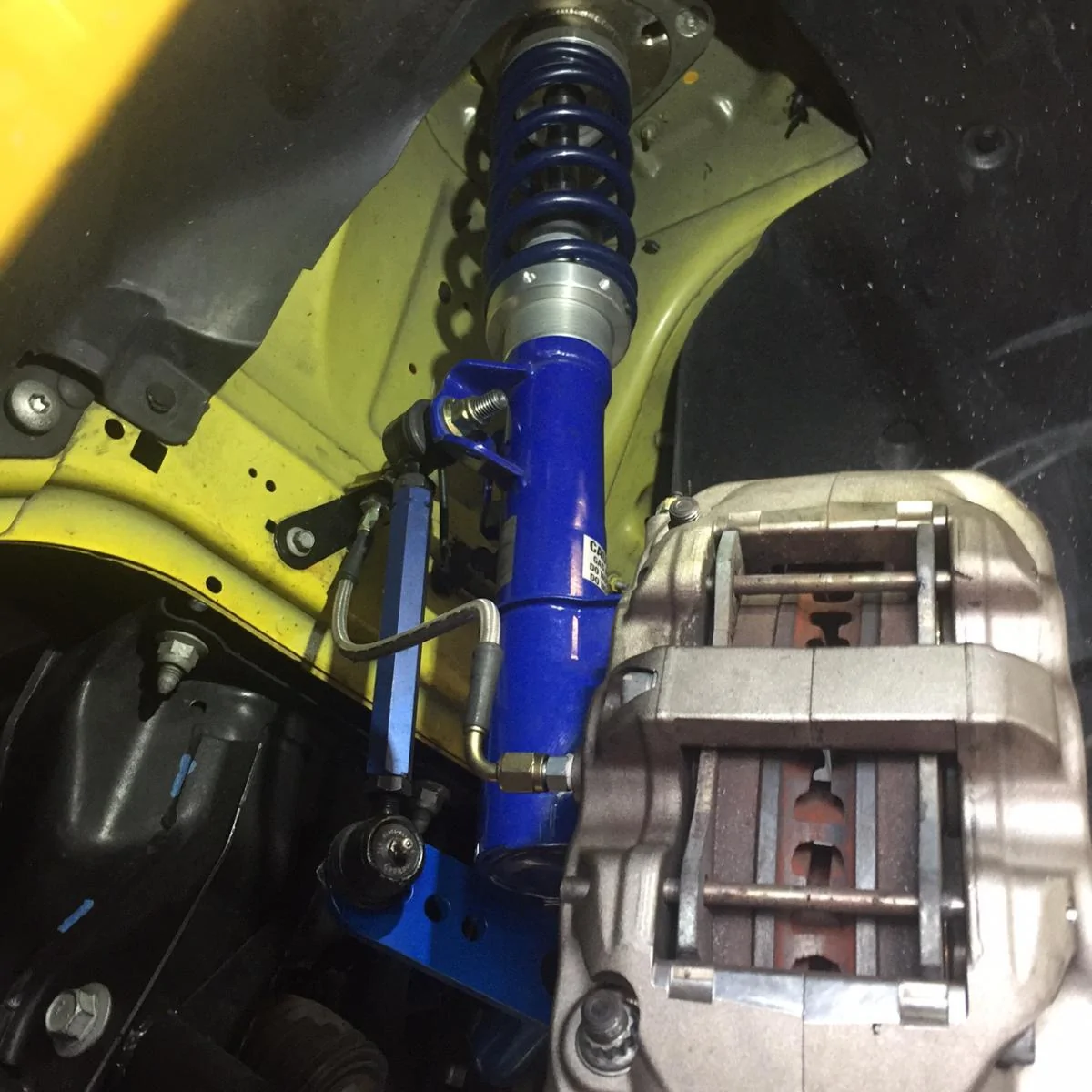

In action on 2016 S550 20 Race car
