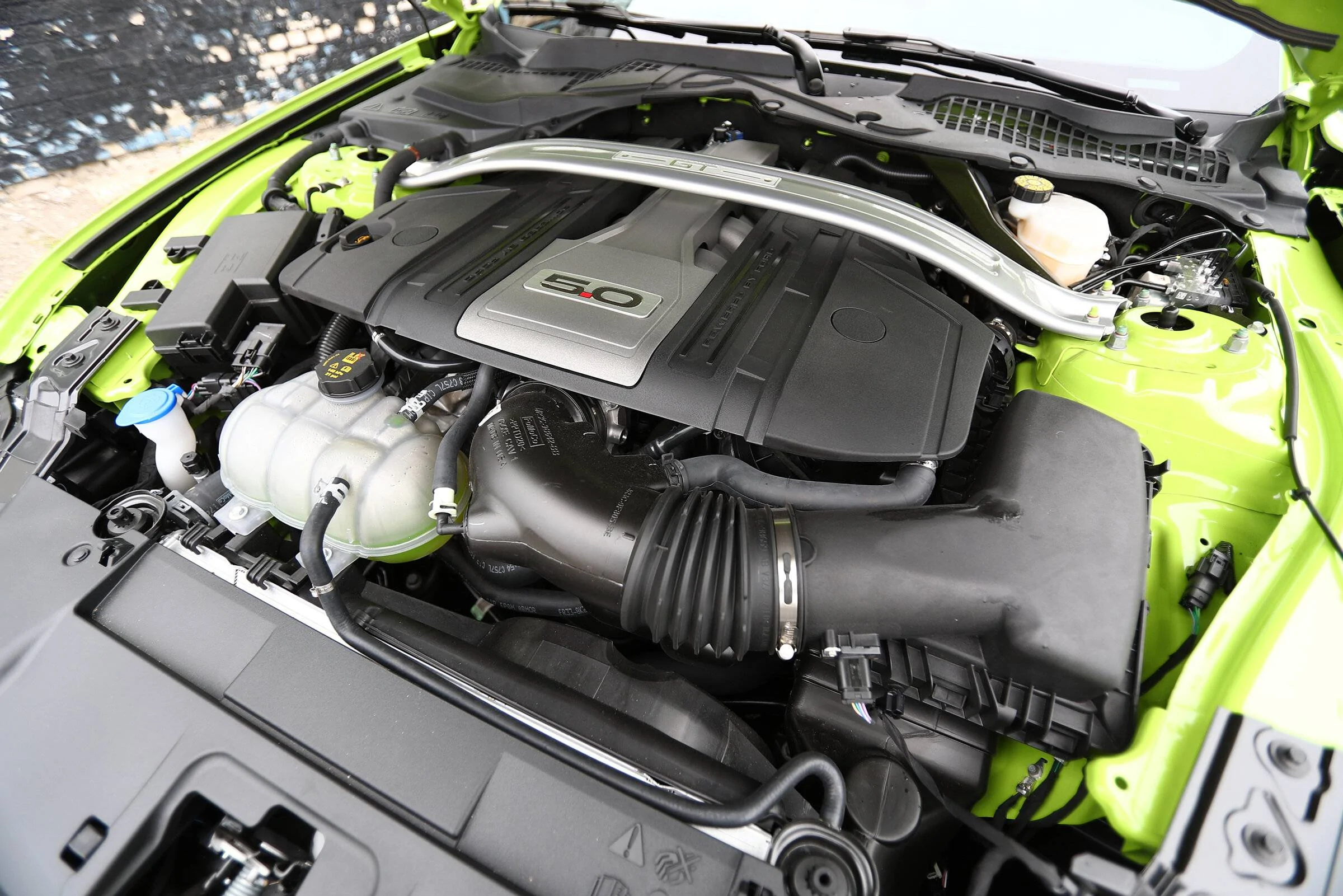

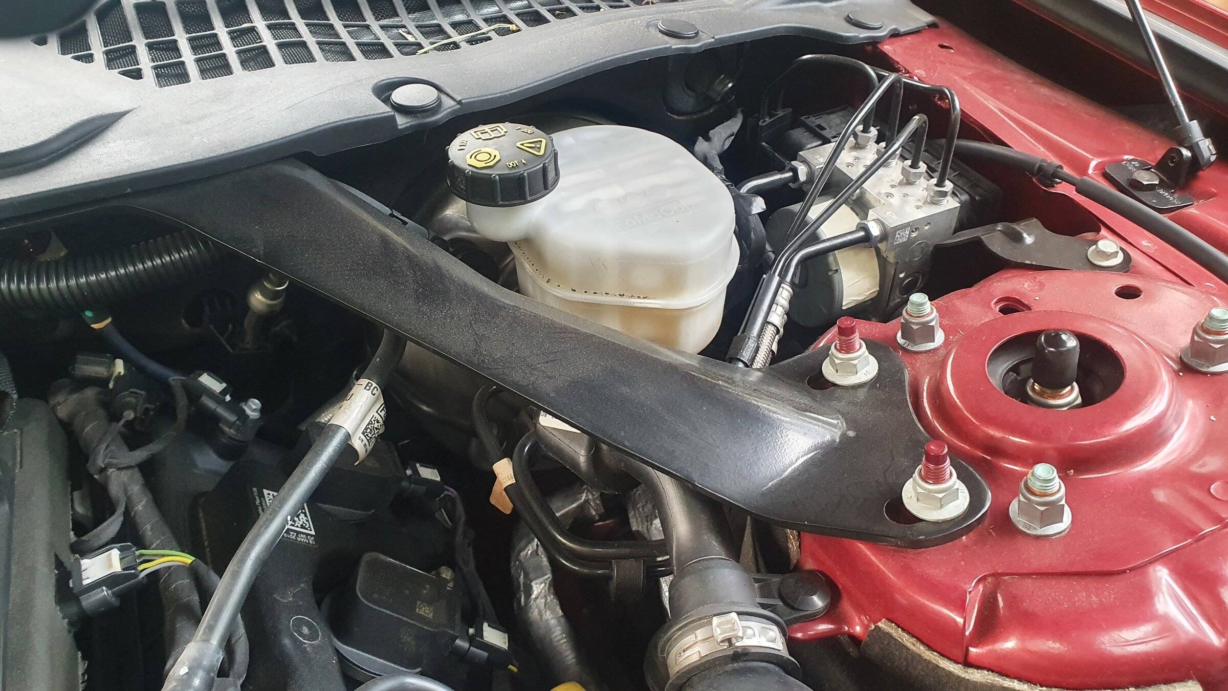

Hey guys/gals!
Just received my steeda strut brace. Like a complete noob I forgot I had the steel cowl brace thingy (EUR GT - comes standard with performance pack, without the main brace).
Steed is currently on holiday.. cant reach them.
Anyone know if i can fit the brace on top of the cowl, and if so, does that change the torque spec for the bolts?

My first thought it yes because in the US the PP comes with a strut brace on top of the cowl brace.
I just did a google search and found their installation video where they talk about what to do different PP vs non-PP.

Hey man! Yeah my bad.. i saw that video, but noticed it was on a car without the cowl.. And completely missed the part where he mentions the spacers..
Ill give it a go.. been searching and saw on another forum that the steeda brace doesn't fit the PP models.. and started getting sad cuz i just got it back custom painted hahaha
Thanks a bunch buddy!

That seems odd. I was just looking at their print instructions too and line five says what to do different with a PP car.

Yep i also just downloaded that hehe... I was in a rush to install before going to work.. and was googling 'steeda strut tower brace and performance pack' and couldn't really find anything showing both of them installed together :p thanks again mate! Guess ill install later this evening when i get back home!
