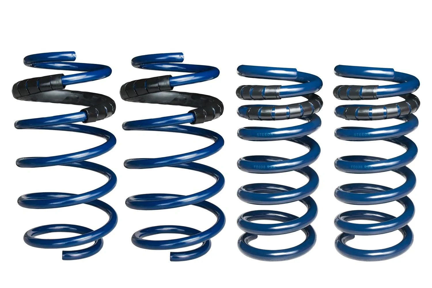

Steeda Progressive Springs Tech Info
Progressive rate springs, as the name suggests, have a constantly increasing spring rate throughout their range of deflection. This means that the distance between coils progressively increases from one end to the other, allowing for more weight variability. Progressive Springs optimize the center of gravity and suspension geometry creating a huge improvement in handling with a noticeable reduction in nosedive, launch squat, and body roll, while still maintaining an outstanding ride quality for daily driving. It may help to think of them as "load-compensating," in that the more weight you add to the vehicle (passengers, cargo, etc) the springs will progressively compress less so that they don't end up fully compressed. Generally speaking, these are the best of both worlds, providing an exceptional improvement in handling and assistance in roll-control, without compromising ride comfort. With these improvements over linear springs, it's understood why they cost more.
