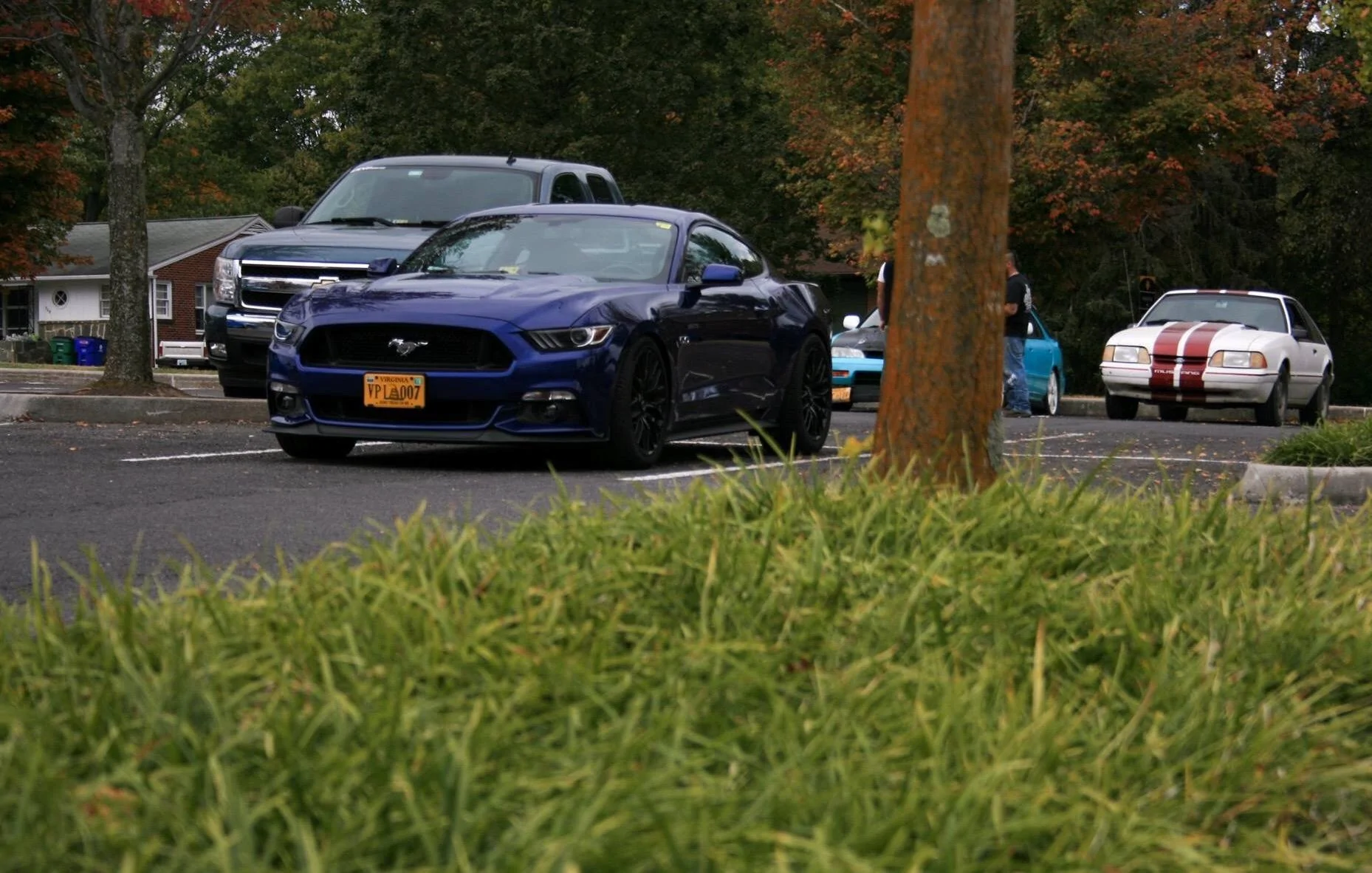

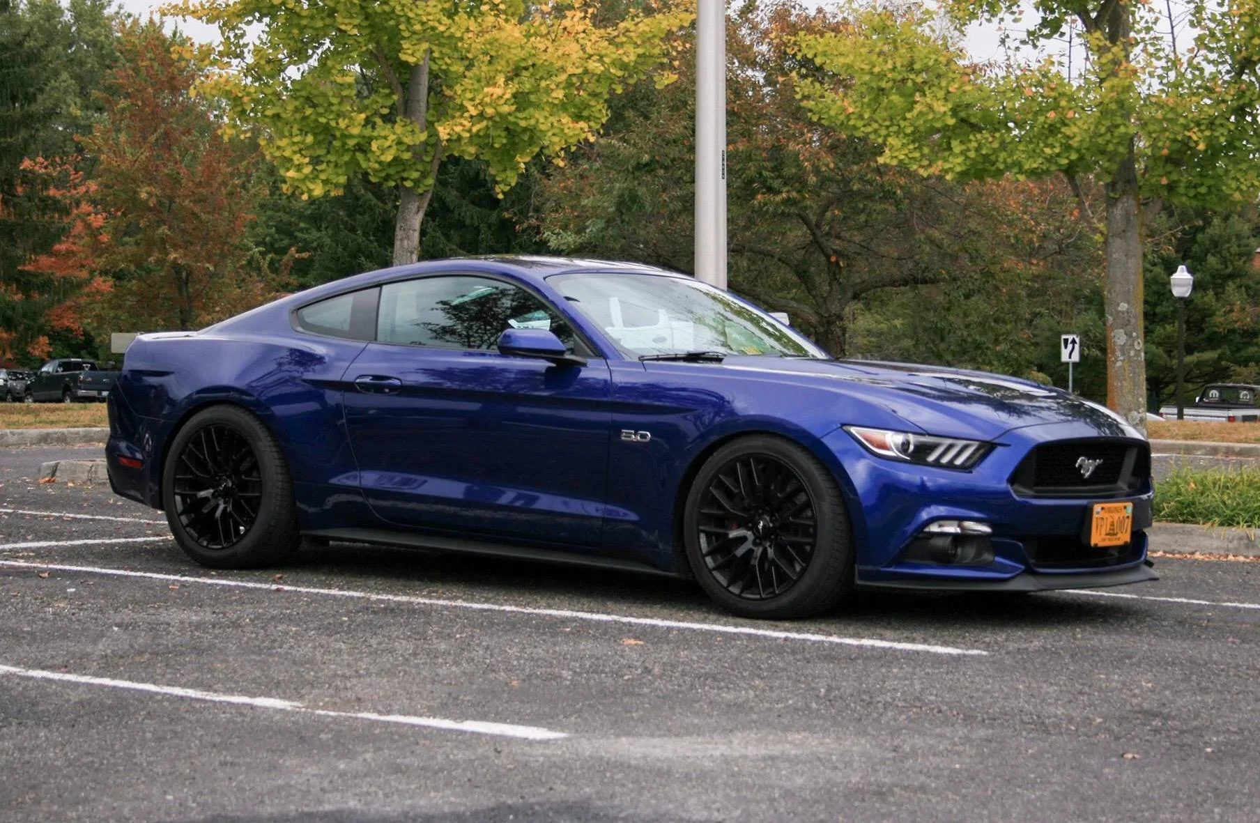

Okay I honestly haven't taken any pics of my car since I got it which is insane these days but weirdly i just wasn't compelled to until now. That said and at the risk of looking like a twat I just saw these pics taken by someone else at the Virginia Tech show last weekend and damn if it doesn't look just about right even though most of the time just walking up it still seems to me like it's raked. I guess tomorrow I need to take some measurements and if I have to eat crow at least I'll know the car is right.
However, pretty soon I'll be trying a square setup with 275s on all four corners with 10" wheels and 40mm offset which will change things a bit, basically the same on the rear but more tire height on the front so it'll look more tucked.
