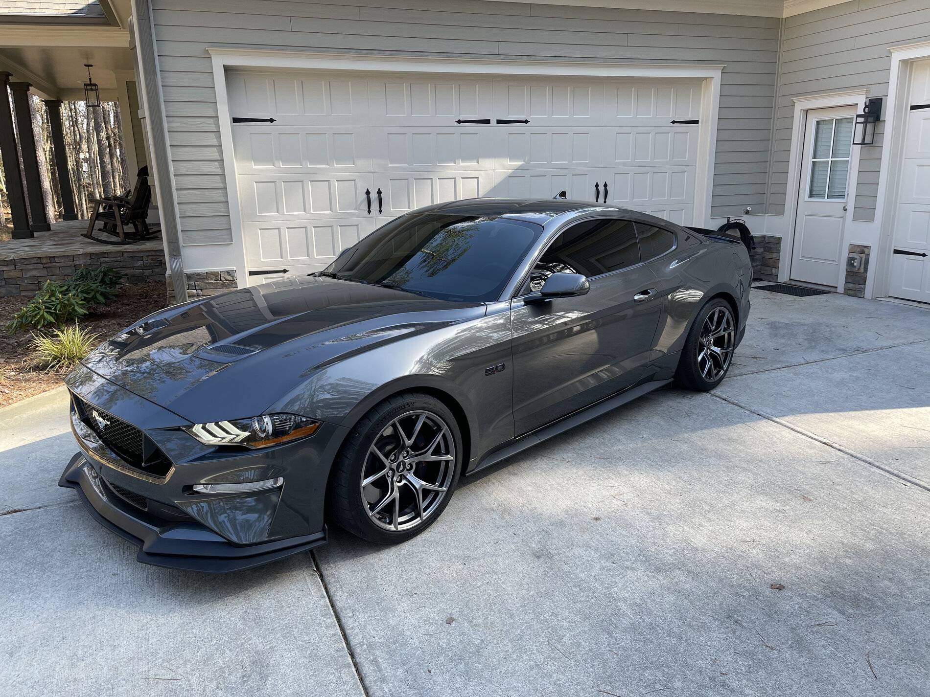

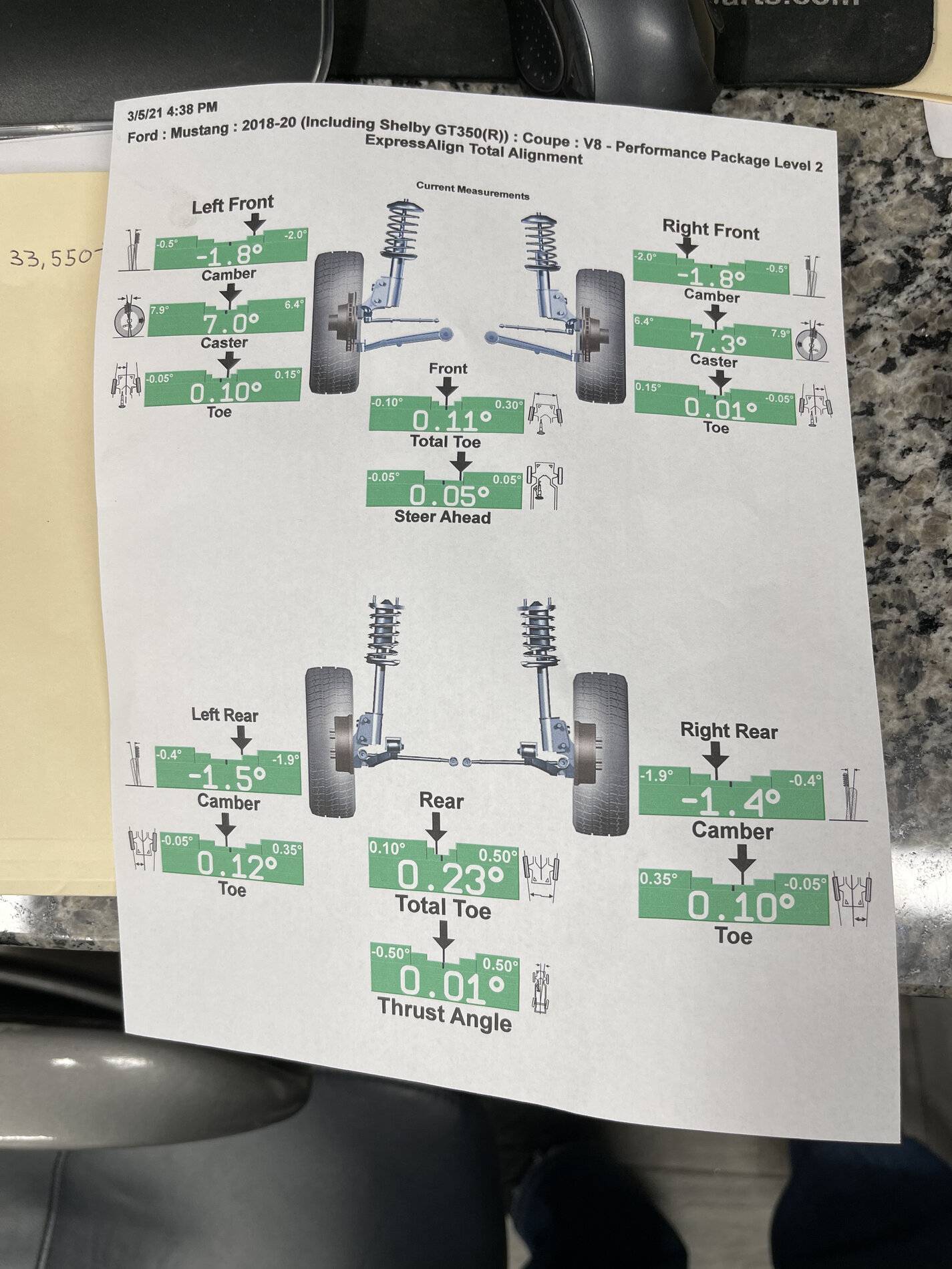

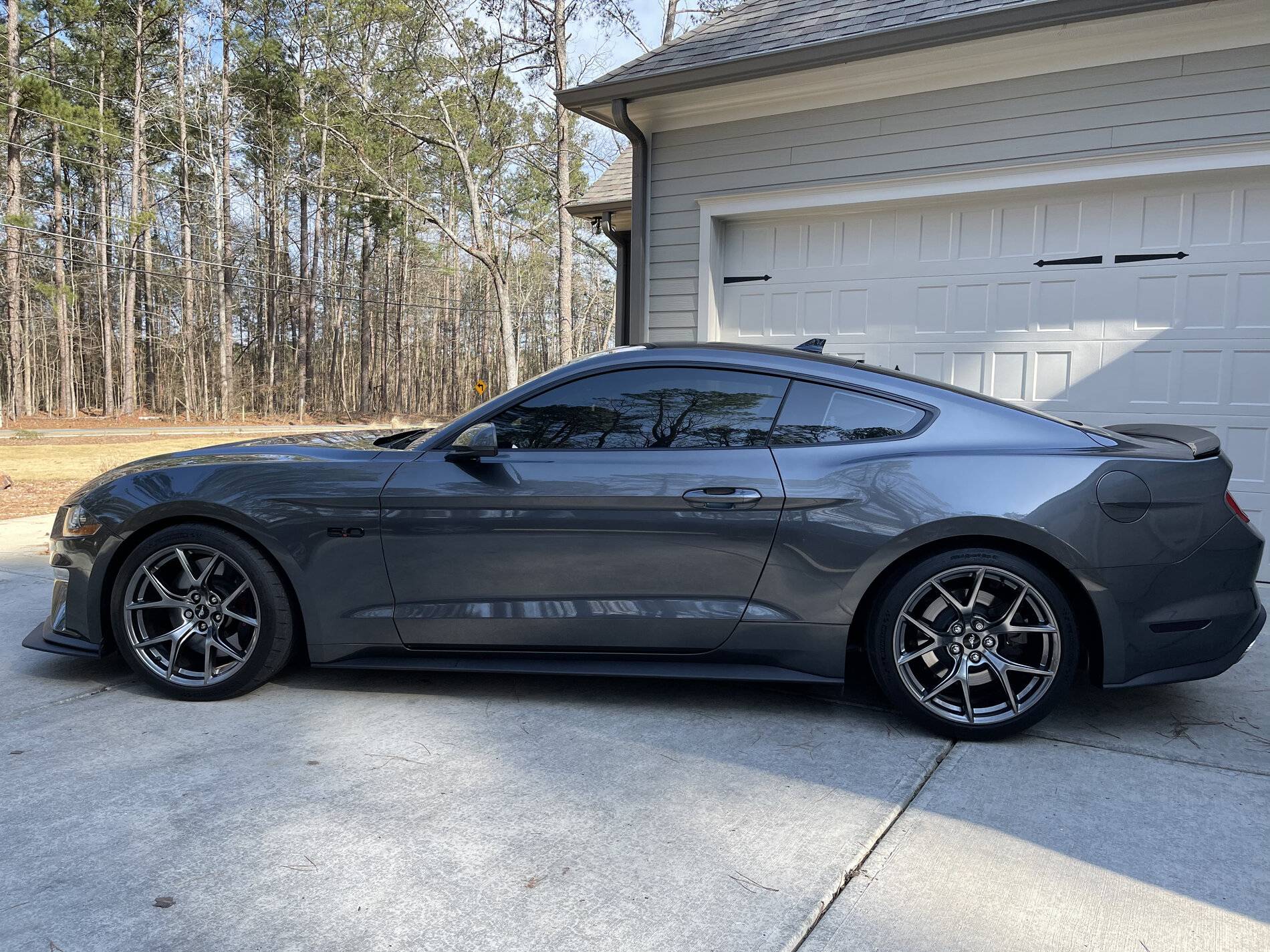

I added the Steeda springs and Maximum Motorsports camber plates about two weeks ago on my 2020 PP2. I love the new stance and the car feels more balanced all around.

Are these the sport or the dual rate springs?
