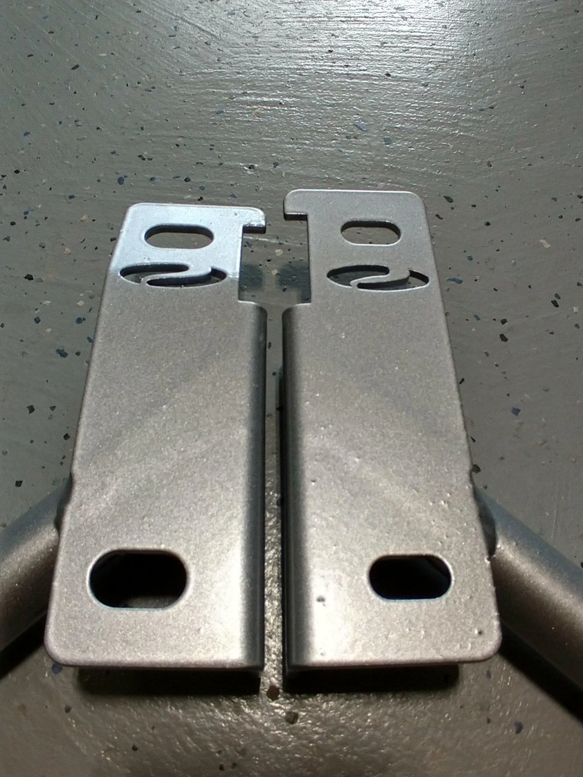

Trying for some late night garage time, thought I would have an hour or less installing Steeda IRS braces, I've been reading nothing but positive reviews and couldn't wait to get them in. My mission hit a snag however. I started on the driver side, and after getting under there and seeing what I was up against, I thought this would take about 20 minutes. Joke is on me apparently. After attempting to follow the very simple, easy to follow instructions, there was no way to get both front hex bolts in at the same time. Surely I just had it misaligned or something. Twenty minutes and all the sweat I had left in me, I quit for the night, defeated. Back in the house, I reviewed the instructions again, looked at diagrams, read a hundred reviews looking for anything that hinted at similar problems. I found nothing. I couldn't take it, had to go back to the garage and see if after a break I would see what I was doing wrong and laugh. Nope. I laid the two braces side by side, and there it was. Looking at both sides of the car, it can't be intentional. The slots on the driver's side brace are much smaller than the passenger side, just enough that I can't bolt it on. Anyone else experience this? Now it's either the hassle if returning or drilling myself, I assume...

Yep, same thing. Just grind about an â…›" from each of the too-small slots and you'll be good. I was too impatient and wanted them on the car, didn't want the hassle of repacking, shipping, and waiting. I probably should have called Steeda where I bought mine directly from, maybe the would have sent a nice coupon or something:dance:

Perhaps the logo should be rotated 90° so that more metal is left at the section where these bends are showing up . . .
