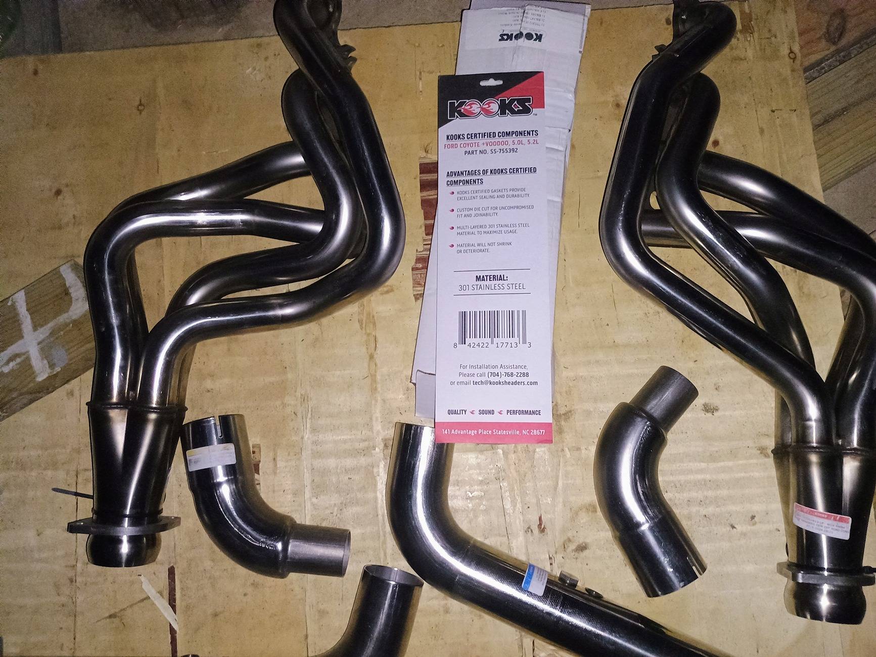

Hi I know this doesn't really have anything to do with your post but I have a question on a similar topic. I have a set of brand new kooks off Rd headers with connectors gaskets everything to install. I acquired them on a trade n want to sell them. What is a reasonable price that I should ask for them or how much are they worth
