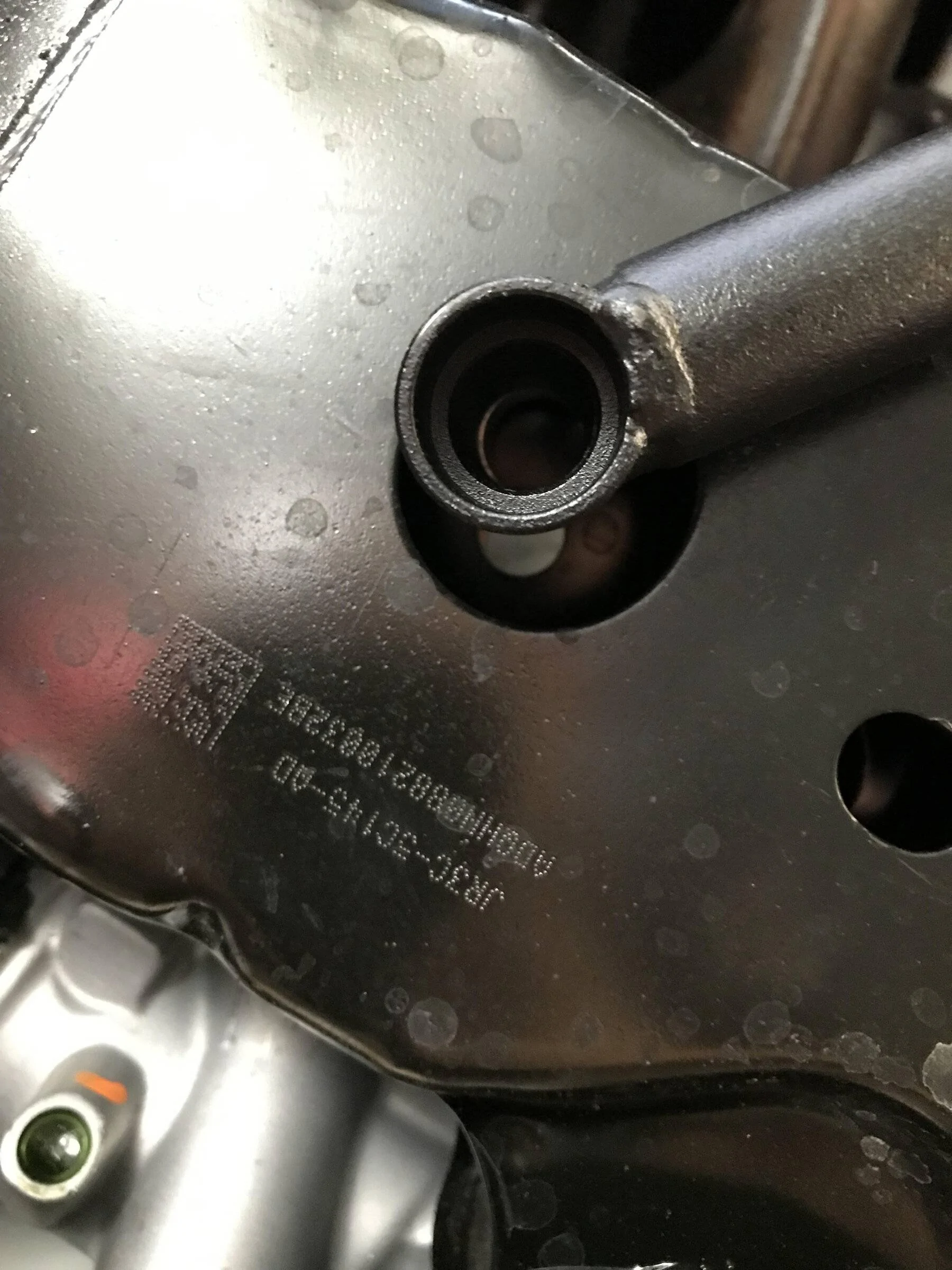

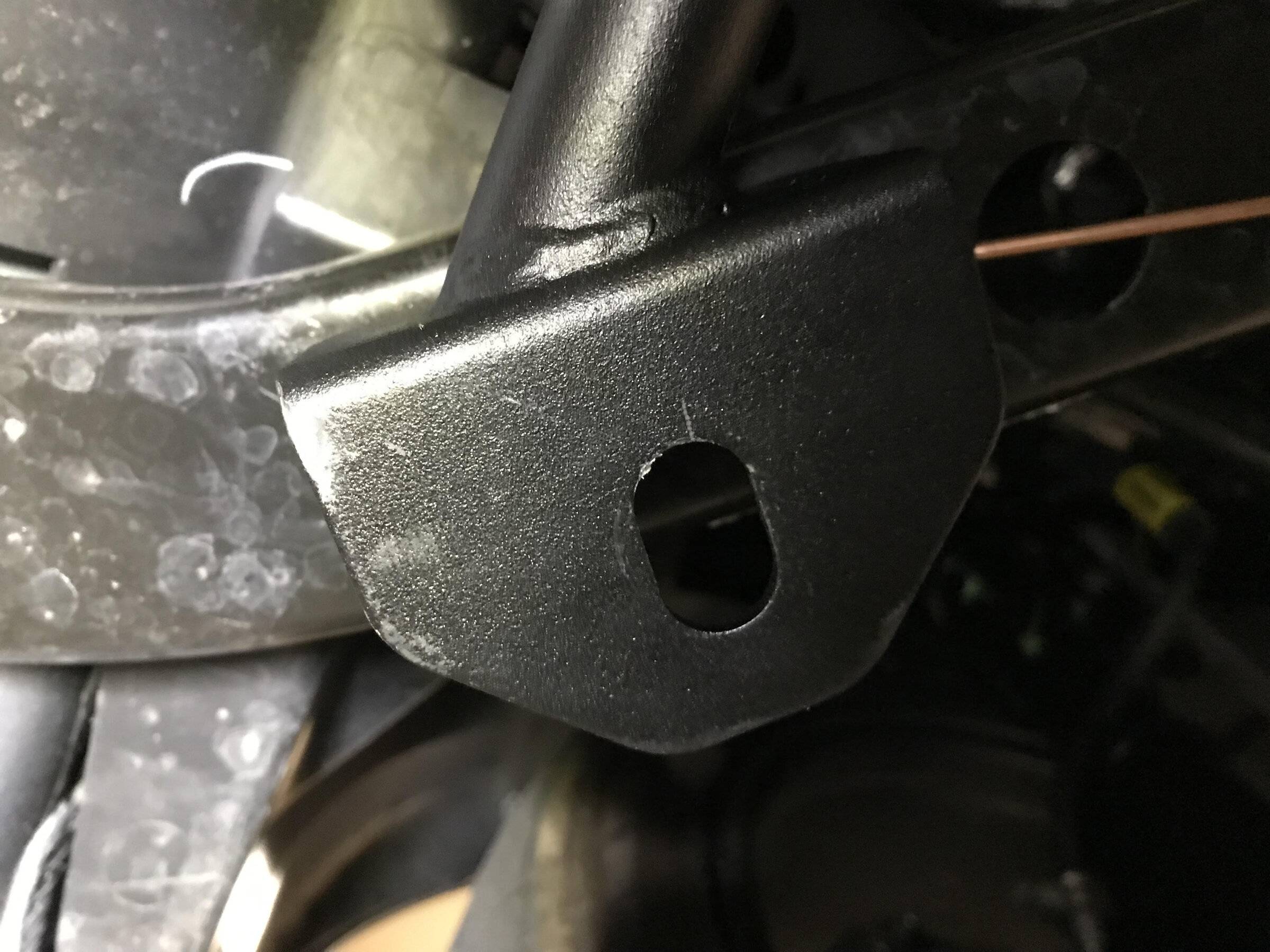

Looking for some tips to help install the Steeda G trac brace onto my 2021.
I've has some input from Steeda to date, but I still can't manage to get it to install. My problem is that no matter how I line it up or start the bolts (tried all four corners) the last two do not line up. I have tried (and failed) to pull the brace into place, but it is so stiff I can't do that and slot in the bolts. I did tape the spacers onto the front mounts to prevent them from falling into the chassis. Attaching pictures of where I start in the back (first) and when I start in the front (second). While it doesn't appear to be much to get these to line up, there is just no play. Frustrated!

Thanks guys. I recall trying that before, but the rear jams up against the frame (second pic) to the point where I can't screw in the front mounts enough to secure them. That said, I'll try again with a fresh look at it.
