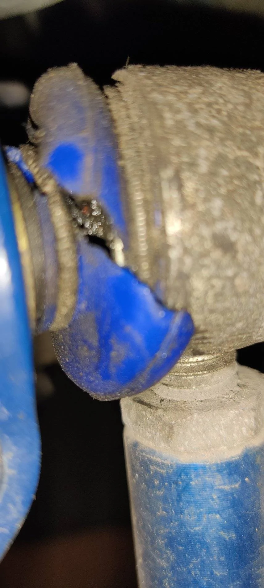

Just curious if anyone else has had this happen. I grabbed a zerk fitting and was putting grease in today when I noticed it.
I've had a clunk coming from my suspension for months that I haven't been able to figure out. Dunno if this is it or not, but I know its bad :crackup:

I'd be optimistic you found your clunk.
Do you think it was making contact with anything?

Hi Jon,
Based on the email exchange I saw - it looks like you are in contact with our team, is that correct?
Let me know if I can help assist with anything as we look into your pictures & our tech team has a chance to review.

There isn't anything around it that would touch it. Is this something that just happens with these? I've only done 5 track days since I installed them last year.
Edit: Hey TJ, yeah I shot you guys an email.
Is this normal after a handful of track days, akin to a consumable like rotors etc? I'm still fairly green when it comes to track stuff.

No, it's not normal - we have these on several of our track cars & they hold up to the track use.
Our team will be in contact shortly.

No this is not normal.
