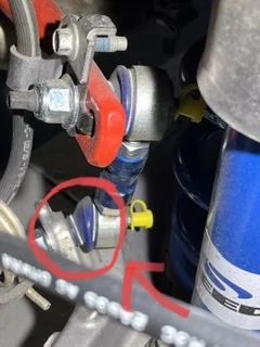

does anyone know what size are the grease fittings on the Steeda endlinks?
@Steeda Tech JohnC
and is the normal?

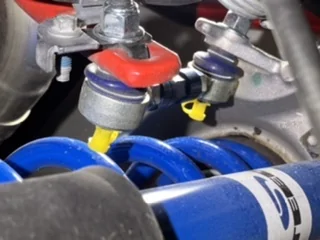

this is what the other side looks like

Should be 1/4"‑28 SAE‑LT

Confirmed that the thread on them is ¼-28
