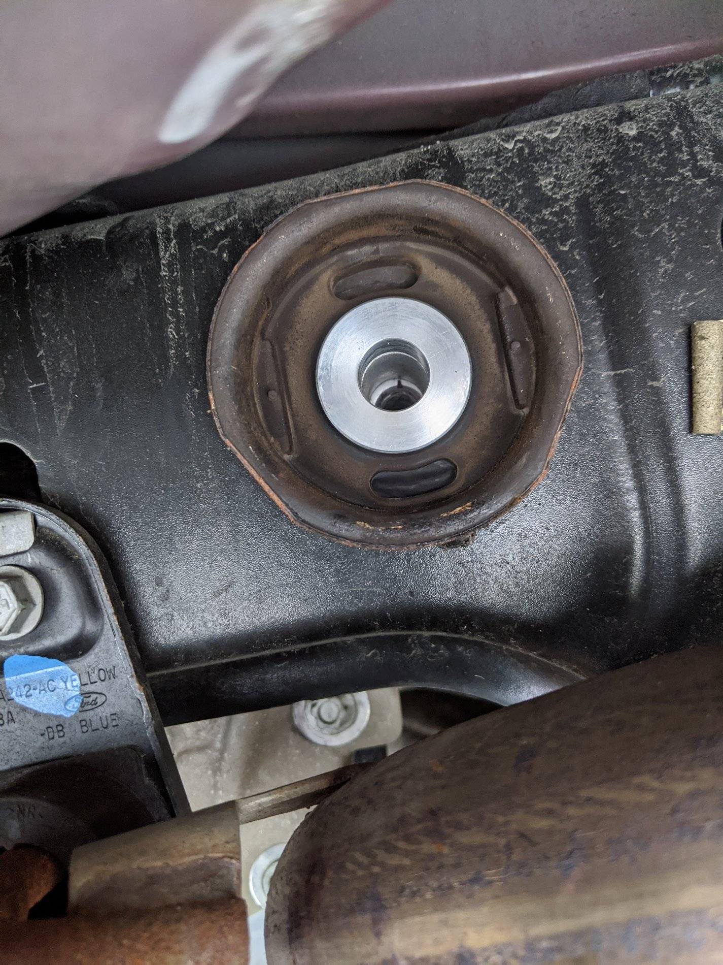

Anyone had this problem ? My car had damper on the rear passenger side bolt - removed per Steeda's instruction but the bushing underneath has a different pattern than the bushing support.... What do I do - just installed it over it anyway ?

Steeda has made it very clear that it is very important for the voids to match the bushing. They even patented the voids!
I would make sure they provide you an updated design. Surely they will not suggest installing as is - as I have screenshots with them stating how important the voids are.

Hello KZ,
Let me look into this for you - I have an email into our tech team for further clarification & feedback.
We appreciate you taking the time to bring this to our attention - we'll be in touch as soon as I hear back.

You definitely need to match the lugs in the existing bushing. That's how these work so well - they fill in the areas where there are no lugs and go around the lugs themselves. You may have to have one modified on a milling machine or something so it matches that particular side (just my guess) but lets see what the Steeda folks come up with.
