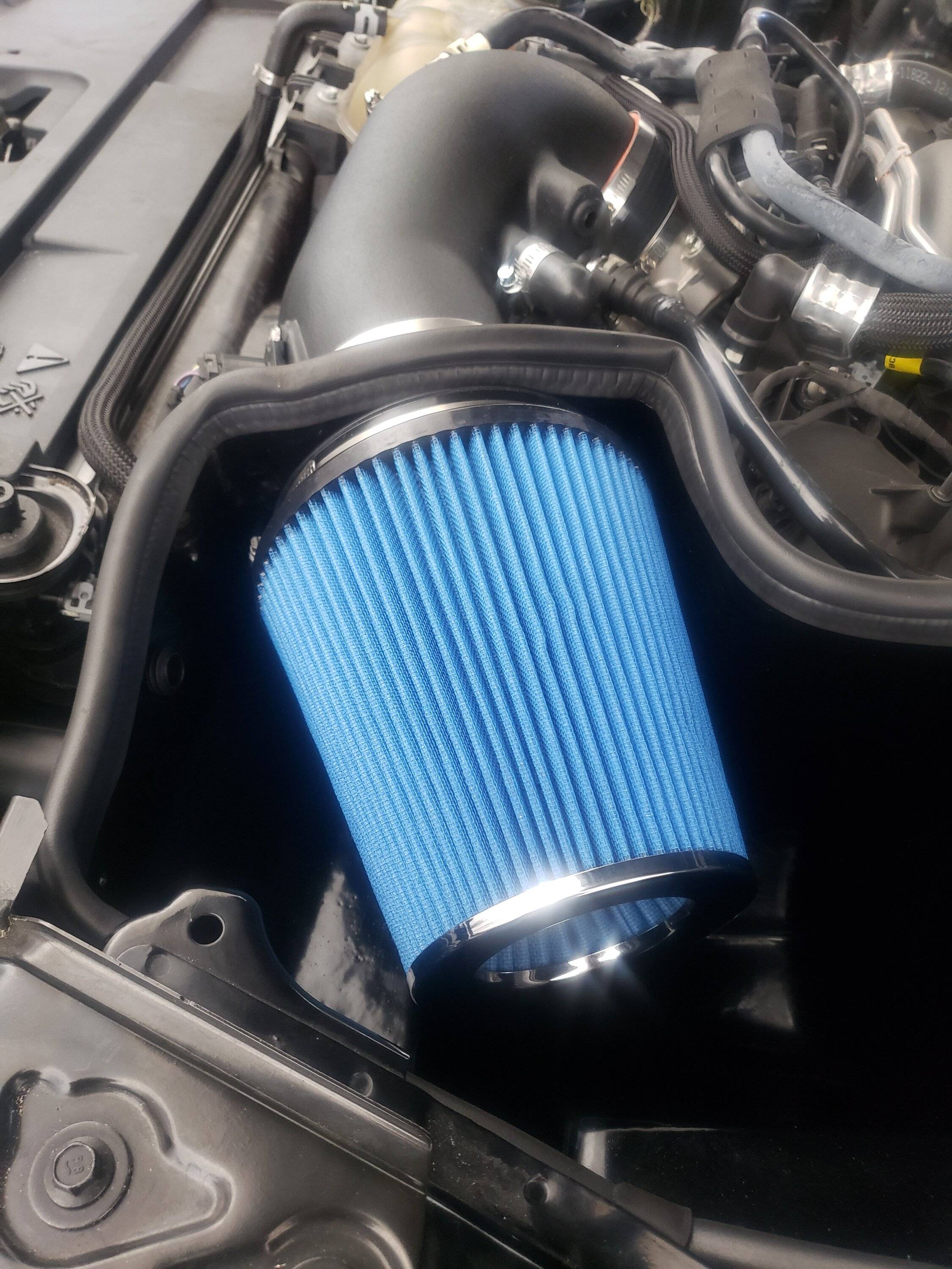

Recently installed a steeda cai .....lund tuned and the idle bounces from 700rpm to 1000rpms every 15 seconds. I verified that there are no leaks after the maf (sprayed and smoke tested) . Is this normal for an cai to do this?

I had a JLT CAI a while back that did the same thing even after a tune, I ended up saying f*** it, stock airbox is plenty fine with a high airflow filter, keeps IAT hella down too.

Which Steeda CAI? They have a couple.

I'm about to do that aswell they said its "fan wash" but on cold starts there is no fans lol
Open box proflow

Yeah IDK about that specific intake. I can tell you the MAF signal on the closed box pro intake isn’t very stable but thats a different design.

I would try unplugging the battery for several minutes, then cold-start the car, let it run for 3 mins. Turn if off for 3 mins, start it again for 3 mins.
I wouldn't be surprised if it clears up after some driving around.

I did reset the KAM. memory and still the same

You should speak to your tuner - we have sold many open-air intakes & tunes & we have not had the issues you have described.
Let us know what they say.
